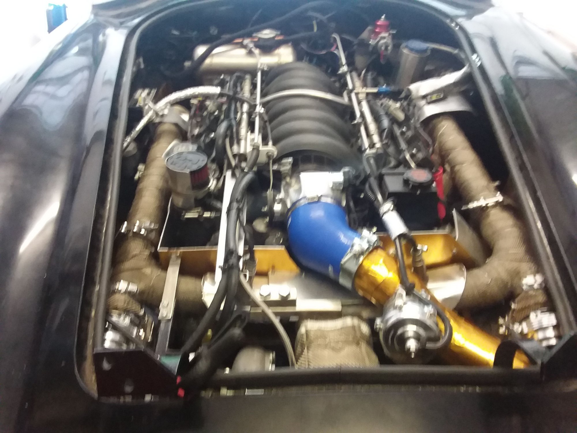

Old Feb 16, 2023 | 11:39 AM

Very nice, I've always liked those. I would have thought they'd have ample room for a water pump in there. What accessory spacing do you run on your engine? Truck, F-body, or Corvette?

Home made....

Oh wow! Guess I can see why you need something compact. Looks like you have Corvette spacing, so you have the shortest setup already. I'd just buy another of the same pump you have, unless cooling is inadequate. Might want to make a post in the swaps/conversions section in regards to whether anyone has used the Davies/Craig pump.

Times 2 on the wow. But with the power steering pump up top it looks like 2002 F-body FEA? Corvette FEA would have the alternator up top. On my latest LS swap I used a 2002 Camaro water pump. Brand new and it leaked. Never had that happen before. Took it off and on the inlet/outlet holes of the water pump the mating surfaces had some machining grooves so the o-ring gaskets wouldn't seal. I used a real fine file to make the grooves go away. Put it back on and no issues.

All I had when I bought the engine was a PS pump, alternator no brackets. So I got some thick aluminium plate so that the alternator and PS pump were lined up with the stock pulley grooves and made it so that it all fitted in the engine bay and just bought a 6 rib belt the right length. Took a lot of messing around etc. The turbo install complicated things.....
