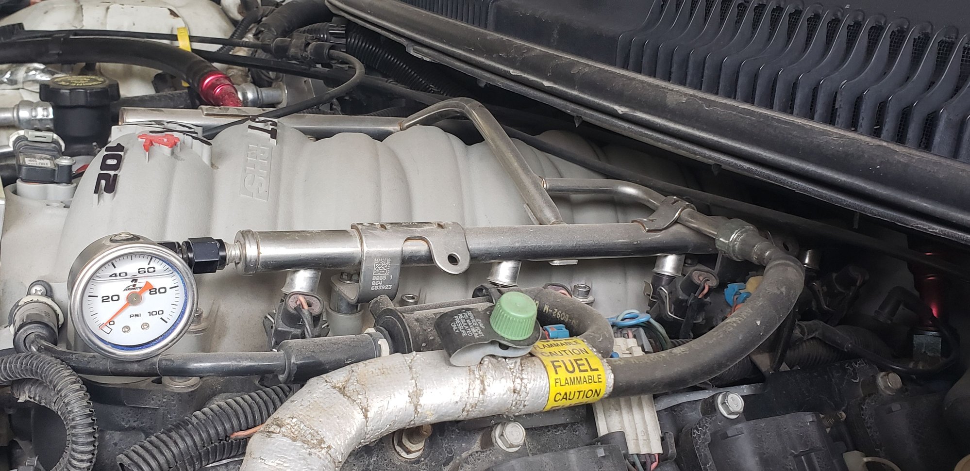

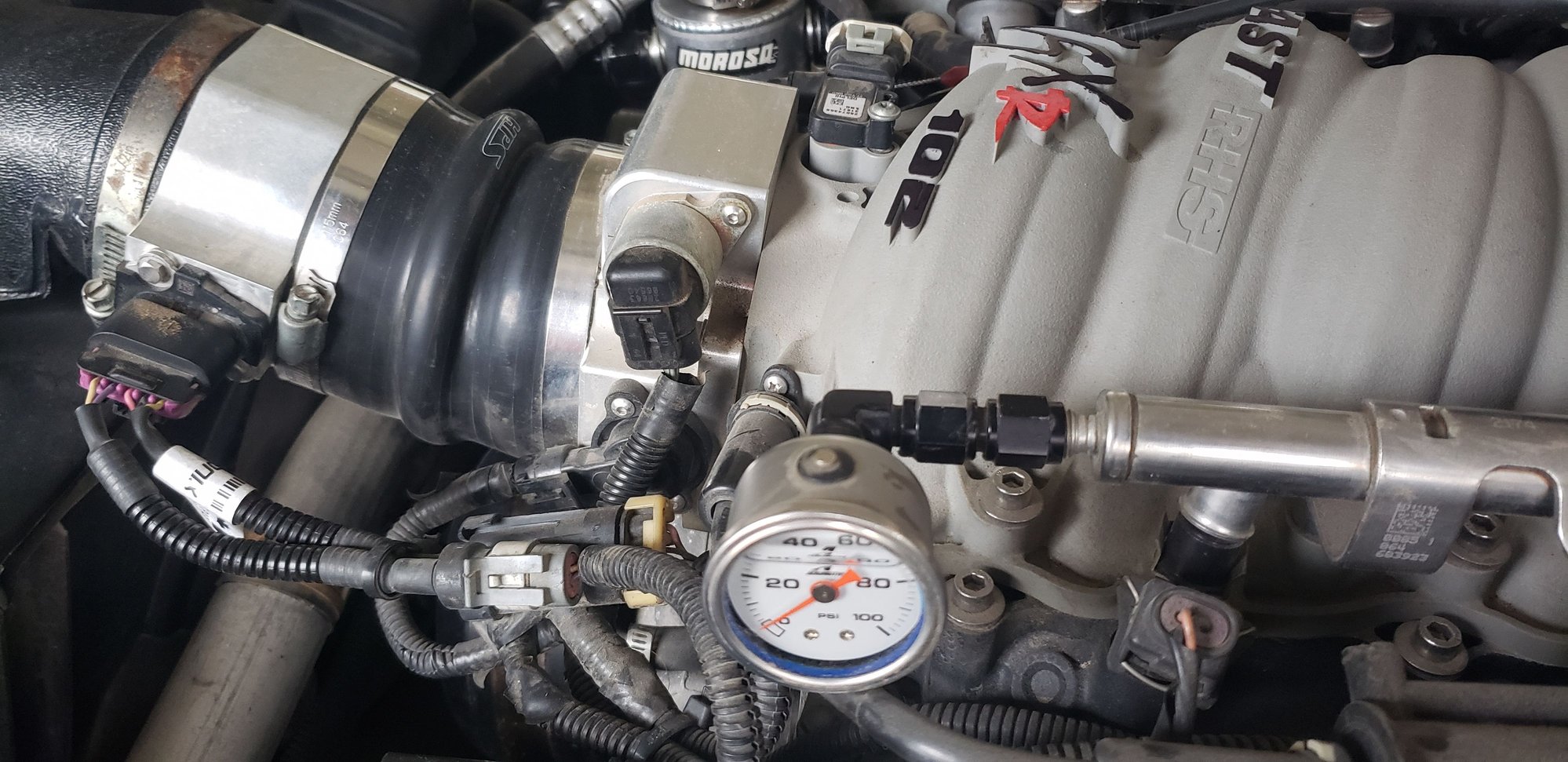

01 camaroSSTx
can I get you to send me a better photo of this part on your engine? I'd like to see your fuel rail setup from the LH fender close up.

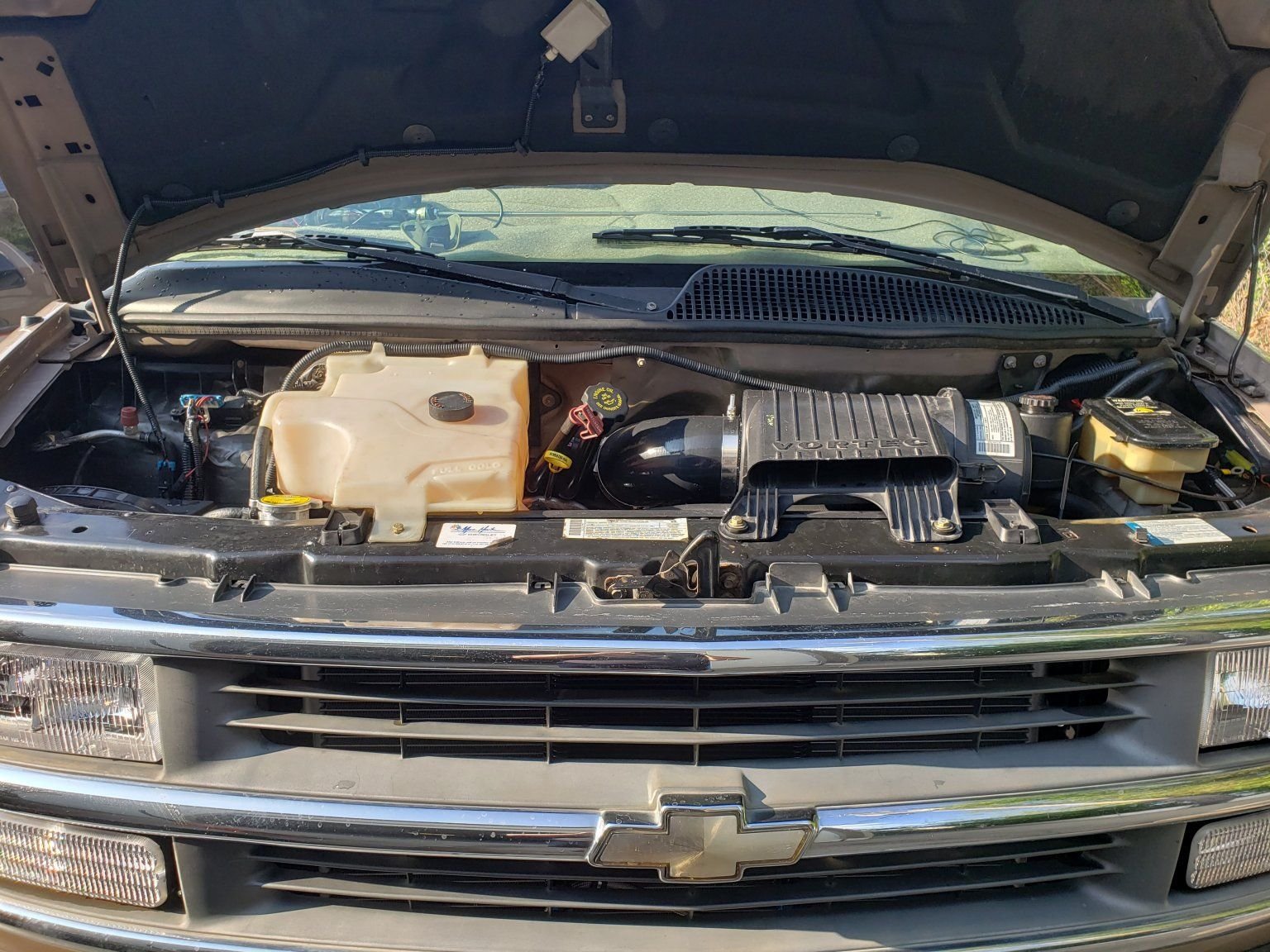

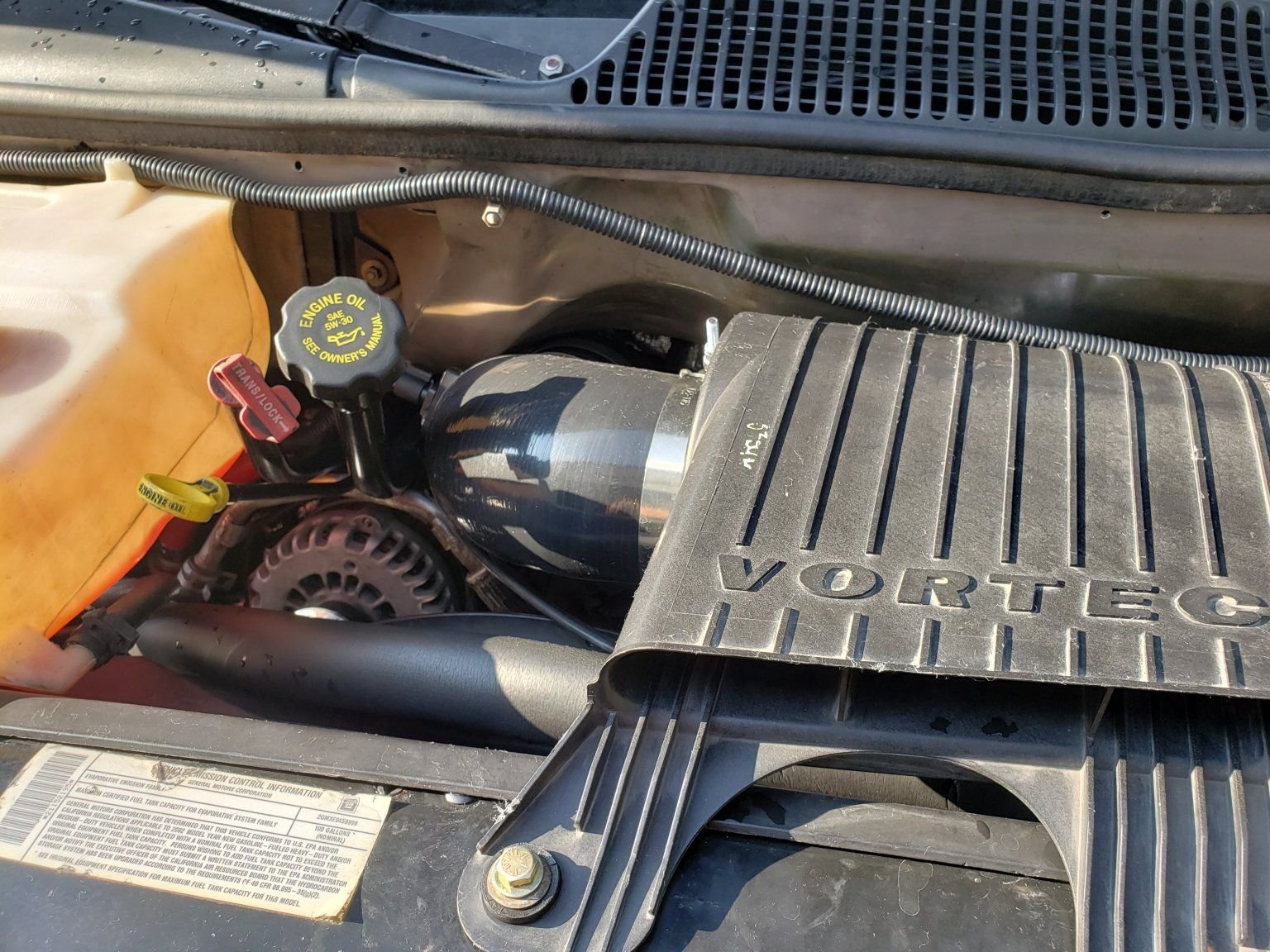

FWIW, this is the 100mm MAF on my 383 SBC.

[QUOTE=rayrat;20481520]01 camaroSSTx

rayrat's Avatar
Joined: Mar 2008
Posts: 55
Thanks for the pics Conroe. Is that a FAST fuel manifold or who made it? Thanks again. (Blanket, TX)
Old Jan 30, 2023 | 10:04 PM
sunch01z28's Avatar
Joined: Jan 2023
Posts: 4
rayrat if youre talking about the fuel rail it is a FAST brand billet fuel rail
