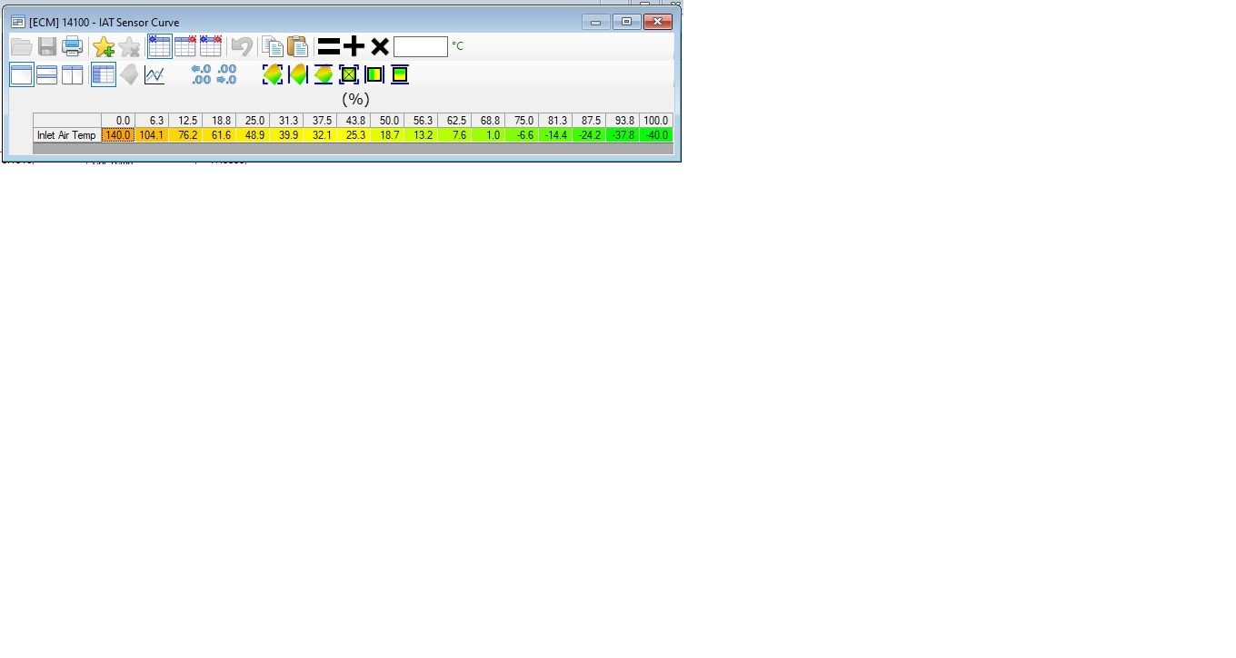

I found the Lingenfelter 100mm MAF transfer function to be very close on the two vehicles I am running with that MAF.
https://www.lingenfelter.com/PDFdown...05-2006MAF.pdf
You also need to plug in this IAT calibration.
