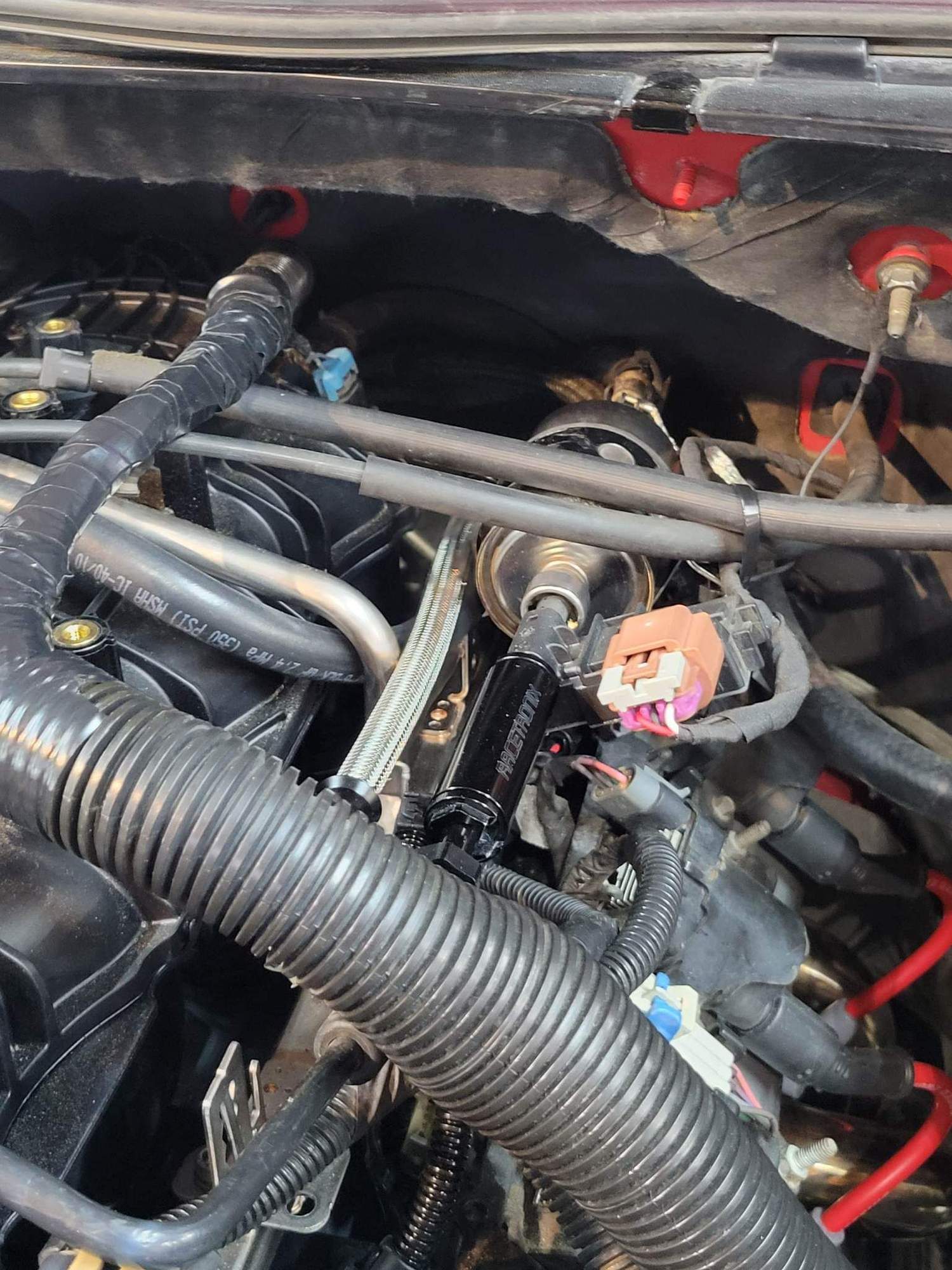

if your truck had return line from manifold u switch to TBSS has no return or regulator you get a corvette style filter regulator 1 line to motor 2 lines out to tank

As mentioned above the Vette filter/regulator is required for older return style fuel system. I remote mounted mine up by the IM so the factory fuel lines plugged right in. I would recommend finding a OEM unit if possible. I tried a 40.00 unit and it leaked. Could be my luck.

Yes you should do all lines over get new push loc hose they say to put filter/regulator near tank watch this vid
