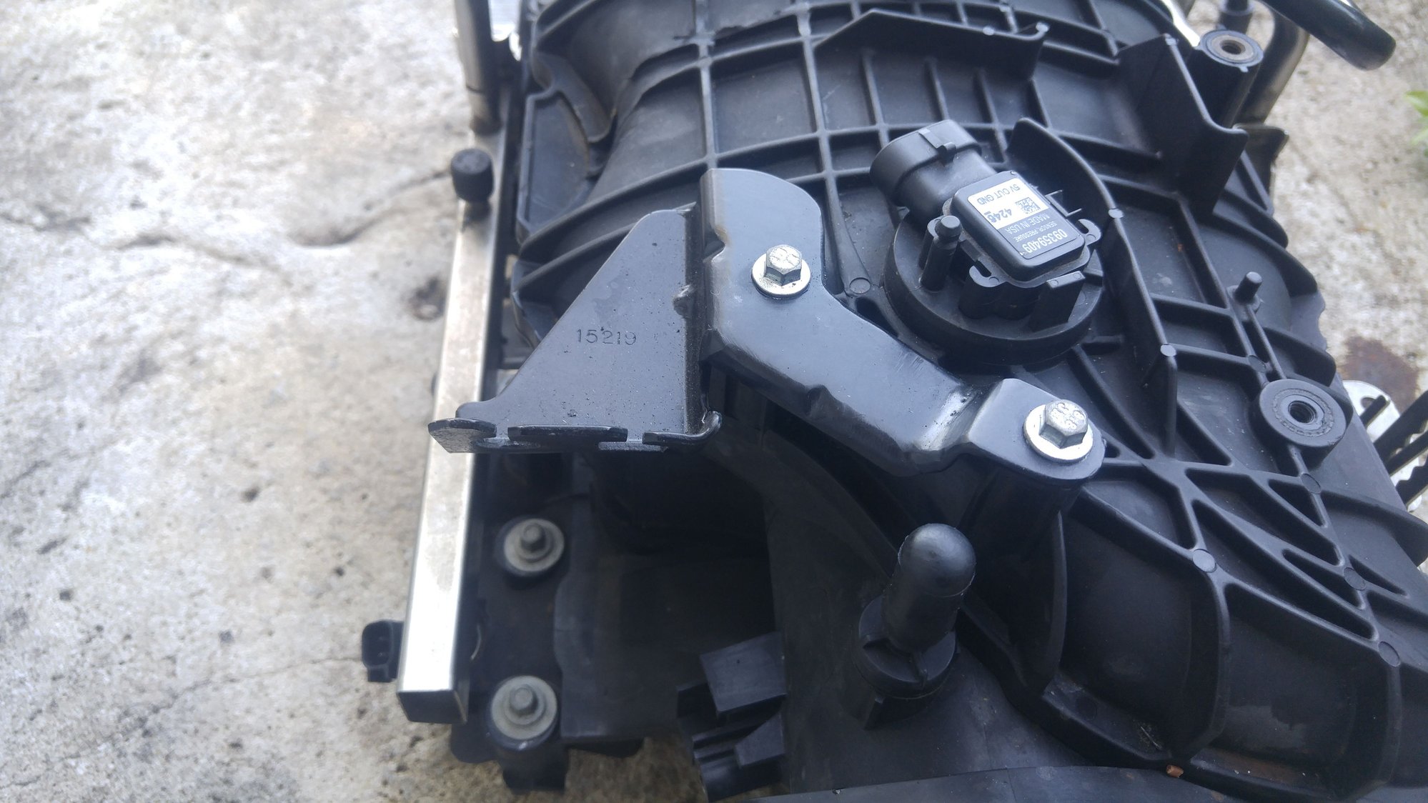

But for what it's worth. The first two of these intakes I used I built the throttle cable bracket out of two stock brackets.

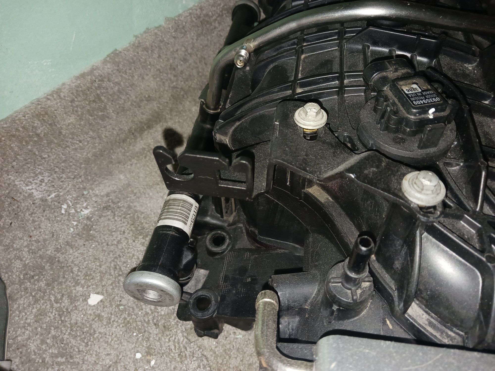

The one I have ready for the engine I'm building now (the third one I've used) I bought an Amazon special, still needed to cut and weld it to get it to even bolt on.

HERE IS THE BRACKET I MADE BELOW
HERE IS THE AMAZON BRACKET
