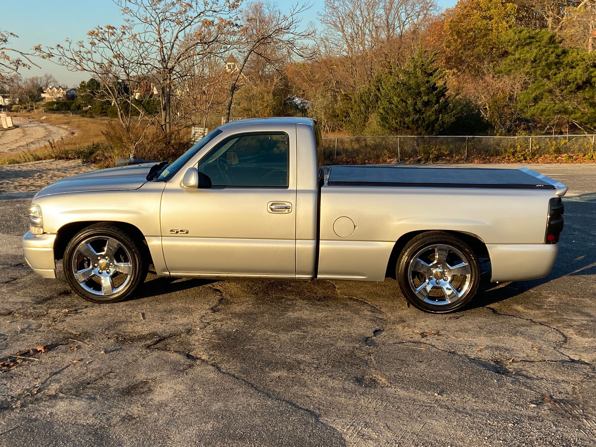

U have a beautiful truck keep them running this has 4.3 242k never touched lol
Old Feb 24, 2023 | 04:31 PM
kinglt-1's Avatar
Joined: Jul 2005
Posts: 5,898
Likes: 255
From: Ft. Wayne, IN
Looks great!!
Old Feb 25, 2023 | 06:29 AM
LS1Formulation's Avatar
Posts: 3,929
Likes: 1,160
From: Grand Rapids, Michigan
That is a sweet truck. Definitely deserves an LS swap!
