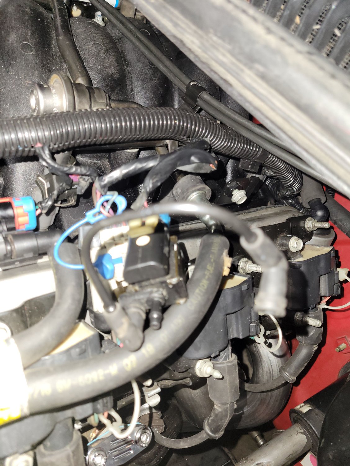

nobody? it bolts to a bracket just behind the fuel inlet and has 2 small hose out (1/4 inch?). its on a 2002 trans am, manual transmission

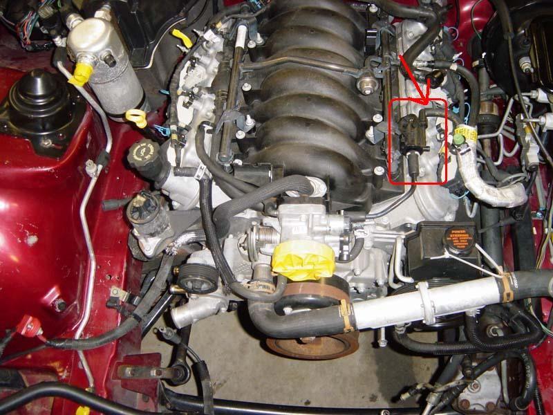

Purge valve solenoid.
One hose to intake, other hose to hardline next to fuel line on driver side fender

thank you, but that isnt it, this doo hickey sits behind the fuel input. and sits on a bracket on the intake. i dont think i see it on your picture

Looks like AIR solenoid and hose. I see headers so Im guessing its been deleted

ah, that makes sense. thank you. how do you guys cap off these connectors that are no longer used, so dirt and grime dont get in there?

one of the lines goes to the bung on the back of the intake.....is the AIR system deleted ?
yes, and if this is not to be used should i cap it somehow?

any vacuum line from the AIR should be capped then
