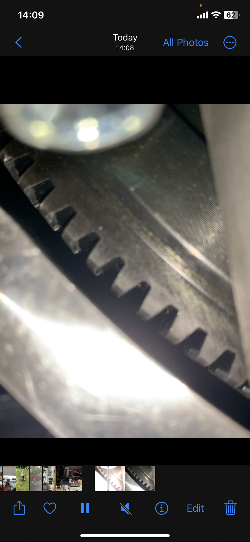

whatcha guys think, this is after about 5 starts.
