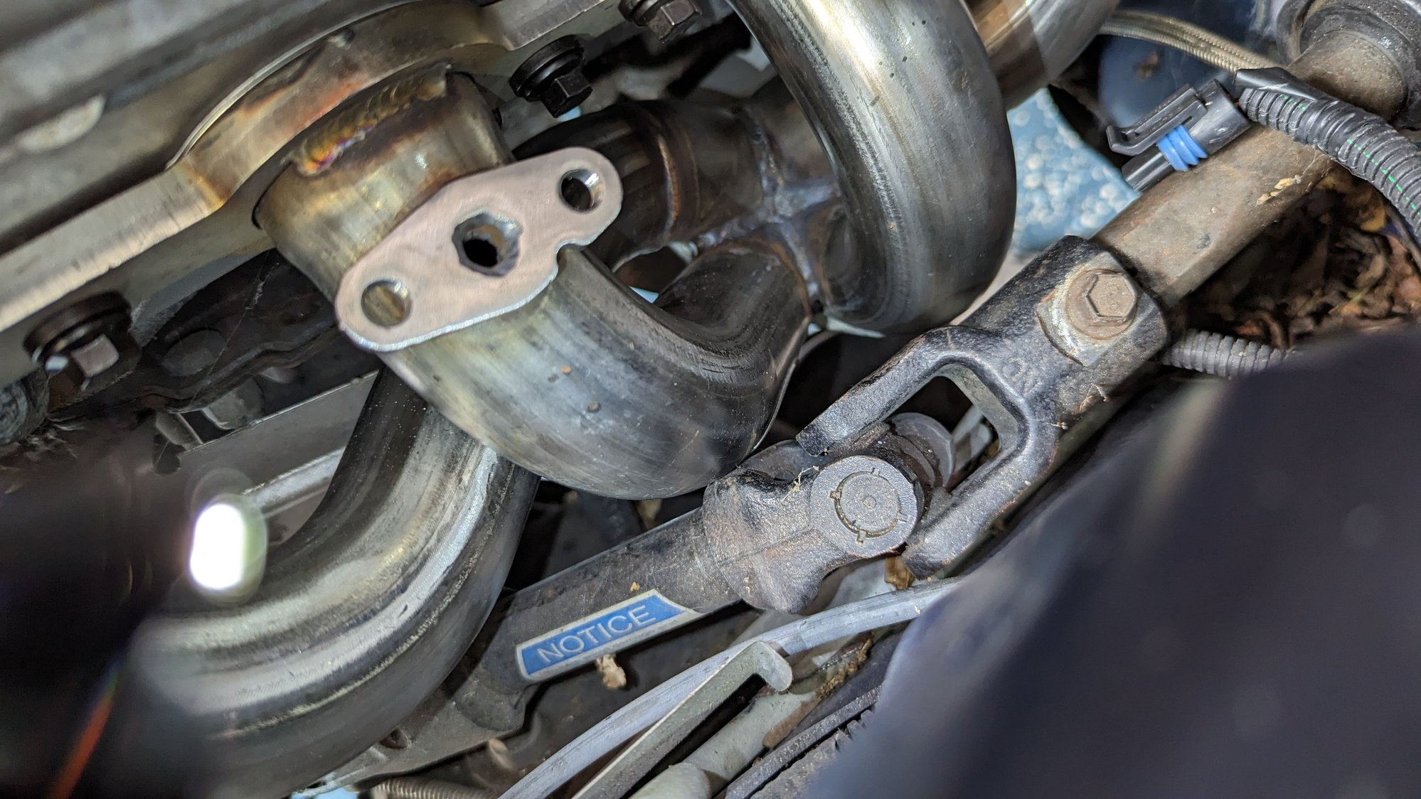

I'm reverting from Long tube headers to blackheart shorties because Cali...... And I'm having an issue with the steering shaft to header clearance any suggestions? Can the shaft telescope to make room? The pacesetter headers i previously had on there had no fitment issues.

Dent the header. It won't cause a loss of hp.

I'm reverting from Long tube headers to blackheart shorties because Cali...... And I'm having an issue with the steering shaft to hear clearance any suggestions? Can the shaft telescope to make room? The pacesetter headers i previously had on there had no fitment issues.
my old truck was the same way, I took a torch to them and got them nice and hot and then knocked a dent it them with a hammer

Usual solution is, oval out the holes in the firewall where the column bolts in, to let it move away from the header.
¼" of movement in the base of the column turns into at least ½" of clearance.

You can loosen the column bolts where the steering wheel mounts, and slid the steering wheel a bit. May be enough to clear it.

Is the car sitting on the ground with suspension loaded?
