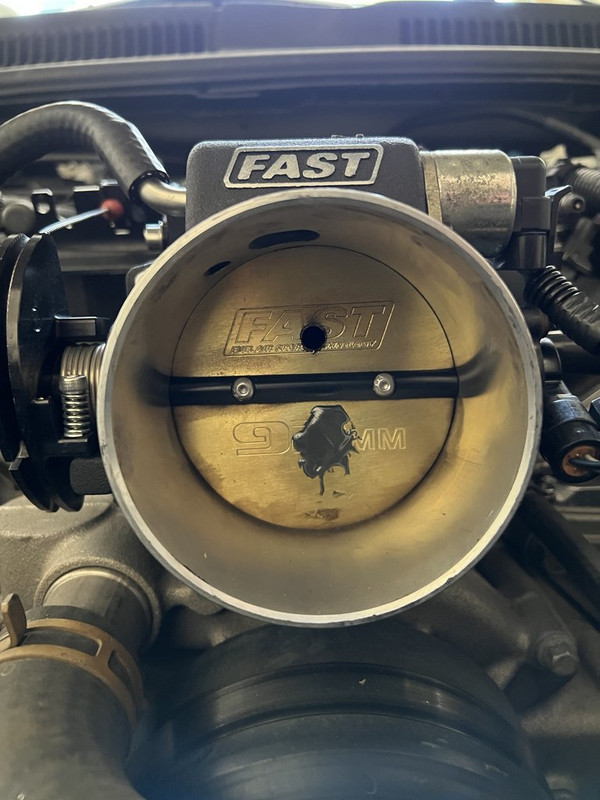

It’s a FAST 92 TB and 92 intake. I got it apart, and there is roughly a 3/8 hole drilled into the plate. It looks like there was a second one, but has been siliconed.
I did the the original TPS sensor while on the car, and it all the numbers functioned correctly. Voltage was correct and moving the TB by hand, it all read correctly. Here is what I found:

Find another throttle body for starters.

I would recommend a Nick Williams and if you have access to HPtuners you would just need to get the idle air counts into the proper range at operating temperature, it needs to be between 30 and 60 counts in order to maintain idle.

The only issue with doing this is that you'll have the same sort of minor idle inconsistencies as a performance/aftermarket carb'ed setup, meaning idle speed will be slightly higher or lower as intake air (and ambient temps in the engine bay) cause the throttle body to swing from cool to hot or vice-versa. Excessive load changes may also lead to the same. The Holley on my '71 idles about 50-75rpm higher on a cool evening vs. a hot day, at least until it sits long enough at idle for the carb to heat soak (which can take a bit of time with outside air induction and a phenolic spacer). If you drive the car in a wide range of weather extremes (such as a year-round daily driver), this inconsistency will be more pronounced. Many factory carbs had various provisions to stabilize operation for ambient temp swings or load changes (such as Hot Idle Compensator, A/C solenoid, thermostatic pre-heater hose [though this was not the main purpose for this component], etc.), but you won't find these in use with most aftermarket/performance carb applications due to complexity and/or power inhibiting effects. IAC is used in an SEFI setup to maintain consistent idle speed during load and temp changes that will otherwise have to be averaged when the IAC is rendered inoperative. Probably not a big deal for a weekend toy, but it will likely have to be set to an idle that's a bit too high (during cold weather) in order to maintain reasonable idle speed under heavy load and/or hot conditions.
On a side note, looks like JB Weld was used to close up the other TB blade hole in the picture above. The existing hole looks larger than the one found in a stock TB blade (I think those are 5/32" from the factory, or the closest metric equivalent).
