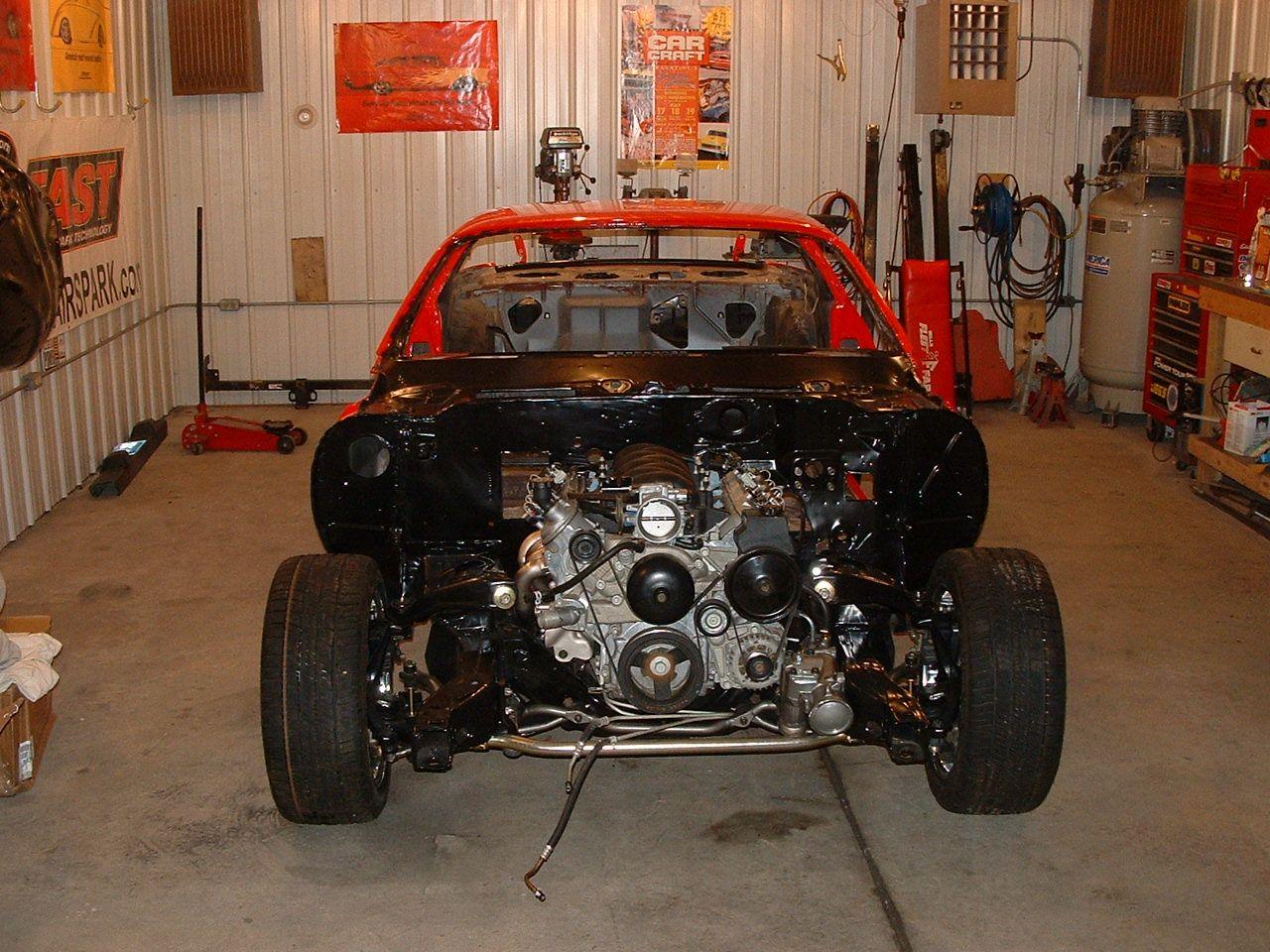

Man that seems so odd. Two different rotations for the same C5 LS water pump?
It's easy to route the belt wrong.
I only have run 2002 Camaro FEA on my LS swaps. Smooth side of the belt spins the water pump and the idler. Grooved side of the belt runs the the crank pulley, alt, ps pump and the tensioner.
Car Craft mag ran what they called a "one shot" mag that showed the belt routing for Camaro, C5 and truck.
This is pic of my 79 with stock LS1 Camaro FEA. The difference to the C5 is the alt is high and the PS pump is low.

My belt runs almost exactly like yours with the outer side of the belt spinning the water pump. I understand now that there was a revision at some point in the C5 run that changed the water pump and that I have likely had a later C5 pump and thermostat housing installed unknowingly. A while back I changed the thermostat thinking that my leak may have been coming from there and the housing gasket I ordered was completely incorrect. It was a little rubber O-Ring rather than a proper paper gasket. At the time I assumed they sent me the wrong part but I looked at the package again just now and it says 350CI 5.7L V8 LS1 (VIN G) 1997-2001. 2002 was a revision year for the C5 and another guy on the Vette forum with a 2004 told us that he runs the clockwise pump without issue so I'm guessing that 2002 is when the pump design changed. Additionally, my car has a G in the VIN so I'm inclined to believe that this gasket should have worked for my car. I had a new pump and housing installed originally so I'm pretty certain now that I have had 2002-onwards pumps and housings on the car this entire time, hence the gasket not fitting and all the issues. I'm having a hard time verifying if these pumps meant for the later C5s actually spin clockwise but regardless they are not the pumps that are meant to be on my car so I want this current one taken off and replaced with a correct early model pump ASAP. It actually started making noise today so it's definitely nearing it's end. Going to talk to the garage again tomorrow, tell them about all of this and hopefully arrange a date to finally fix this once and for all.
That's a sweet project by the way. Those Camaros are cool looking cars and a nice LS1 is just what the doctor ordered to liven them up haha.
