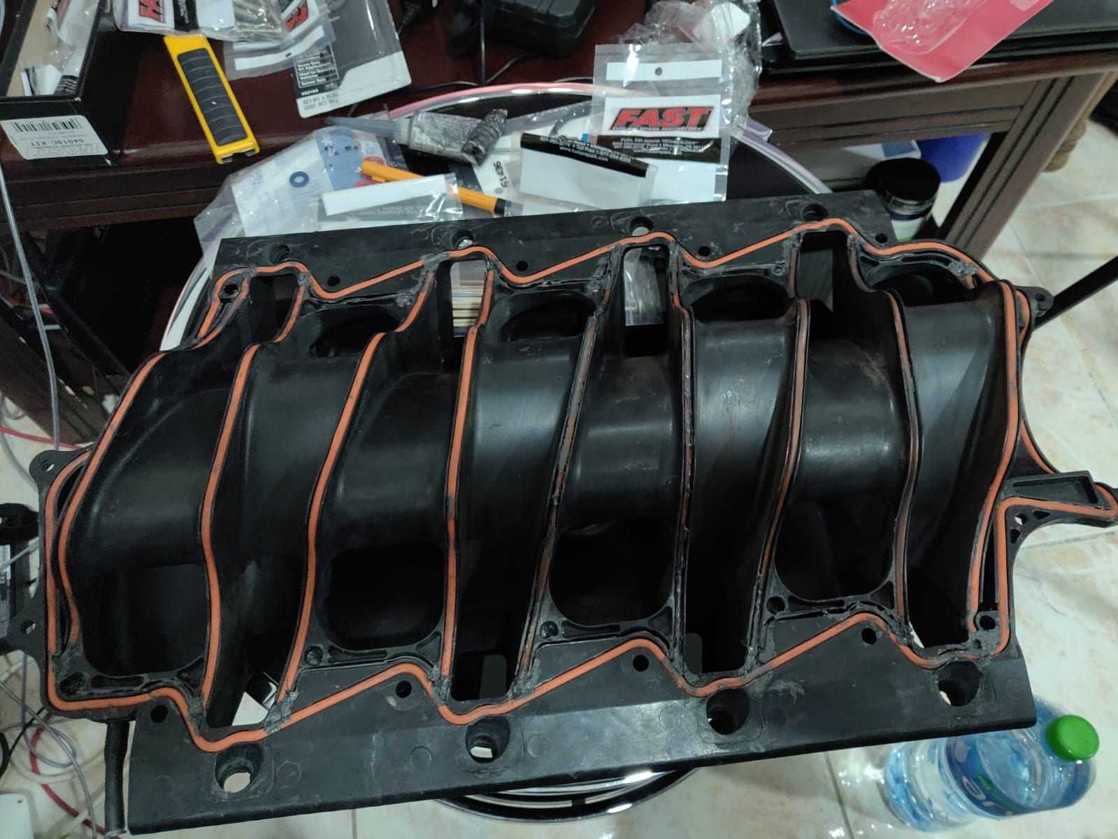

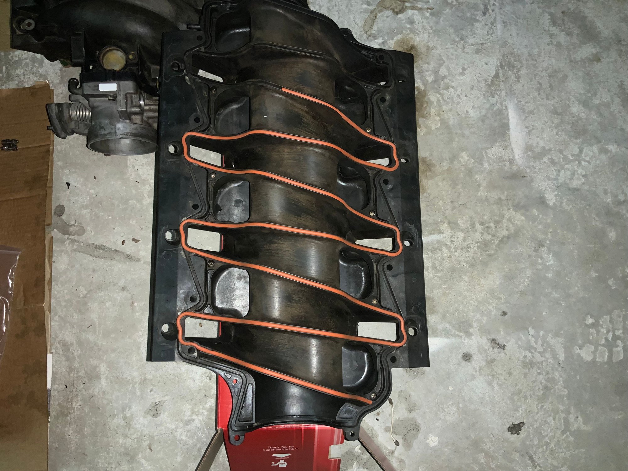

I am not sure if Fast gave me the wrong item or not enough rope seal? I would think how expensive thIs is they would give me enough for the entire intake. Could some advise how many quantities they ordered for rope seal for a fast 92?

I got a inner rope seal kit for my 92.....had plenty left over after the install....i also coated the seal with dieletric grease to aid in sealing

F.A.S.T. Finally got back to me and stated they shorted me and sending more rope out now. I am using tech guy advised to use this over the top of the rope and to add extra on the cuts of the rope and on the back of the intake. Are you lubricating the rope like the o-rings for injectors in to the fuel rail?
