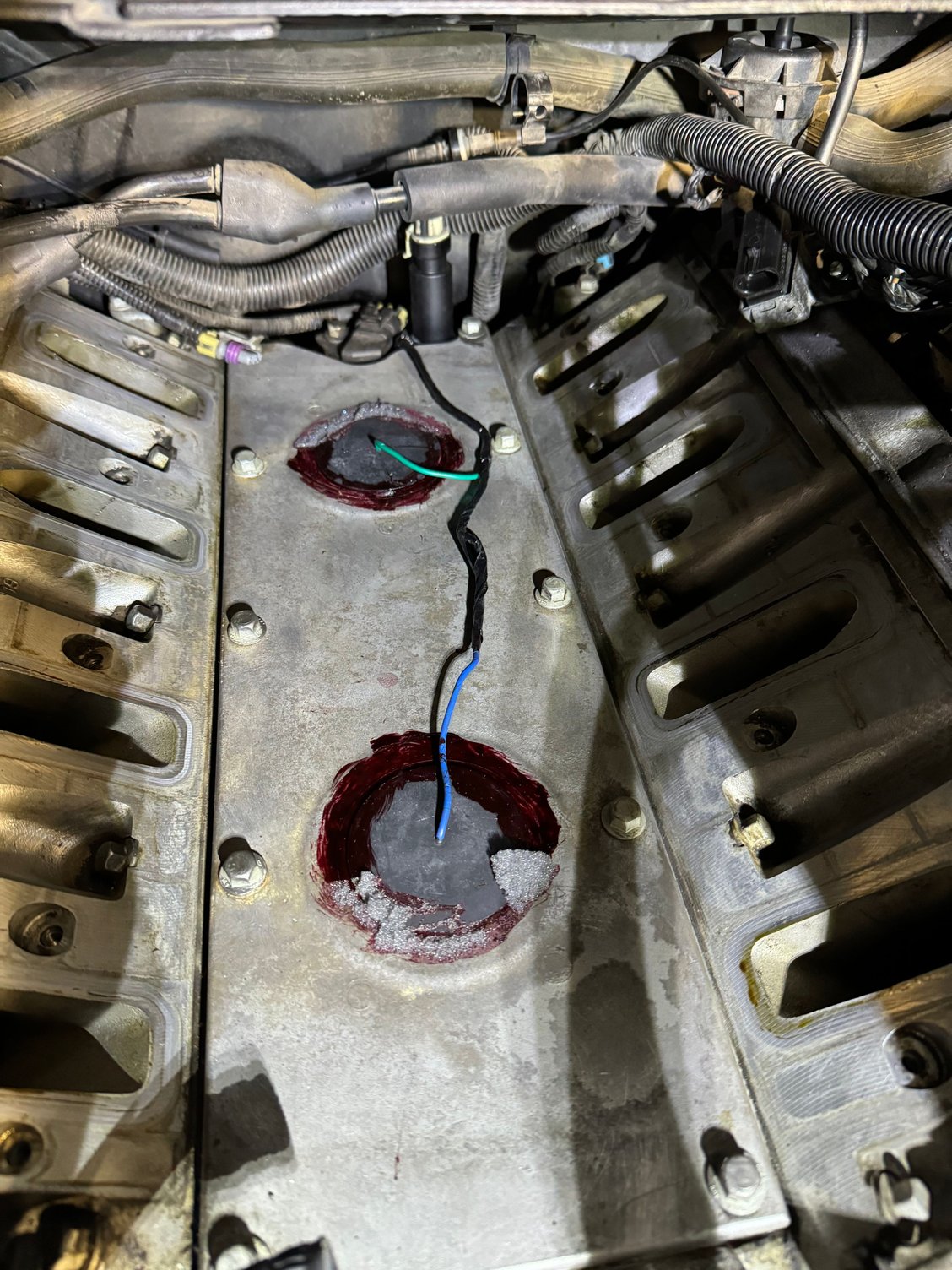

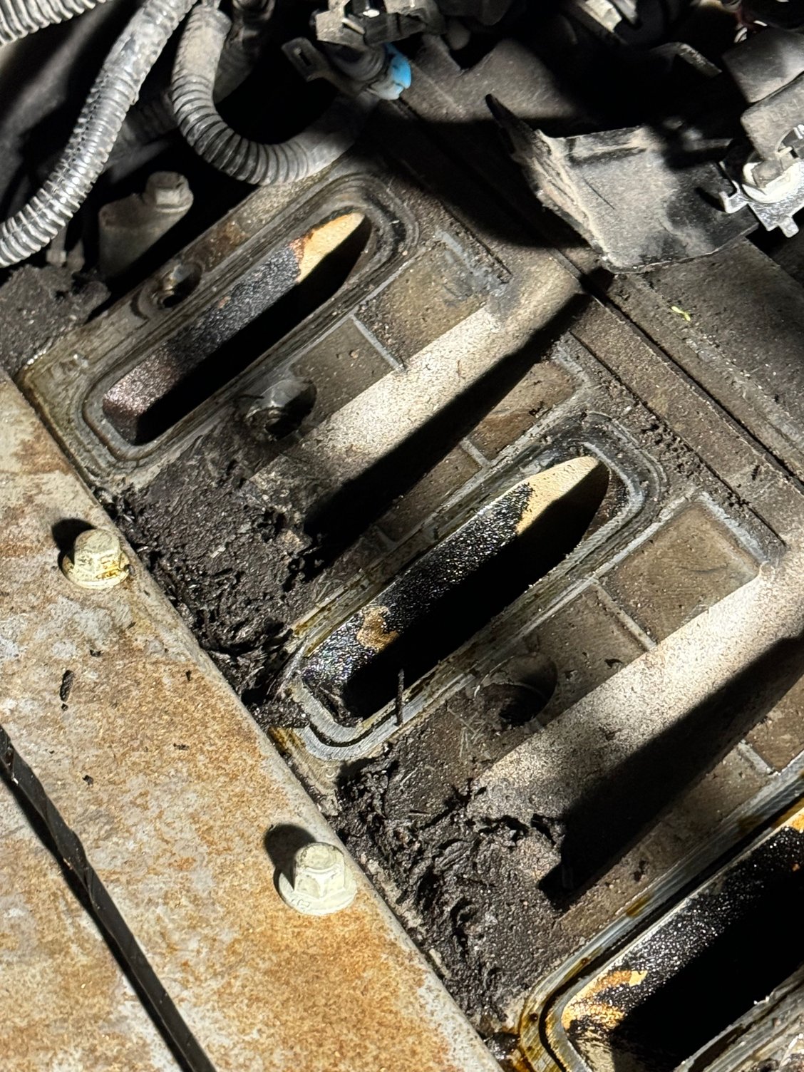

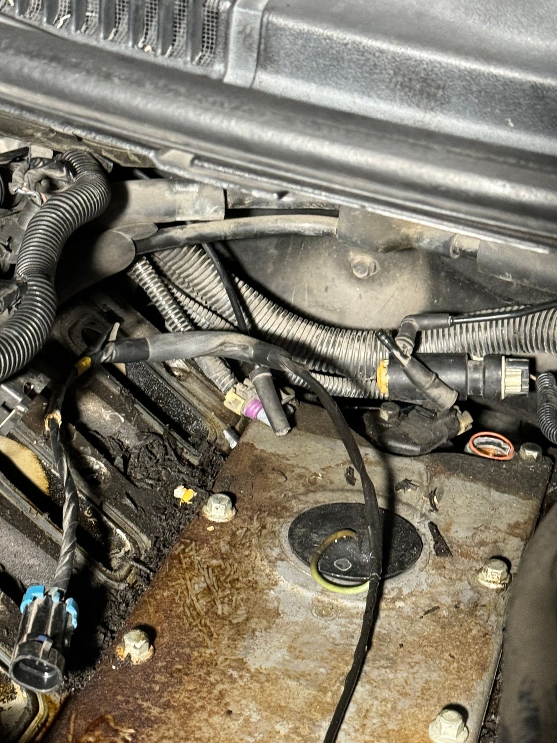

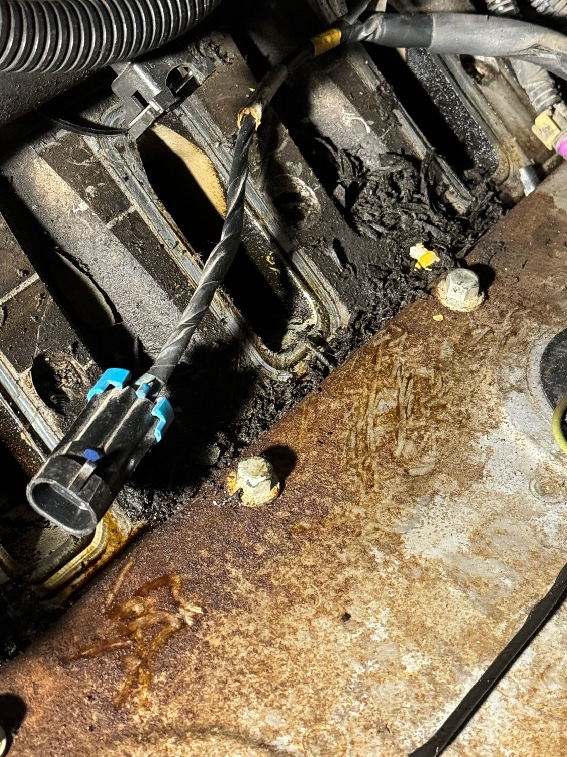

Have had this 01 WS6 since 2007, generally running fine. Mostly stock with 107k miles. A little noise that sounds like detonation at WOT above 4500rpm. Decided to pull the intake manifold (what a pain) and replace the knock sensors in case that was a factor. Figured it would be a little dirty, but after removing the intake manifold the valley cover area is downright filthy and has gunk and what looks like oil clumps all over. I can’t imagine this is good at all for my engine. I plan to shop vac the clumps out and wipe everything down, but while I have this apart what should I be doing to get my engine properly addressed in light of these photos?

About all you can do is get in there with a plastic scraper and maybe a flat head screwdriver to scrape the gunk away. Have the shop vac ready to remove the crap. I stuff shop rags in each intake port to help keep dirt out of them, but it’s inevitable. Some dirt will get in the ports. A shop vac will get it out of them, just be patient and use the shop vac liberally after your done, and the rags are removed from the ports. Unfortunately all LS engines look this way after many years of use.

Before cleaning I’d remove the rocker stand on both banks to ensure all intake valves are closed. Shop vac first and some lint free rags/towels and maybe some engine degreaser. After it’s clean some compressed air to blow everything out including intake runners. Pretty straightforward not much to it. Multiple correct ways to do it, I’m sure you’ll get a lot of suggestions

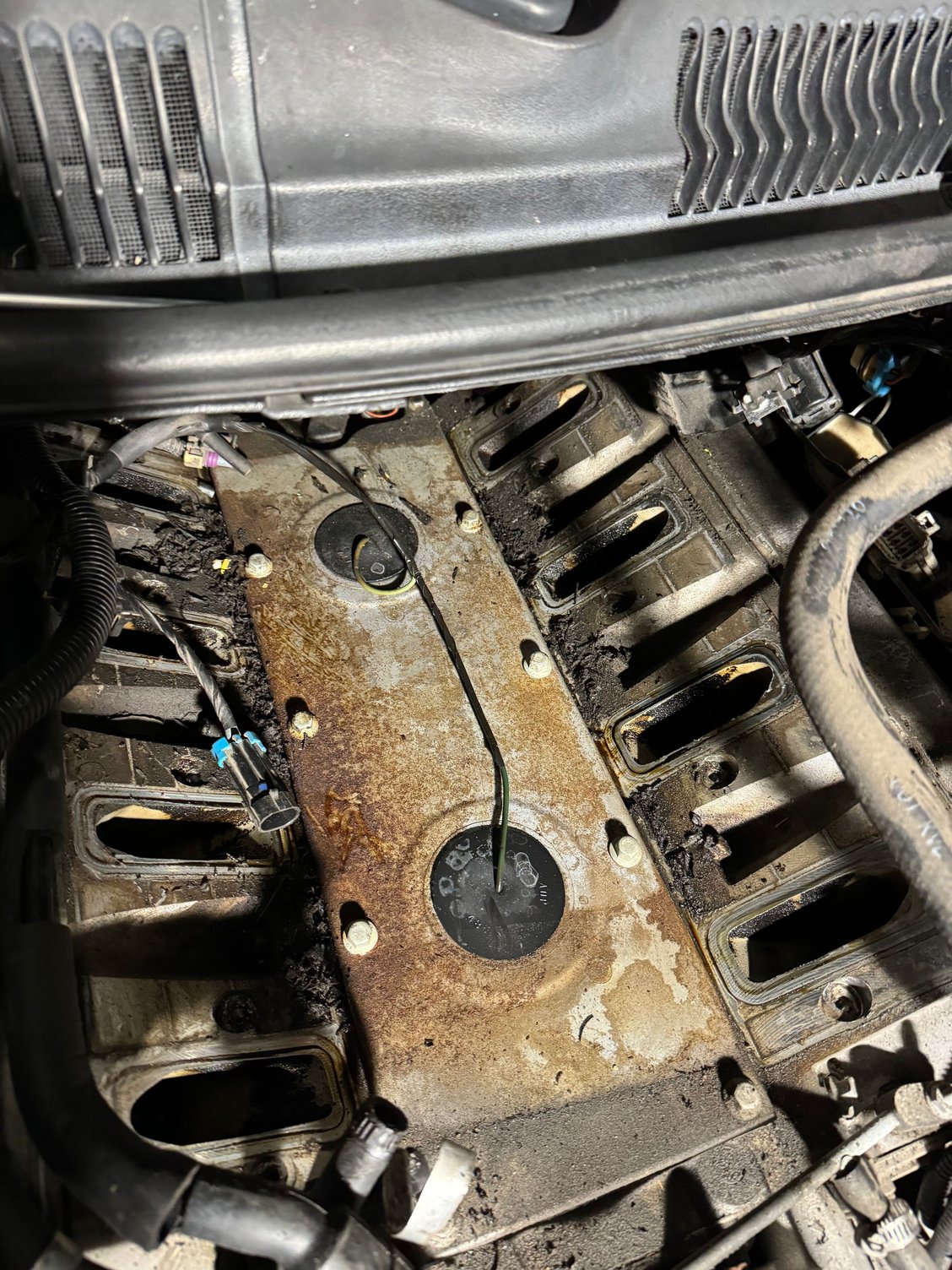

I’ve got it looking much better! I deep cleaned the intake manifold with degreaser and brushes as well

Cascadesys, the engine cleaned up nicely. Good job!

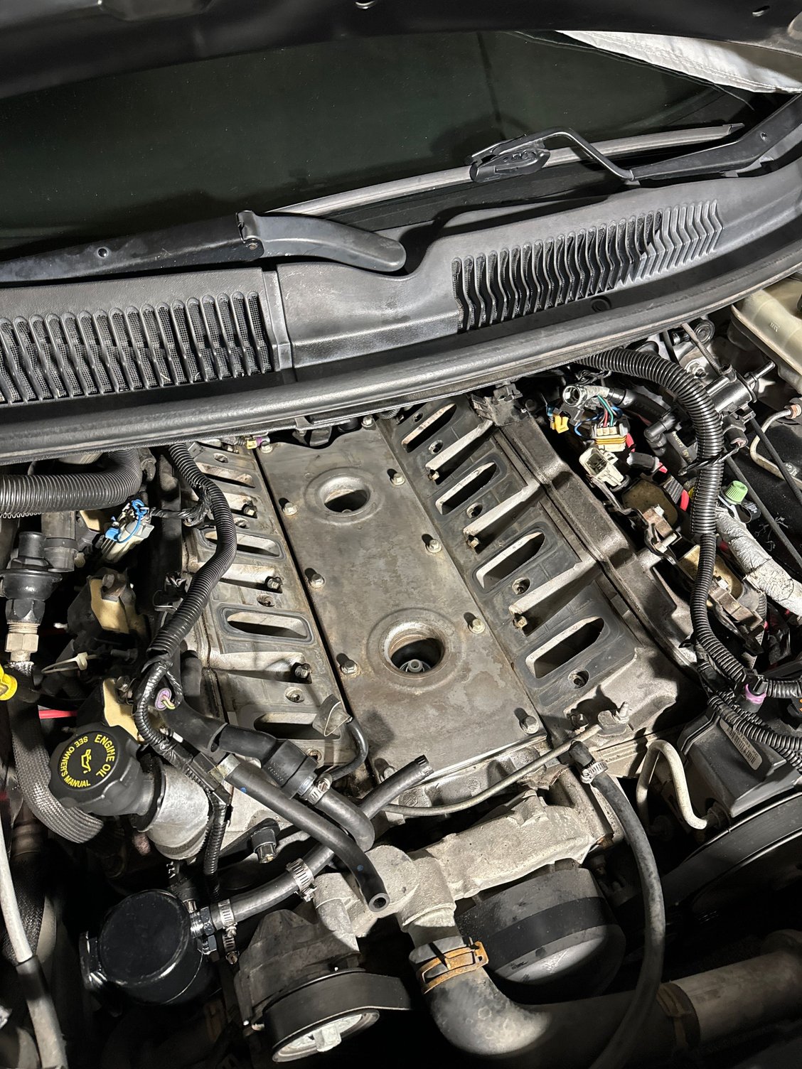

I replaced both sensors and the harness (Delphi sensors, Dorman harness). Delphi was a division of GM and spun off as a separate company around five years ago, so it's my understanding that they are similar to AC Delco in a sense that they are reputable and not the problem here generally. I got low voltage codes for both knock sensor banks. Pulled the intake manifold again (much faster the second time, but still a pain) and replaced both sensors yet again with brand new Delphi ones, and checked the harness and didn't see any damage or areas it looked pinched. I torqued the new knock sensors to 11ft/lbs aka 132in/lbs and put it all back together. Took it for a drive and the code for knock sensor bank 2 is gone, but bank 1 (the front) is still coming up. At a loss, so frustrating. Here's a photo of my harness when I pulled the manifold the second time, doesn't seem pinched does it?
