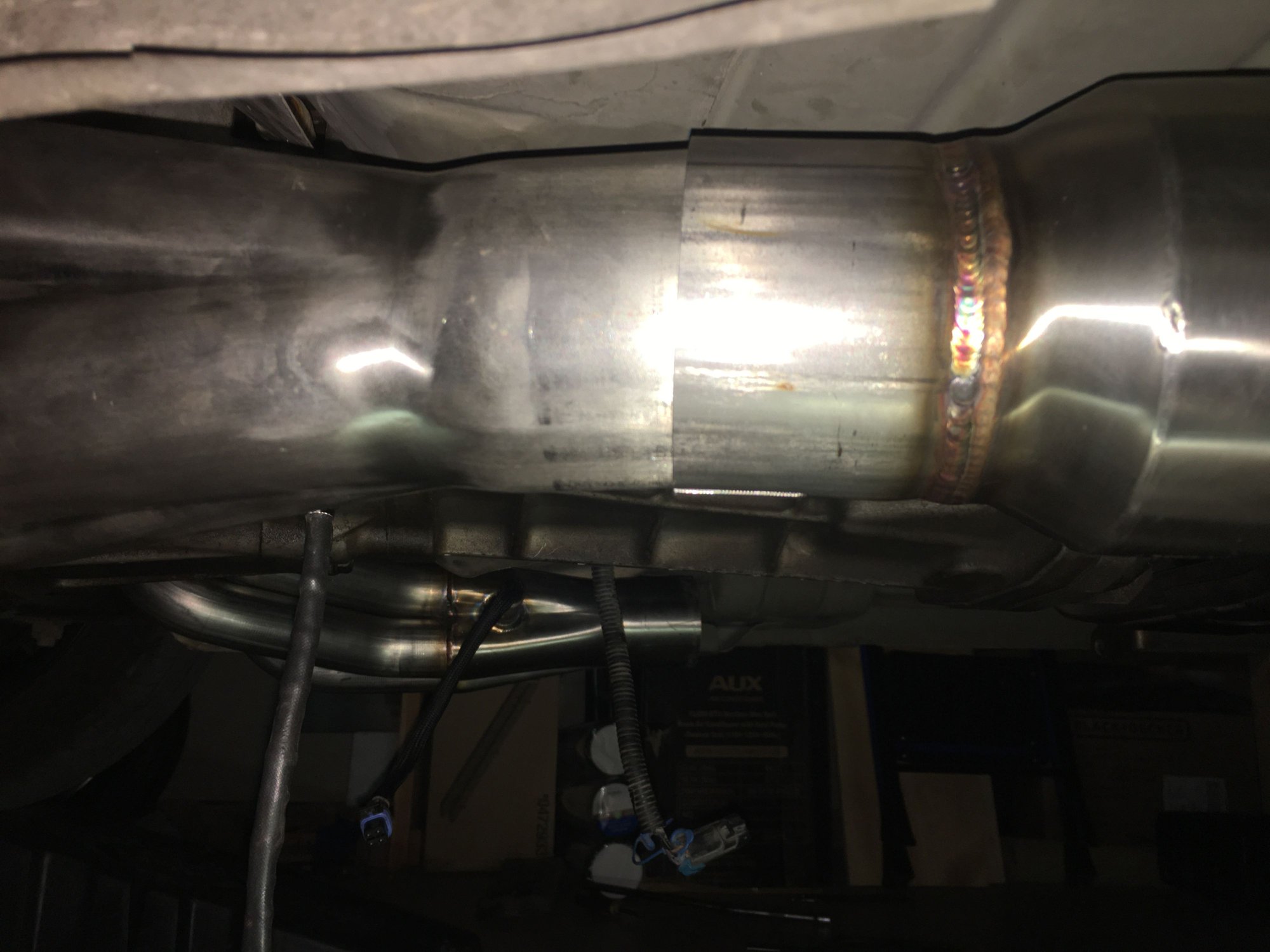

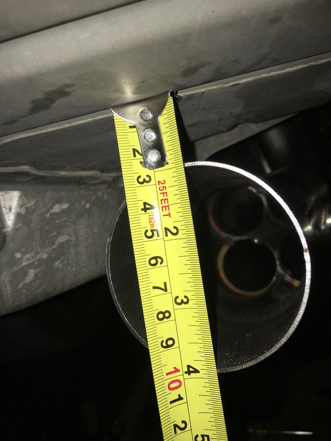

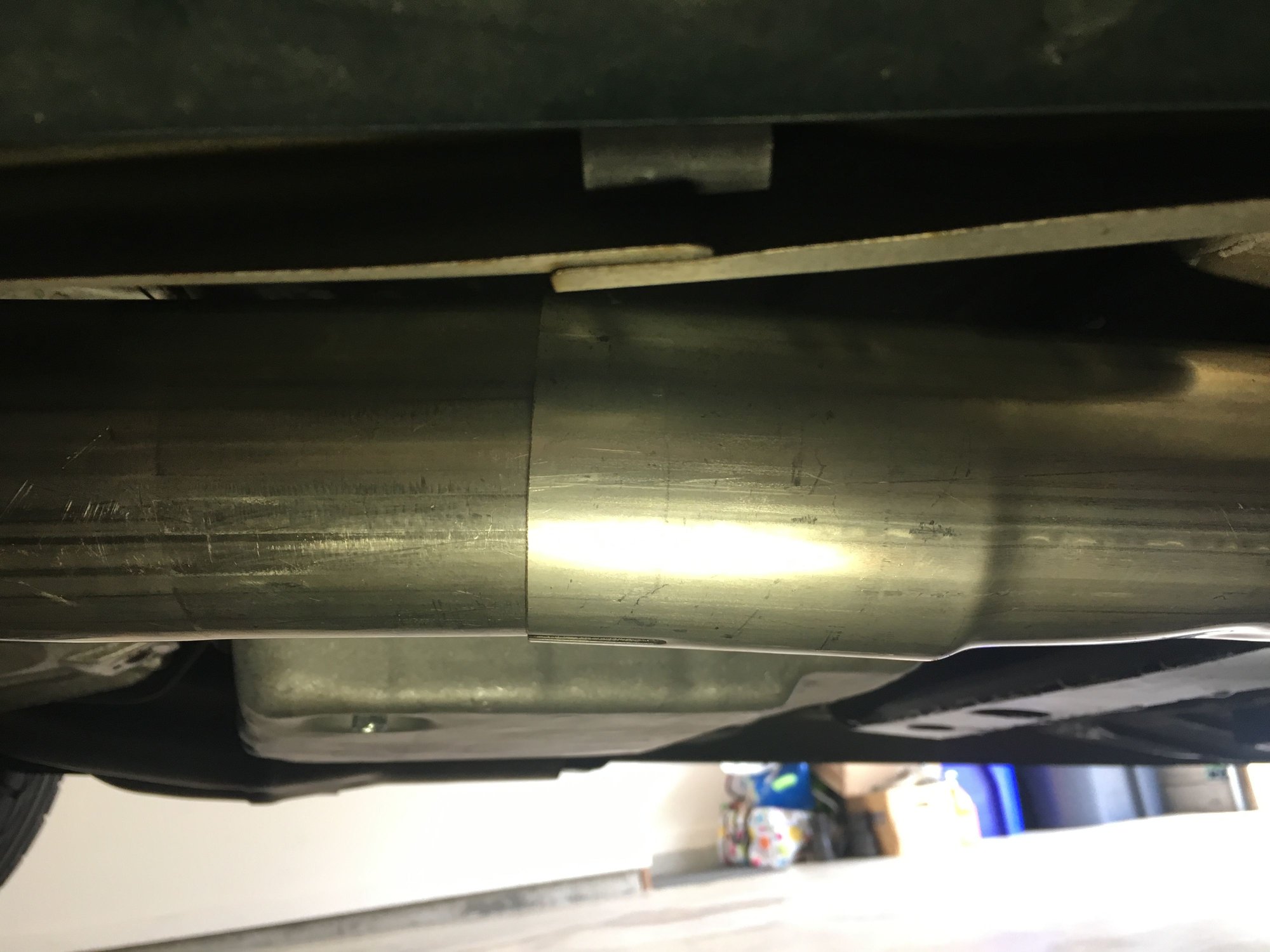

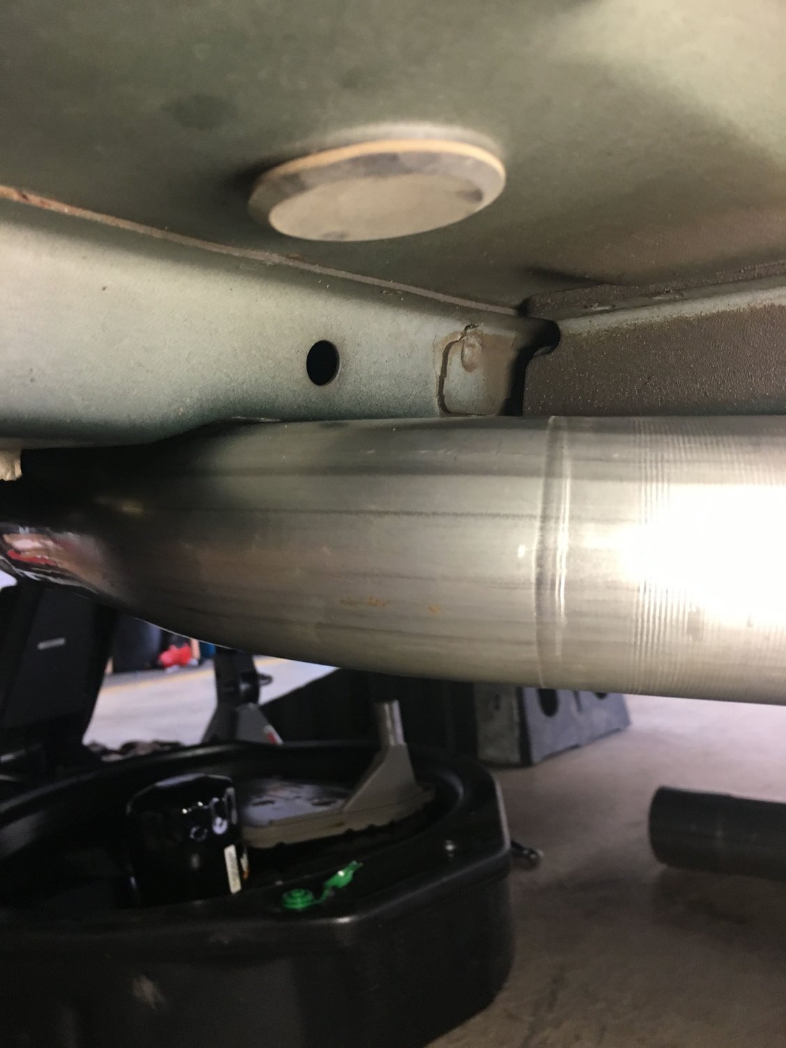

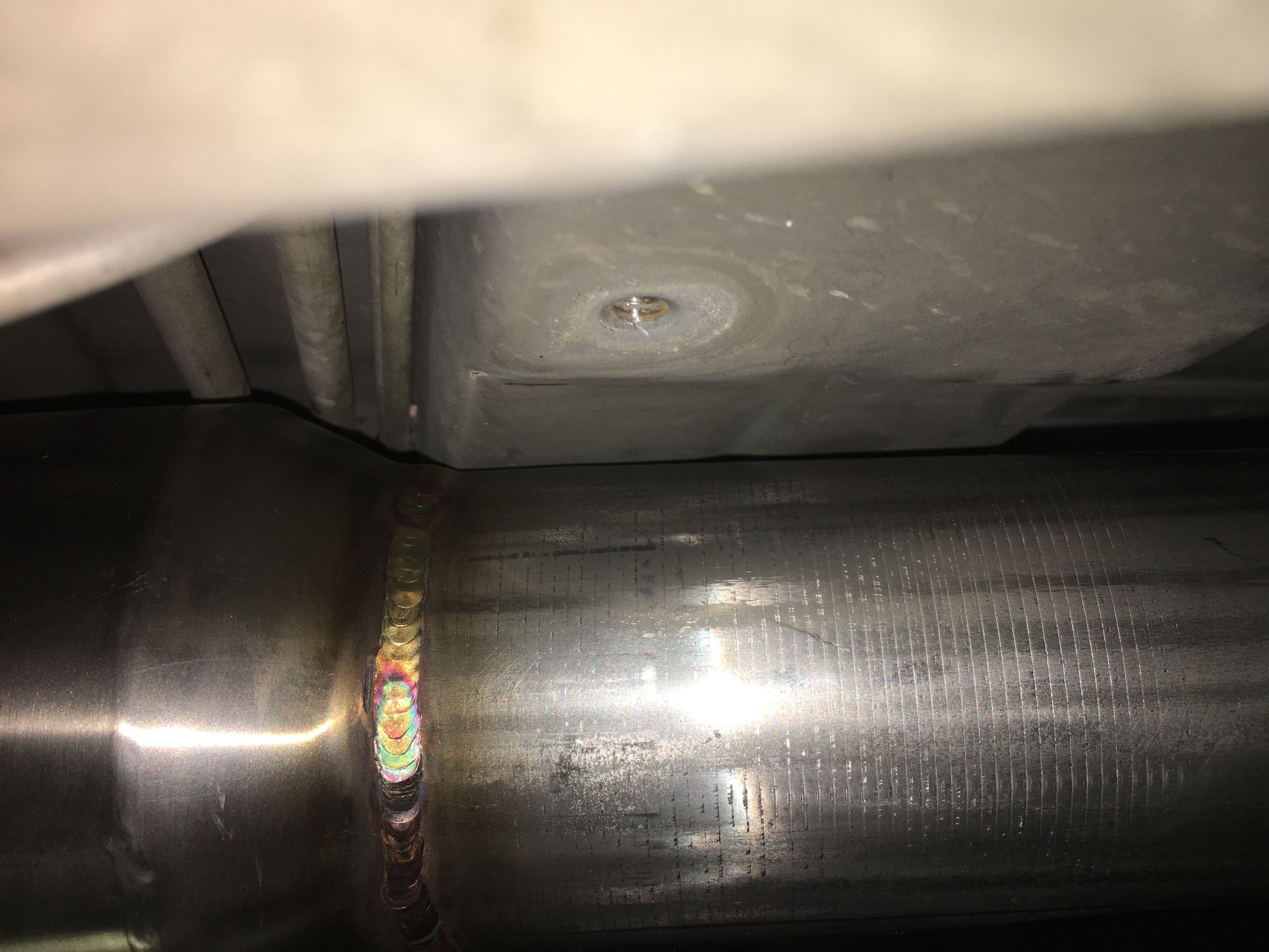

Has anyone had this issue? New set of headers- car is bone stock and low miles, trans and engine mounts are good. The collector is too high and cat will not fit there.. collector is 1" from bottom of the car. I also removed the heat shield there and still, not enough clearance.
other side fits great and will stay installed.

Looks good to me.... looks like your aftermarket cats are the issue, not the header.

Had the same issue with my first set of TSPs.....had to BASH the crap outta the pipe after the header to get it to fit....not a pretty sight

3 sets of TSP's did that exact thing on my car. Angle was upwards so much at the collector that nothing would slide together. They said my car was wrecked. I had to switch brands and oddly enough the new brand fit perfectly.

Have you shown the pics to whoever made the headers? Can you return them? You could also alter the angle slightly, but you'll need to cut it, mark it, and weld it, or have someone weld it for you - been there.

Are you planning to weld it or clamp it? I'd loosen the header bolts up enough to give it a little play and then either put the clamps on or weld it and then tighten the header bolts back up. I guess I'm a little different then some of you but I'd definitely make that work

If you can't return I second the thought of a slight pie cut to pitch the collector down just a bit.

the cat fits, it's just hitting The pipe welded to the other side of the cat.

If you can't fix it with a HAMMER, then you'll need to make a cut and WELD it.
