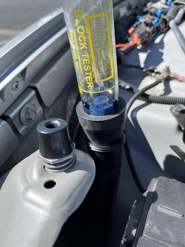

Yah, if you want to test for combustion gasses in the coolant, that is easy enough to test (block tester)
If there are gasses in leaking into the coolant the fluid will turn yellow
https://www.youtube.com/watch?v=wcDe2QYN8As
Yeah, I was on a different site asking questions as well and one replier stated that he has blown 2 in two years and someone he knows blew 4 in 5 years. apparently cold case is crap, but to their credit they have a lifetime warranty, all you do i pay shipping
