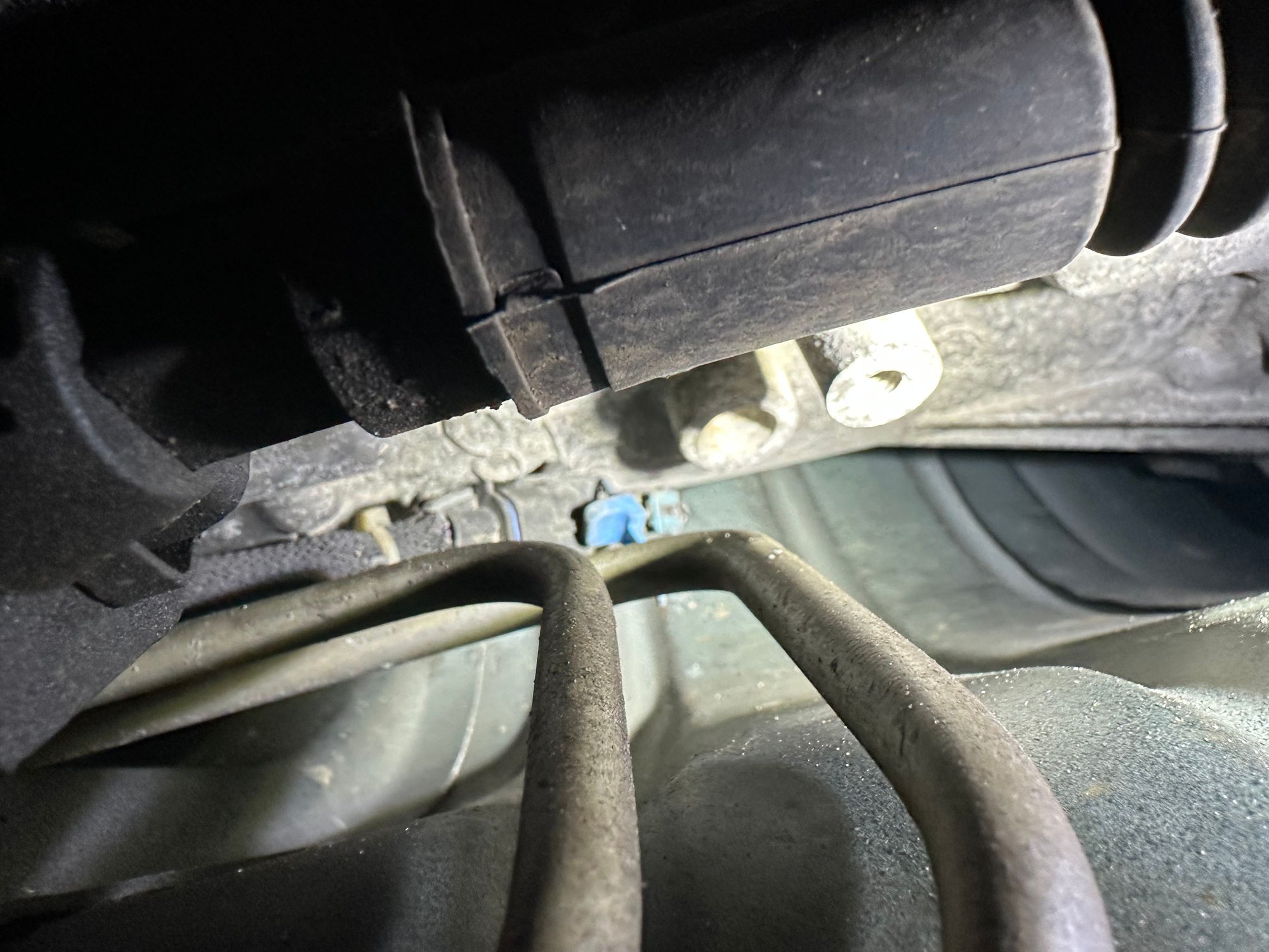

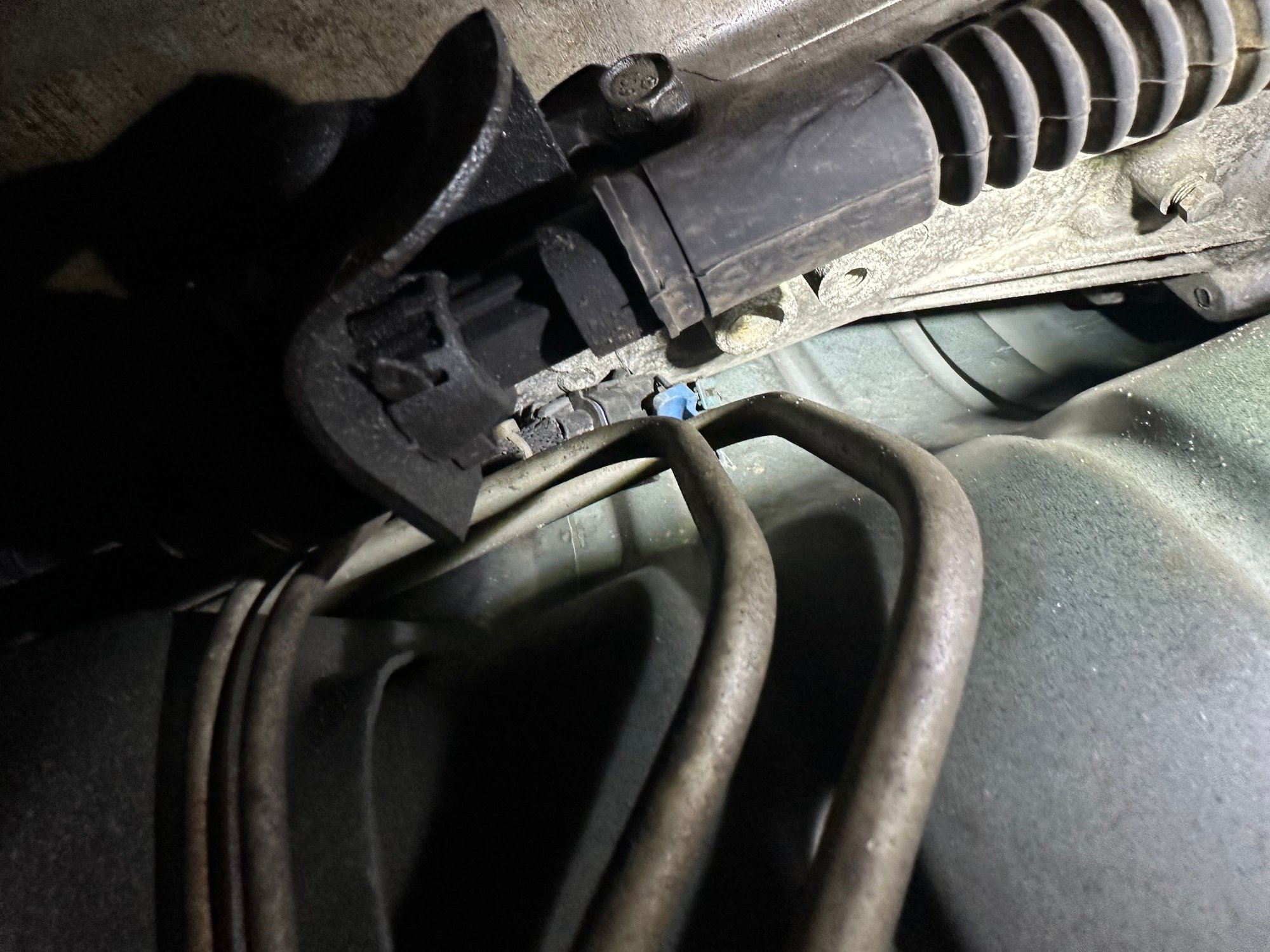

How would you disconnect that from the harness? There is no play in the wires, and I can’t even get one hand up there, let alone two to unhook it.

Thats a tight spot for sure. What you can try maybe, is once you have the new sensors. Cut the wire off from the end of the old sensor while its still threaded in, then maybe use a long screwdriver or pry bar to pop the harness end of the connector from whatever its attached to. That should give you enough slack to let it come lower and then unplug it

I have 4 sensors still. I’m not sure why, had the car for years and all the mods were already done. Long tubes with no cats. The car has a tune, so I want to keep everything exactly how it is. The front two and back drivers have the shorter lead, and the back passenger is slightly longer.
Good idea on cutting the wire first. I’m still worried about getting it plugged back in, and I can’t really tell if that zip tie is just around the wire, or if it’s actually secured to something.
