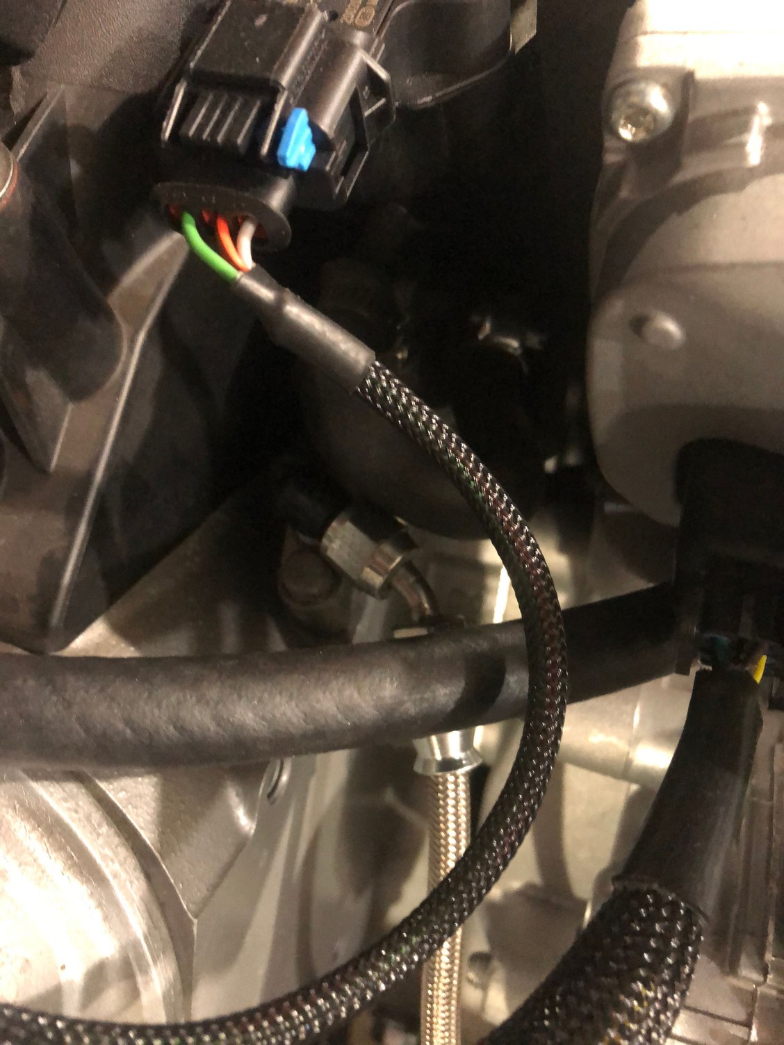

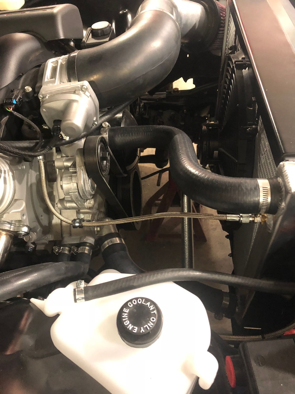

So because I'm cheap I tend to piece stuff together as needed. LOL.
In regards to the steam line I use a LS steam line cross over with the output nipple is on the right side of the engine. But I cut off the the nipple and drill and tap for 1/8" NPT. Then using -3 AN fittings connect to a typical? -3 SS brake line to a NPT bung I have welded to the radiator. We have a local dirt track parts guy that I get my PTFE line from if the length isn't quite right you can disasemble the ends and shorten as needed.
Couple of pics of my current 80 project.
