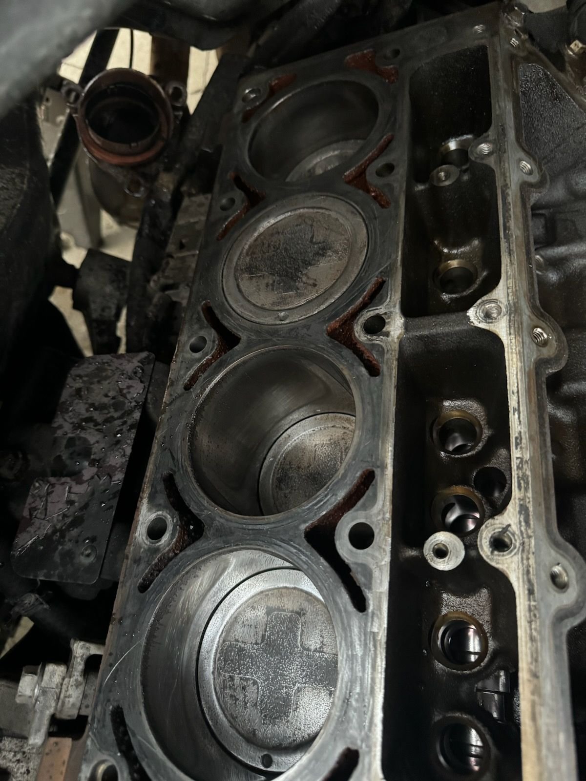

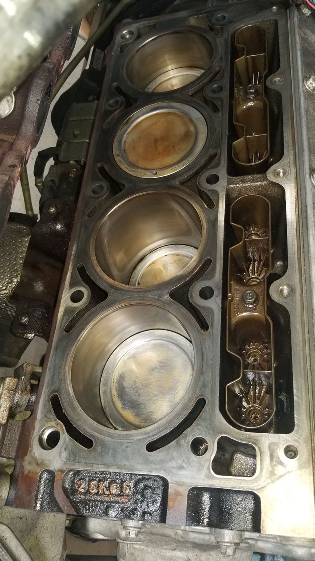

Purchased 2 engines and trying to determine what the differences are. Both engine blocks have the same casting numbers, 1 is a full digit number while the other only has half of the numbers. Also the pistons are different, one is dished while the other is dished with a cross. Any input on these? Pictures included. Thanks!

Is there any reasoning for the different pistons? Or would that just be a different plant using different pistons. When searrching for cam bearings it’s specifying it’s for a first generation block or a 2nd/3rd generation block. That’s my confusion at this point.

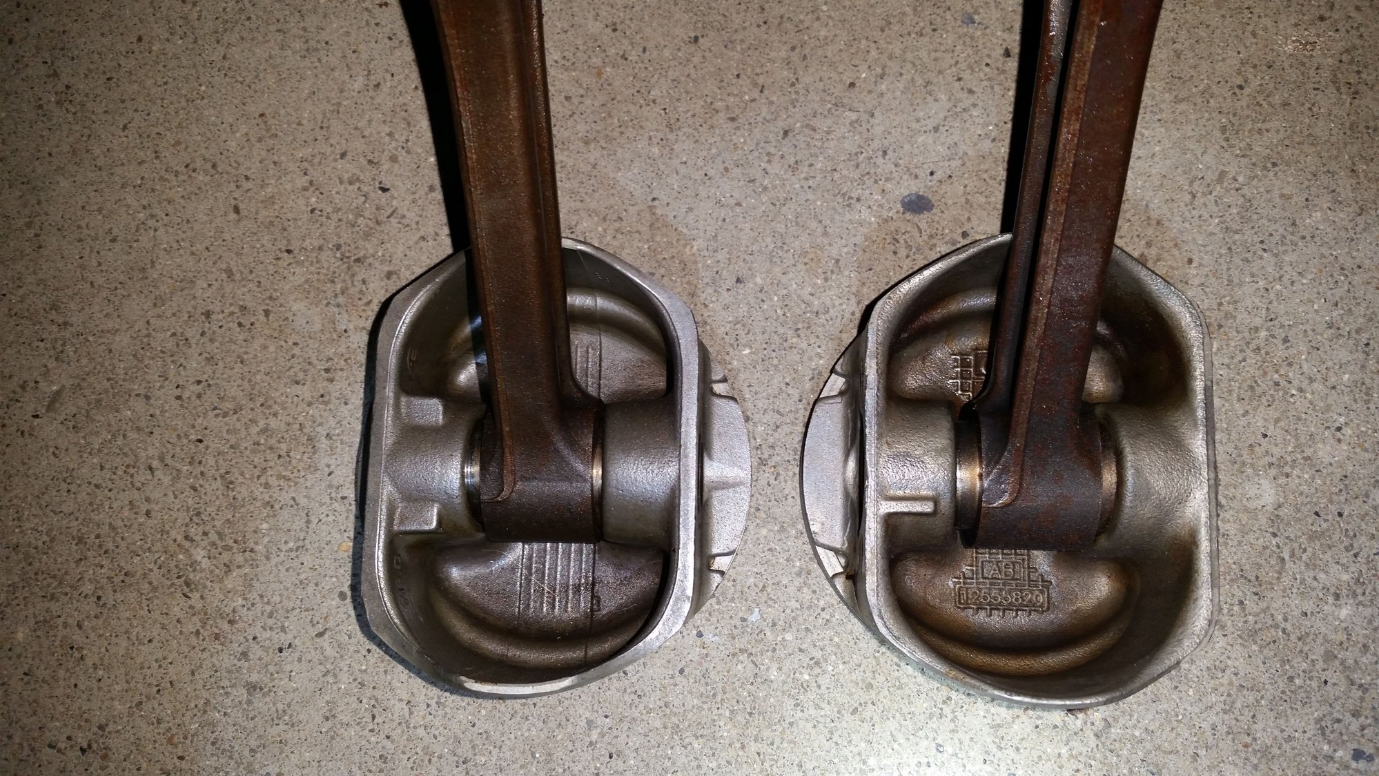

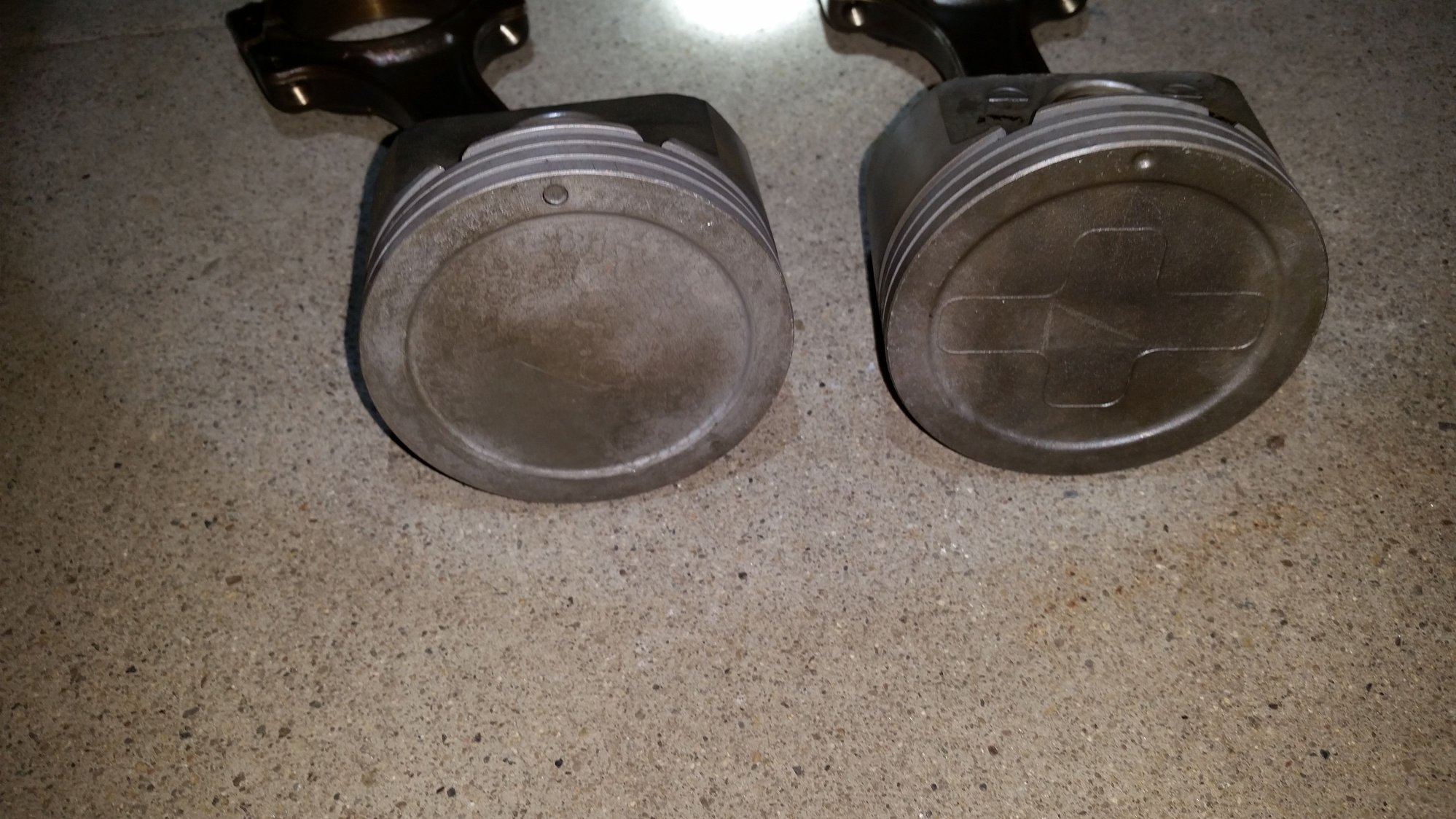

I found the post I made showing the 2 versions of the early pistons with no coating. You can see one casting has the cross marks in the dish while the other one is smooth.
https://ls1tech.com/forums/generatio...l#post19417757
I believe the one on the left in the image is the first design. I believe 99-00. The second design is on the right. I believe 01-02. The third should have coated skirts and be 03-04. In 2005 they went to the floating pins with the stronger rods.

So it looks like they may have had different suppliers for pistons.
My 2006 had smooth dish pistons in it.
A friend of mine also has an 06 but his have the cross marks in them.
Both have 05 production dates on the block and appear to be un-molested.
