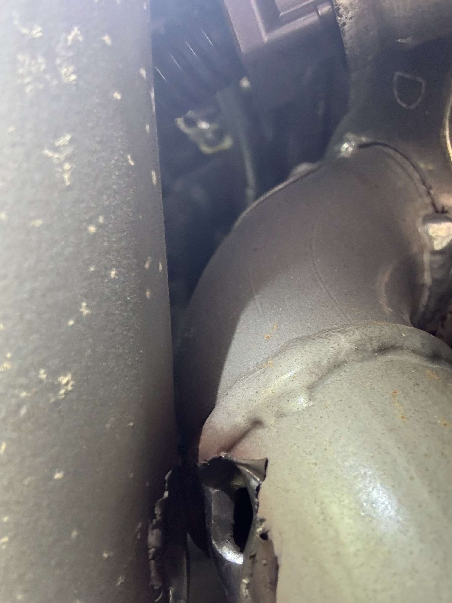

Default WTF could have caused this? Hole in stainless steel headers 2002 Camaro SS slp.
Took in for o2 sensor light and exhaust rattle near cats. This is only pic sent.

Default Large hole in headers. how is this possible?
I posted this in lsx discussion but am unsure if that’s the correct spot. Trying to figure out what would cause this hole in stainless steel headers? Only 1 pic.

Metal impurity. Or something knocked a hole in it. It sure didn't melt.

Is someone in the process of building them or something? The flange looks like 3 tack welds..

What's going on with the 3 tack welds and the crack at the flange?

The shop suggested a tune for the long tune headers after a scan (that have been in the car for ~20 years no issue) to fix the o2 codes it’s been throwing. Post tune, there was still slow switching so they suggested to replace with a 300 dollar set of headers without looking at them. I declined and told them to inspect the headers because this is a ~1000 dollar set. I got this photo and a ~4000 dollar estimate for headers job with high end headers after they inspected the headers. After I got the car dyno’d by them.
they did not try new o2s before directed to inspect headers.

These are SLP headers, they were built that way.
In reference to the top of the image, correct?

Of course the hole in the primary can be repaired but I'm with merv here as it looks like someone is welding a new piece of pipe to make a new primary and has it tack welded to the flange. Perhaps somebody f/d up and arc'd over on the primaries and blew a hole through there.

You’re right though, something looks weird about the tack welds. I’m going in tomorrow to look at it on the rack.

Whatever it is, is a fresh hole because its shiny. That's what's concerning. Looks like someone drilled a hole there or you caught a bullet..

It looks like there's holes in both primaries.

Yup, something went through there. Only one picture, taken from that angle for a reason.
I'd definitely put eyes on here.

There is obviously metal going both in and out of a fresh puncture. Something was punched in and pried out. I am having trouble seeing how this could be anything other than caused by the shop.

looks like someone took a carbide burr and ground holes

Super fresh hole, not a speck of soot on anything. Hope you can find an economical solution.
What I thought instantly when I first saw it...

That 100% looks like a bullet hole. I wonder if the rattle is the bullet in the pipe.

Cat rattle & junk "scraped out"... Brick melted, pipe overheated, blew out?
The weld on the upper side of the hole looks like a dogshit mig weld..
Something SLP would do?
