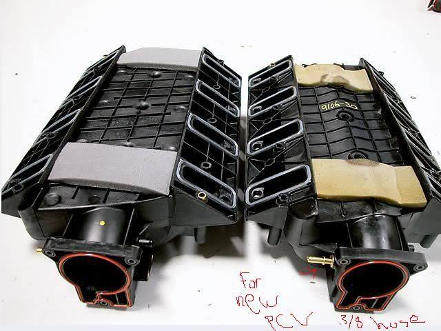

Be careful when looking for an LS6 intake because LS1 cars after 2001 (iirc) didnt come with the EGR on the intake. People try to pass those off as LS6 intakes. Make sure you get the right part number for the LS6 intake and you can identify an LS6 intake very easy.
the bottom is FLAT compared to the LS1 with the ridge in the center. see below but pay no mind to the scribble, this was a google image search.

I just need to clarify this for folks, as it's a misleading statement.
ALL 2001-2002 LS1 F-bodies came with LS6 intakes STOCK. It is correct that the 2001+ cars don't have EGR, but they DO, in fact, have an actual LS6 intake from the factory. This is NOT a scam.
What you are thinking about are the 1997-00 C5s, which also didn't come with EGR but still used a basic LS1 intake that just wasn't tapped for the EGR tube. Those are the intakes that unscrupulous folks might try to pass off as an LS6 (due to lack of EGR), and those are the ones you want to avoid.
Any LS1 engine, C5 or F-body, from 2001 forward came from the factory with an LS6 intake.

However, with that being said you want budget just keep tabs on what's forsale in the local area. While back I snagged a LS6 Intake from a 2001 Corvette LS1, paid $100. Guy posted it up as a LS1 Intake because in his words, it came from an LS1. Didn't look at the part number or anything and had pics of all sides. No EGR flat bottom, winner winner chicken dinner. I flipped that one for some beer money and other stuff.
