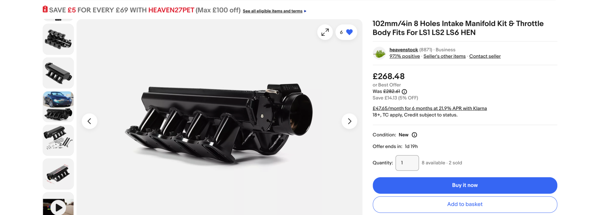

Sure this must have been asked before, so apologies.
Just browsing the internet and stumbled across these:
Have seen them before, but they look even cheaper than last time I came across them. I know, I know, if it looks to good to be true.....
Just wondering if anyone has any experience of them and if this kind of intake manifold will even fit under the cowl/scuttle on a 4th Gen Fbody?
As I'm in the UK, there is no real choice for intake manifolds here, unless I buy in the USA and ship over. Which is a very expensive process. My 99 z28 still has the factory LS1 style intake and I'd love to find a cost effective way to upgrade.

A very common problem with china sheet metal intakes is the intake to head surface mating angle being wrong. This makes some of them impossible to seal from vacuum leaks. If you get lucky and don't have this problem, they still underperform almost every other possible intake manifold all the way through the usable power curve. Then you will likely have to fabricate custom fuel rail mounting hardware, throttle cable brackets (if not a DBW), and a vacuum block. Also, you will need to get it to know if the fuel injector bungs are mounted angled or straight up and down before getting fuel rails. But they are cheap and look cool.

Those short runners will kill mid range torque.

garbage, any stock intake would be better
