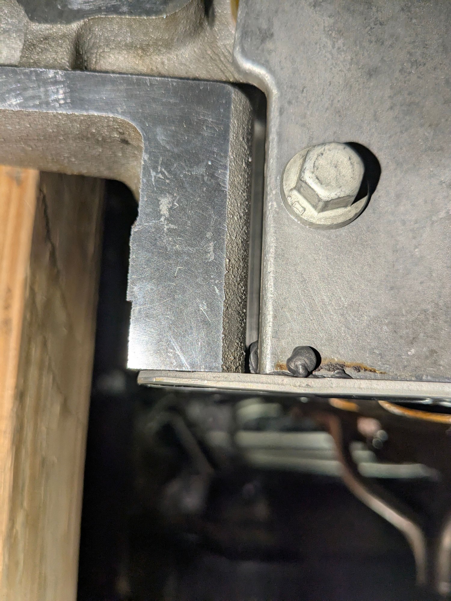

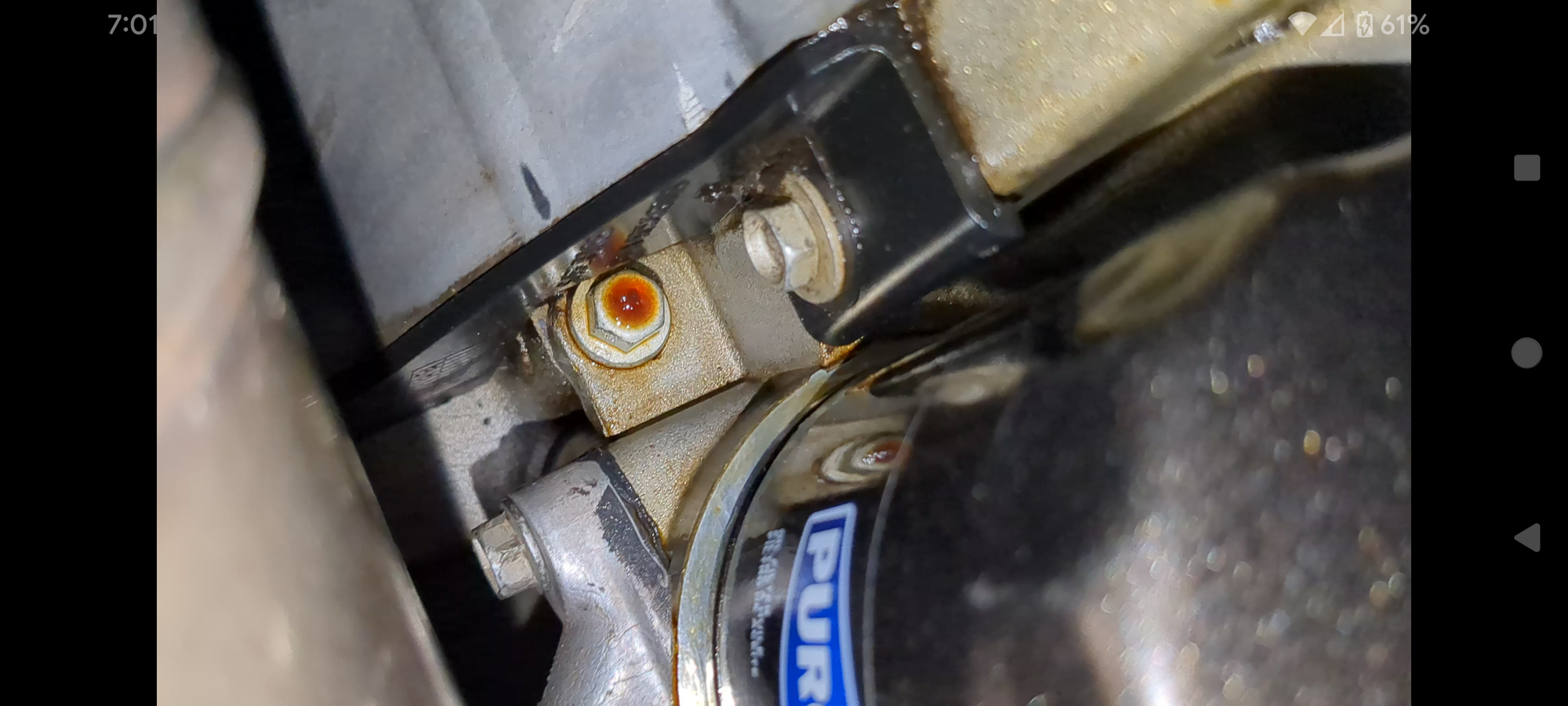

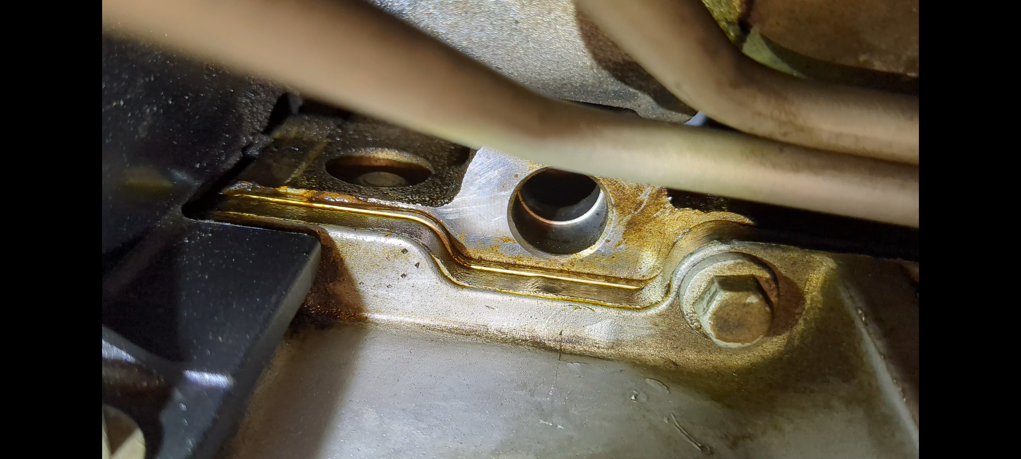

Just bought this low mile Ws6, it leaks oil. So far I've done all of the top end gaskets. Valve cover, valley cover, cam sensor and oil pressure sender. I also have replaced the oil cooler cover. So, it's basically either the rear main, rear main cover or the oil pan? It has oil dripping from rear oil pan bolts, NO oil dripping from starter🤷 So basically I just need to pull the engine ? Thanks
Passenger side rear corner of pan.
Driver's side rear corner of pan.

Looks like you've narrowed it down.

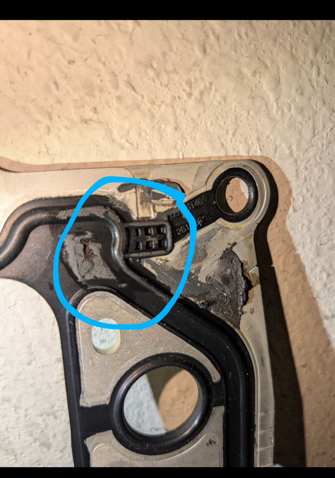

So, I bought a new rear main cover as every suggest. The matching marks have me concerned. Do you think this will leak? It's the bottom edge of rear main cover.
Old Mar 18, 2025 | 08:12 PM
the_merv's Avatar
Veteran: Air Force
iTrader: (88)
Joined: Mar 2006
Posts: 21,019
Likes: 893
From: The Beach...
The procedure is a dab of RTV in each bottom corner where the Gaskets meet.
That looks a little more than what I've seen on them.
We said Rear Main SEAL so not sure where you got a new Rear Cover out of that..

When I first asked I was as trying to evaluate the best mode of attack but quickly realized I may as well do the pan and rear main. Got it apart and the rear main itself is original and not leaking, the cover was leaking a little and the pan gasket was the culprit.
Reasoning behind the cover is that I've read they redesigned the rear main seal a few times, the last seal is ALOT thinner than the original, so it'll set further back in the original cover, which isn't a problem I'm sure. I also read that the new cover is an "improved" version🤷 I may just use the original, it didn't seem to have any porosity issues. Hell, the car only has 39k miles.
Also, I bought the new thinner rear main seal as I'm not reinstalling the original seal, although it wasn't leaking.

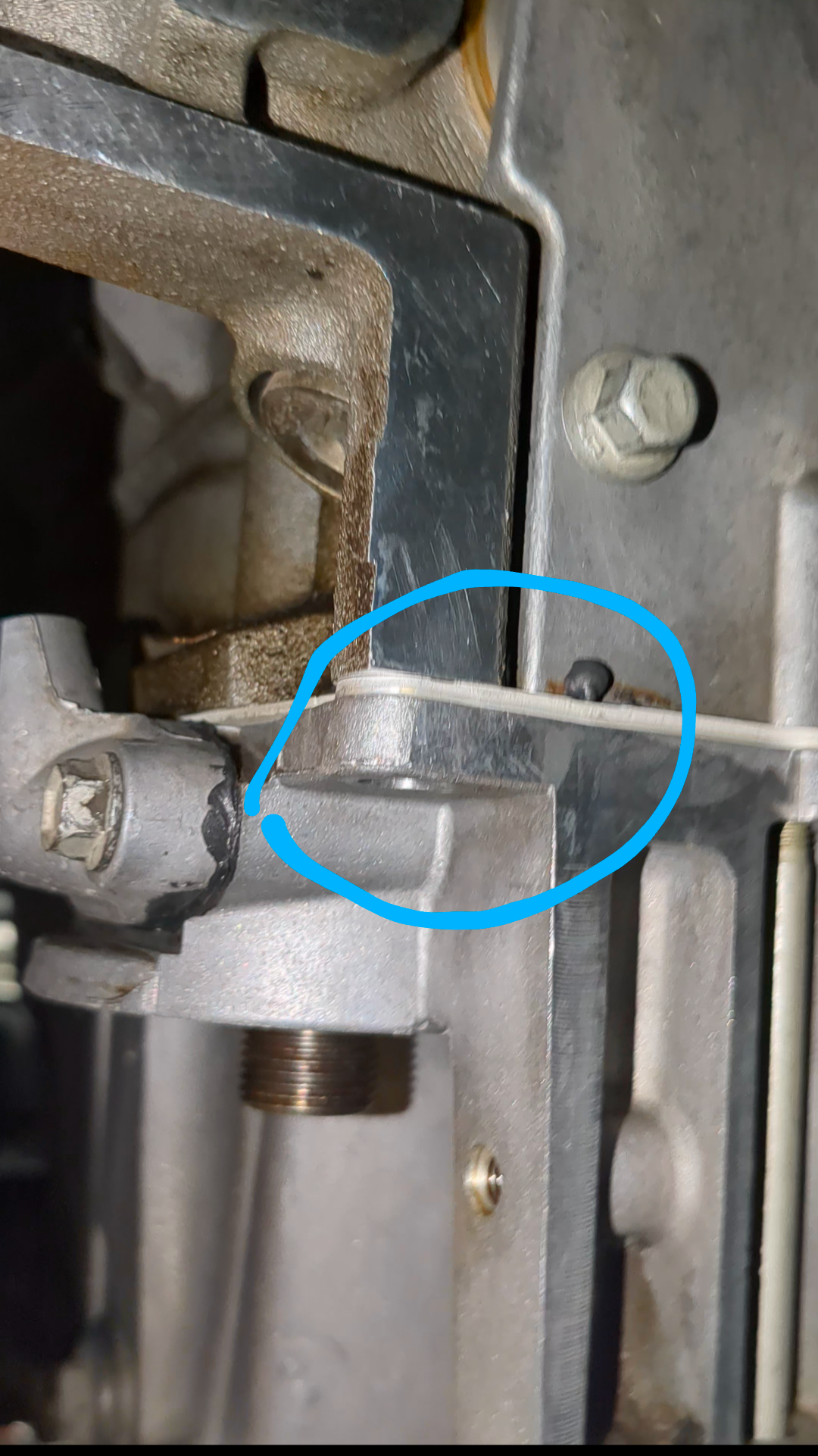

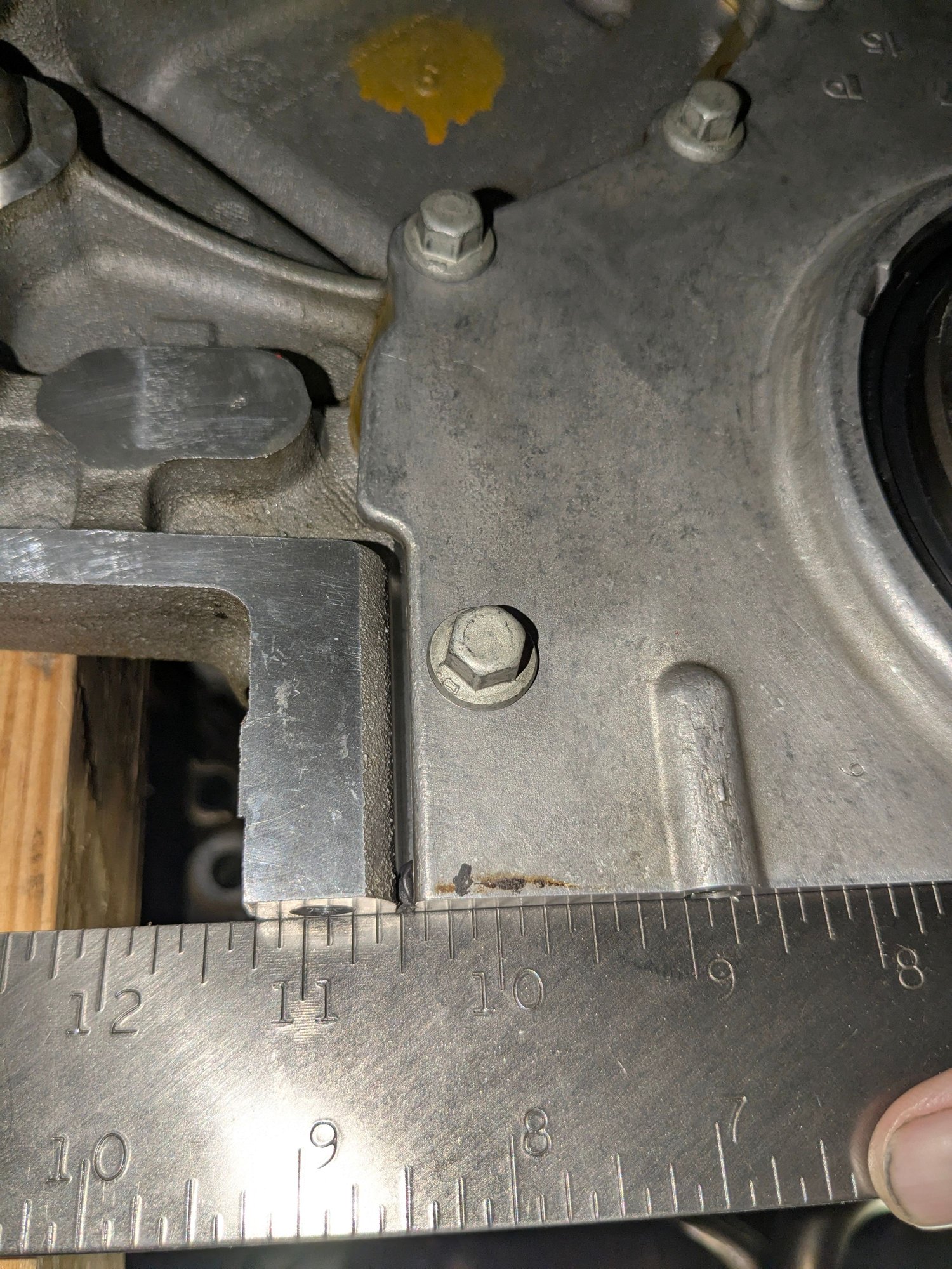

While installing the oil pan, the driver's side rear corner cracked. I torqued them all in stages and on the final 18ft lb pass I cracked the pan. I removed the pan and inspected the rear main cover and made sure it was flat, which all of it is, I used the rear main seal installer and made triple sure everything was aligned.
The only things I can think that may have caused this, torque wrench is wrong. Second possibility, I noticed their is the embossed rubber further inboard that the bolt, it seems that raises the pan, and when torquing it allows the pan to flex and snap🤷 You'd think the rubber would compress. Also, maybe I let the silicone dry too long while I was aligning the pan bell housing plane? Anyone have an opinion as if love to avoid this on the next pan!
Cracked on that area of pan.
With gasket removed, it is straight as can be from cover to block, though it sure doesnt look like it in this pic!
With gasket removed, it is straight as can be from cover to block, though it sure doesn't look like it in this pic!

If it were mine I would either find a new pan or find someone to tig weld it. I had to have that done to a TH400 many years ago and it held up just fine.

the factory alignment tool locates the rear cover to block.....jus sayin

Yea idk what the issue is. I've already ordered another pan and I dam sure don't wanna do this again! Maybe I tried to torque it too much at once?
