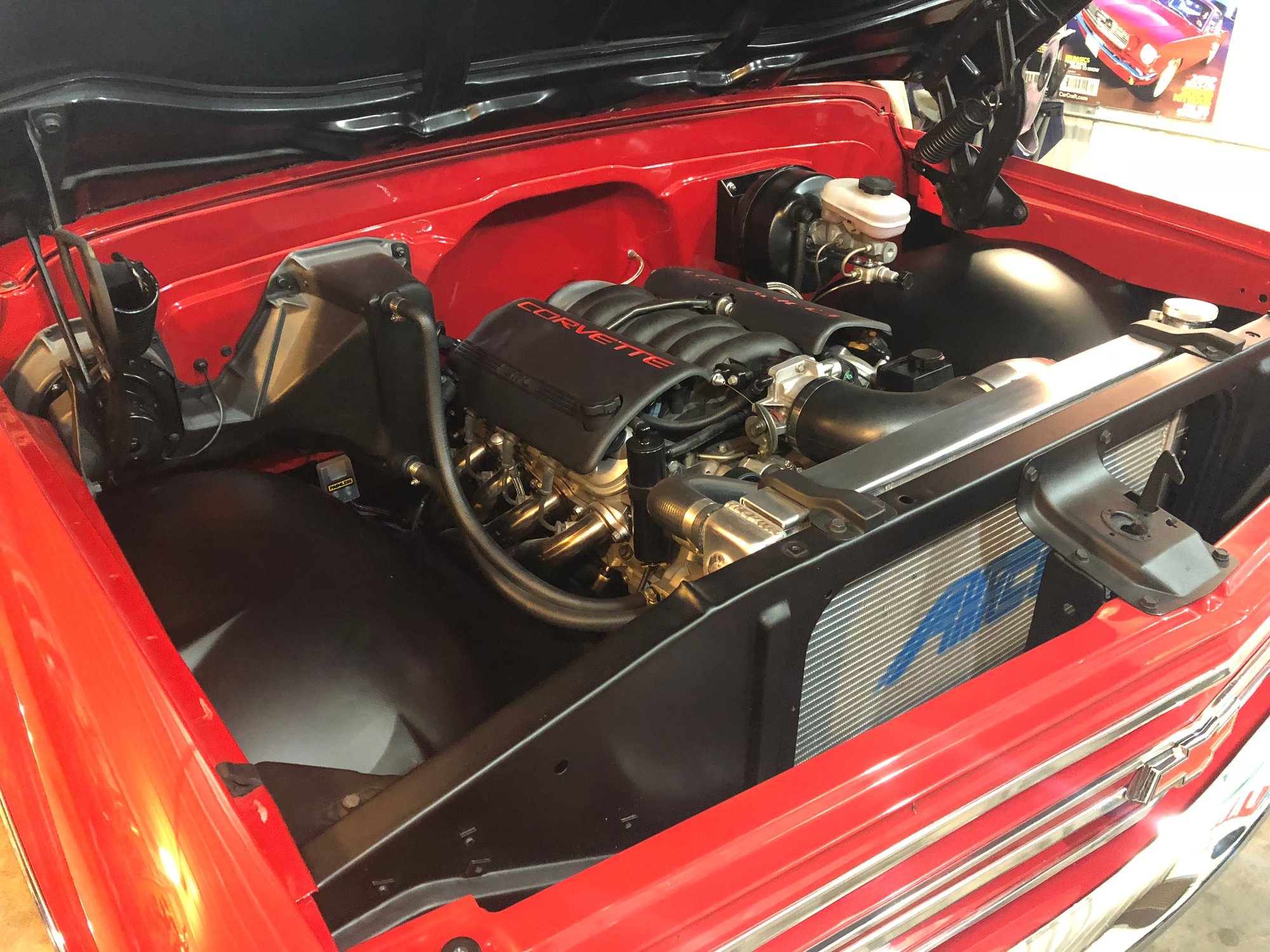

So on my LS swaps I'm too cheap to buy the big name direct fit radiators.
On 68 C10 LS6 project I used a generic LS rad from Afco. Biggest I could fit. Inlet and outlet on the right side of the rad. Single "16 Spal fan. Rad hoses from Oreilly's. Made pattern out of wire and they let me in the back room to search for what I need.

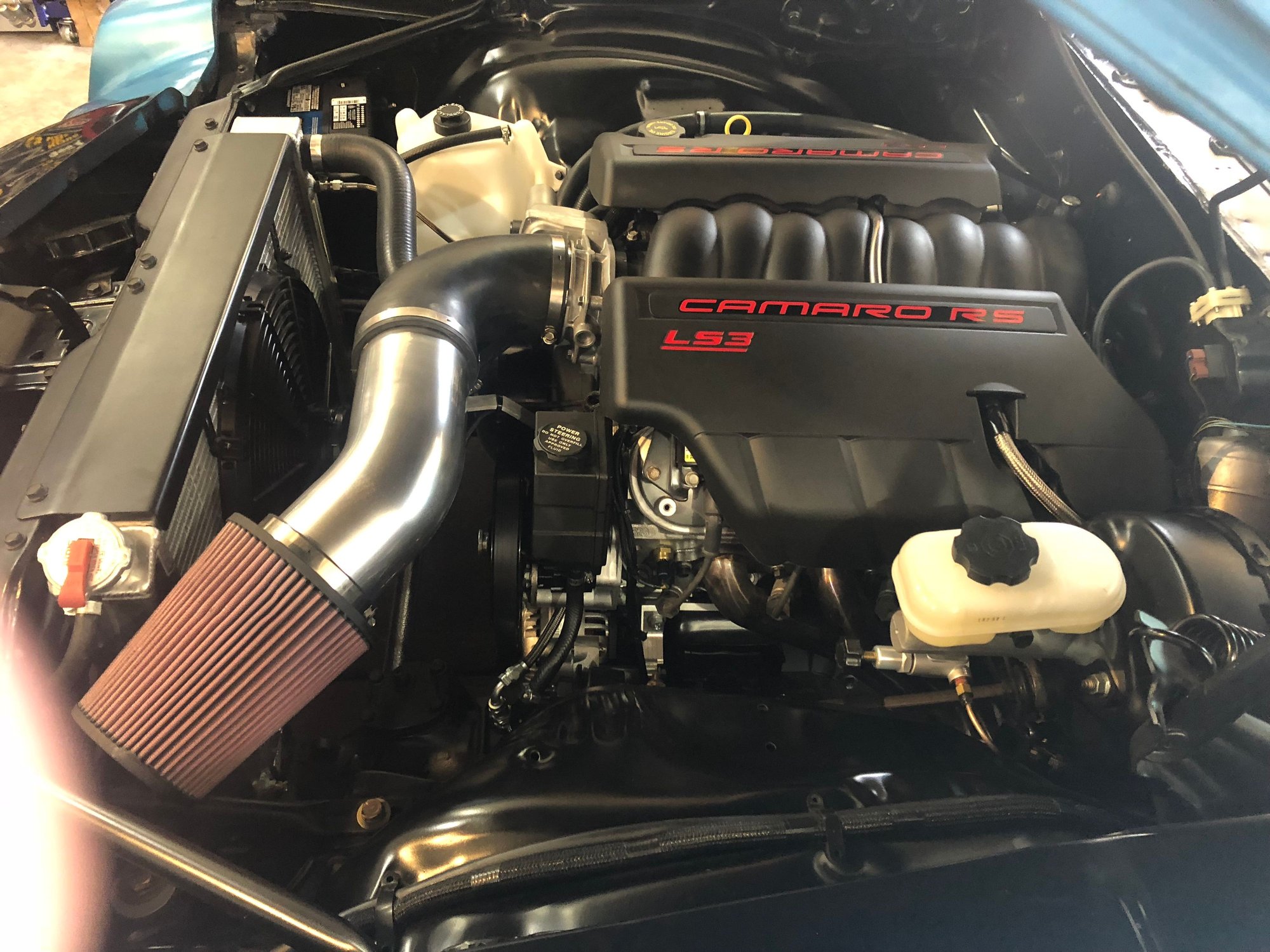

My current project is a 80 Camaro with a 6.2 swap. Used the biggest Be Cool generic LS rad and a single 16" Spal fan I could fit.
Both run cool in traffic. Fan on at 205 and off at 195.

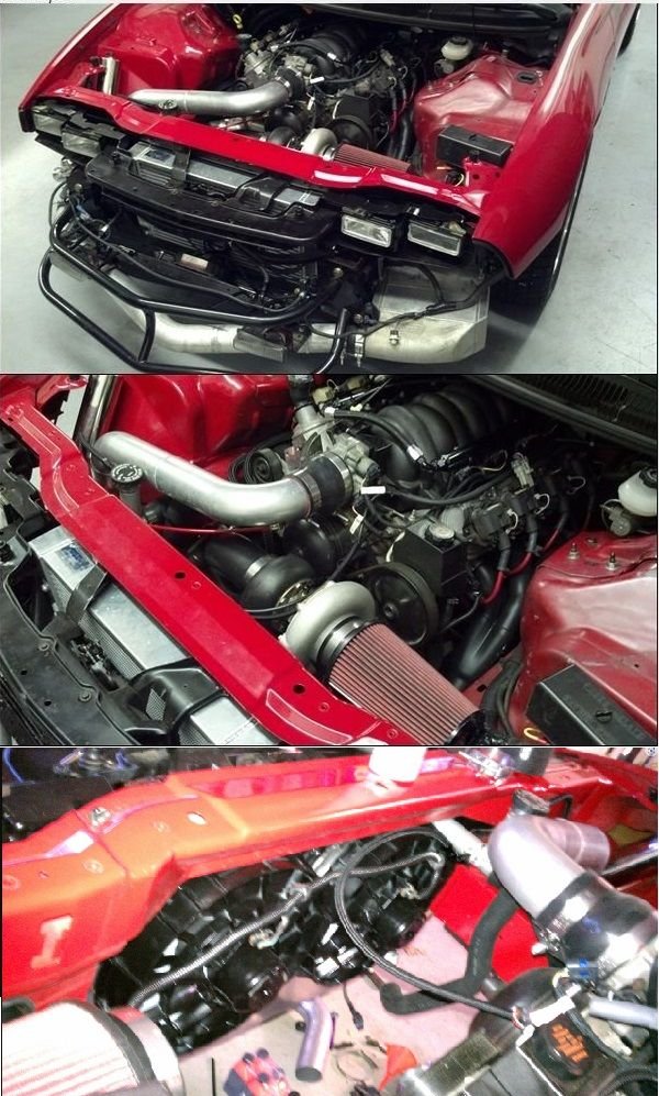

On the 4th gen turbo setups, everyone always does a griffin 27.50 x 15.5 setup and runs pushers because their T6 S400 style turbo is too big to enable pullers to be ran.
That's great and all but PWM brushless pullers like the C7 14" fan and the 2017+ Chevy Volt 12" fans move far more air and offer much better cooling.
I saw one setup where the rad was 13" tall but only 21.5" wide using an AFCO 80104N which allows the rad to be pushed forward more, right against the hood release mechanism which isn't possible with a 15" tall rad (unless you cut the bottom rad support out and drop it down, supporting it from the sides) Pushing a 13" closer away from the engine enables plenty of clearance for a pair of 12" pullers.
I've searched Summit's website with the criteria I'm looking for, but has anyone come across a rad that is 13" tall x 27-28" or so that is a crossflow 2 row with inlet/outlet both on the pass side and a steam vent hook up?
This would be perfect for mounting a pair of Volt 12" fans and a custom shroud without having to cut that much.
I'm sure a custom shroud would accommodate the 80104N to run dual 12" pullers, but if there's a longer rad that fits might as well get it.
Note the amount of clearance above to run pullers vs this 15" 1-58241-XLS Griffin setup:
