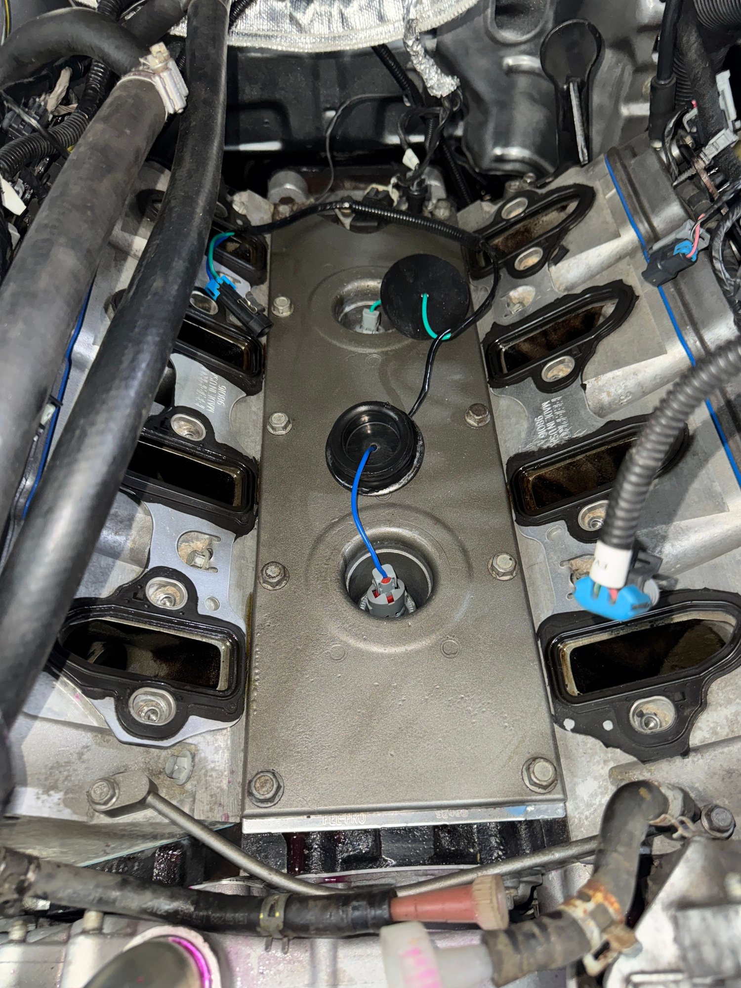

I pulled the intake back off, and checked the sensors, I loosened and retorqued the knock sensors at 11 ft/lbs. I have seen 11 and 15.....but too much causes issues. I have heard if they are dropped or mishandled they have problems, but like I said, they check out with a multimeter.

Intake came back off, double checked the new Knock sensors and harness

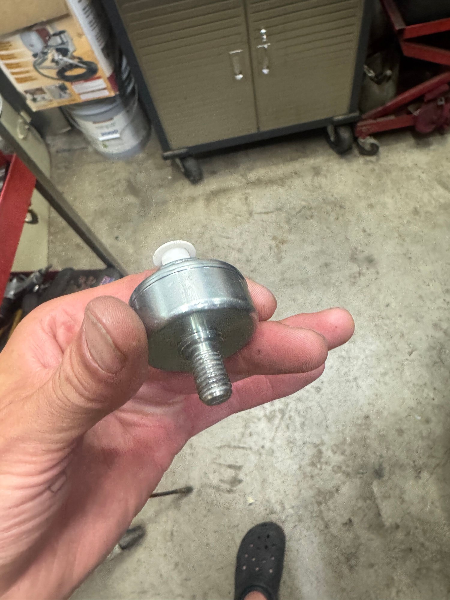

New OEM AC Delco Knock Sensors...could they be knock offs?

I went through this same issue on my C5Z.
It seems the Delco Sensors, Delphi, and Dorman all do not output ENOUGH voltage and it believes the sensors failed. I tried them straight from the Dealer, Summit, Parts stores etc.
It got to a point after two I tested my one good knock sensor with a vice, hammer (to hit the vice), and a Volt Meter to measure things instead of installing them and having to redo it.
Well turns out NAPA Parts has the only good sensors I could find
Link Here the Part # is ECHDKS238
No Knock Sensor issues in 20k miles since I installed them in early 2024.

thanks man, yea I think that’s it! I got a second set of AC Delco sensors from summit & they fixed it. I’m gonna screen shot this and keep those Napa part numbers handy but crossing my fingers that I’ll be good for a while, it’s been running good. I’m just going to disable the CEL for the stray 5v ref low, everything else is working.
