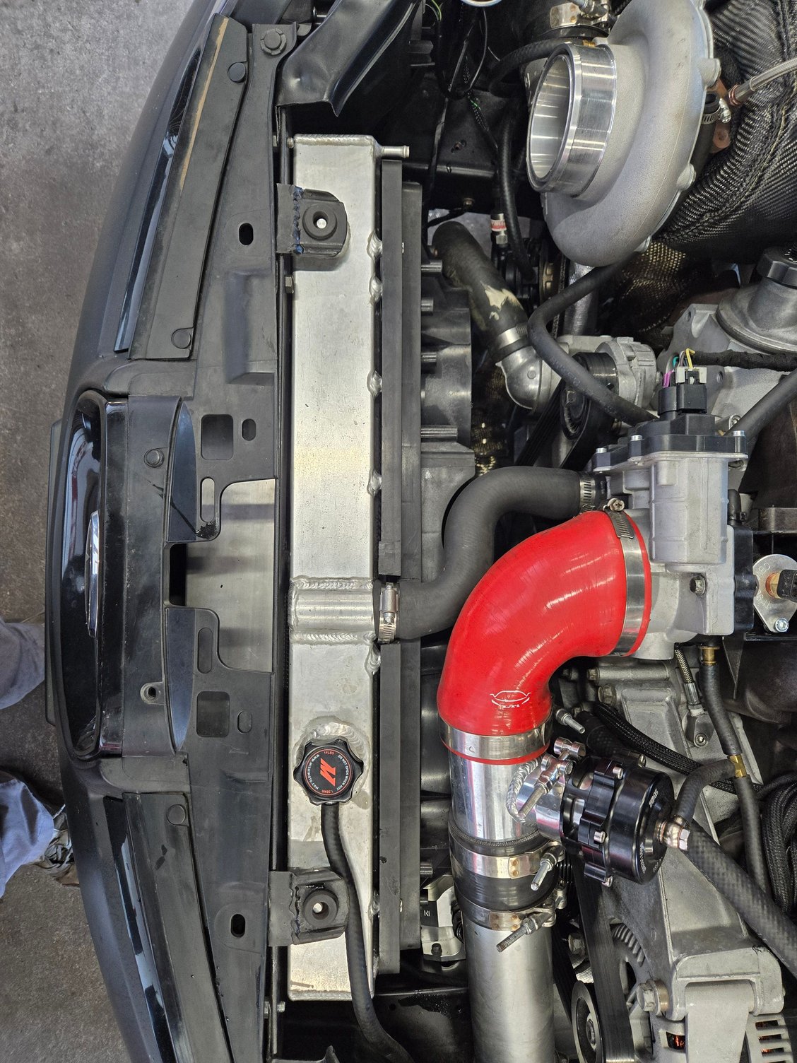

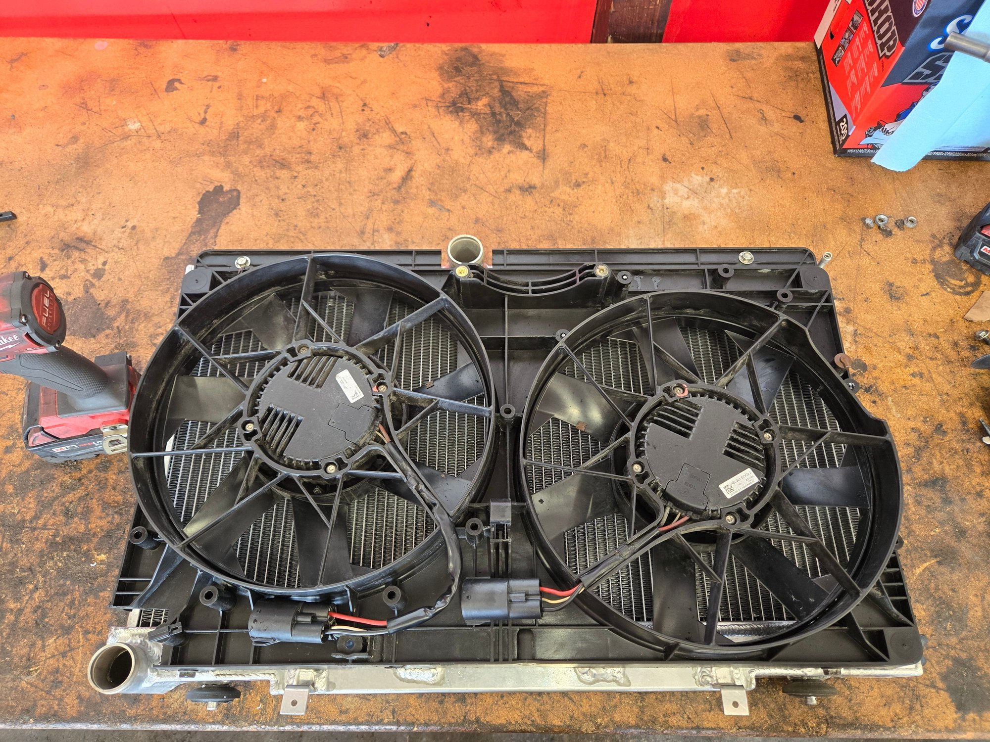

A brushless fan setup would fix all your issues...you can get some cheap from the scrap yard and control them with a cheap pwm generator off amazon. My swap ran hot with some mishimoto craptacular fans in traffic. Now I can keep the thermostat closed if I wanted too... I have it set so it stays around 210ish and the fans only run for maybe a minute at a time
Do you have pics of the setup?

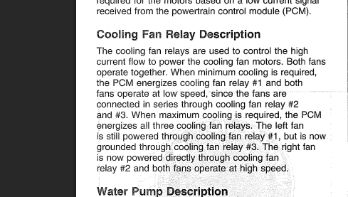

im thinking maybe im only getting low speed. From what I'm reading here this is how the factory ls1 system works
Stage 1, both fans low speed through relay 1
Stage 2, both fans high speed. Fan 1 is only relay 1, fan 2 is relay 2 and 3.
So in theory if i command fan 1 both fans should work.

If ypur fans dont run with realy #1 on then either fan relay #3 is bad or the circuit between relay #3 and fan #2 is faulty.
They are ran in series this way giving you low speed.
If the other relays are activated and both fans are running that is indeed high speed as they are now in parallel.

Bbknucks's Avatar
Joined: Dec 2022
Posts: 444
Likes: 158
Here is that fan setup in my subaru and compared to the mishimoto fans that were in it

It sounds like my low speed is broke, but my high speed is working fine. Not really gonna solve my overheating issue as my high speed is commanded to come on 5 degrees hotter than my low side(Fan one is set to come on at 185 and fan 2 comes on at 188 in hptuners.).
Im still going to fix the low side cause its broke though.
dang those brushless fans look meaty

Solved my low speed fan issue. Looks like relay 3 was bad and not wanting to switch on and off.
