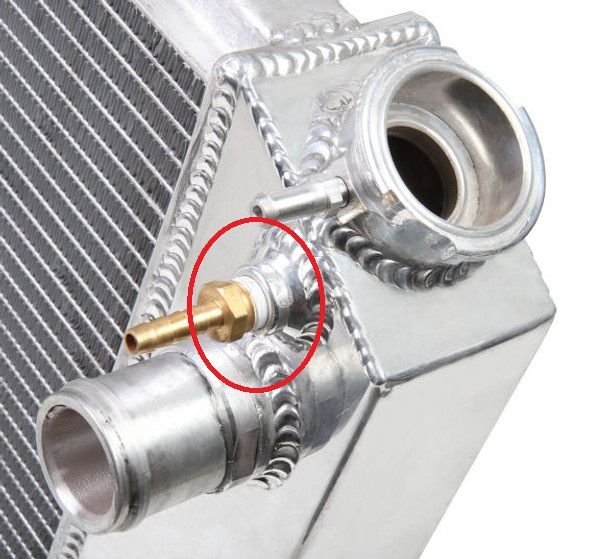

Just a question. With the rad pic above what's up with the two inlets?
