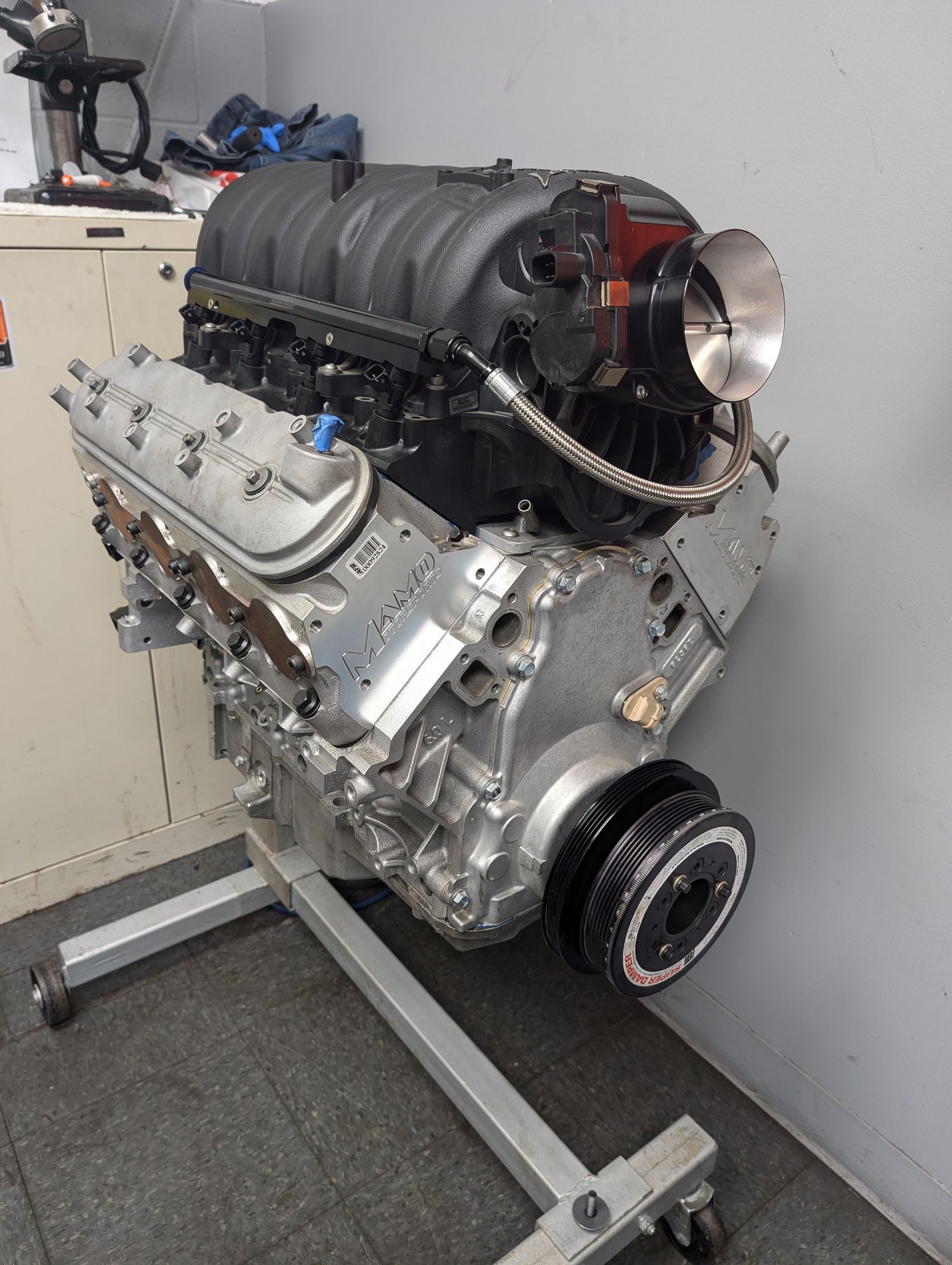

I might’ve misunderstood the instructions with installing my LSXRT intake I used flexible steam lines that go under the intake I haven’t anyone else do that. I used the kit below. I’m just wondering if anyone else has used steam line like this with the LSXRT intake or if I need to use a different kit.

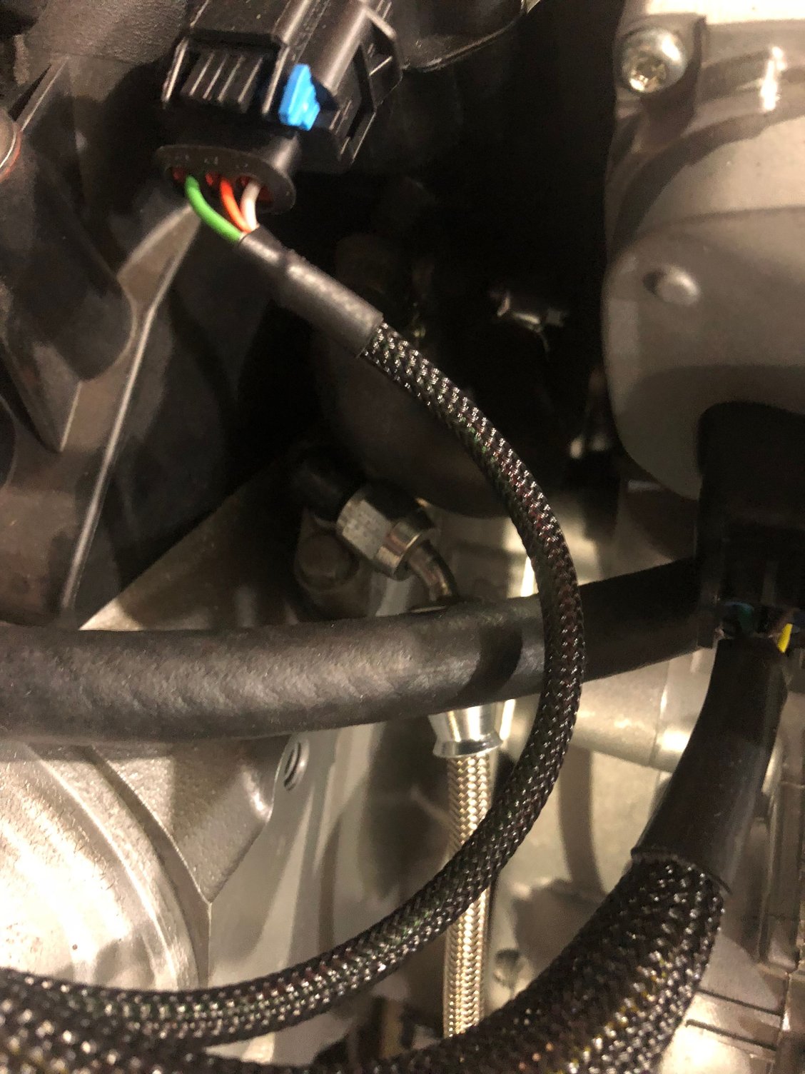

On my last couple of LS swaps with L92's and LS3 intakes I just use the stock two front steam ports. Same as stock. Never have had any engine heating issues.
I do drill and tap the left block for 1/8" NPT and -3 AN fittings. Then run -3 up to to a port on the right side of the radiator.
Couple of pics.

Called ICT they said it should work because it’s a low profile and flexible lines I did also use the ICT flat valley cover and flat bolts. Let’s just hope for the best. If gives me any temp issues later on, I’ll change it.
