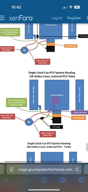

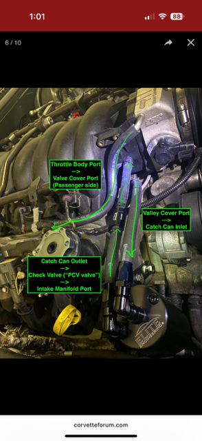

While fixing some issues I found oil in the intake. I have an ls1 and had been running a ls6 valley cover with no external PCV or catch can. Based on the oil, I am adding both back in. I have been searching and searching and found many diagrams that seem to contradict each other (maybe I am misreading). Is it me or do the following two diagrams/pics showing very different routing? Can someone let me know the correct routing? Thanks!

Bottom diagram is for LS6 valley cover. Top diagram is for standard LS1 pcv config
