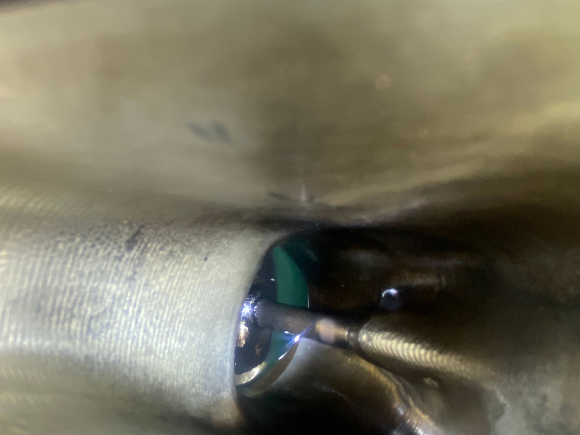

ok cool just pulled the intake again and I see gas sitting on #2 intake valve. There’s no sign of a vacuum leak anywhere on the heads or intake.

You said you cleaned the injectors? How? I can almost guarantee you have a piece of debris holding an injector open. I clean mine by using a cheap amazon injector tester, sticking them in a bowl of Berryman's, and cycling the injector while pulling a vacuum on the top so the fluid flows backwards though the injector. If it's not an injector and your EVAP purge is still hooked up, I'd check the hose for fuel. If your canister somehow got saturated with fuel, that could cause this as well.

Well, if you pulled the intake and that valve had fuel on it, I'd suspect that injector was acting up. It may open, but it might stick on closing due to debris in the injector and it ends up adding too much fuel. That would explain the stumble, but not the fact that it's worse when it gets wet. If I were you, I'd swap injectors and see if the problem follows the injector or not. If it doesn't, I'd be digging into the wiring harness and looking for frayed wires.
