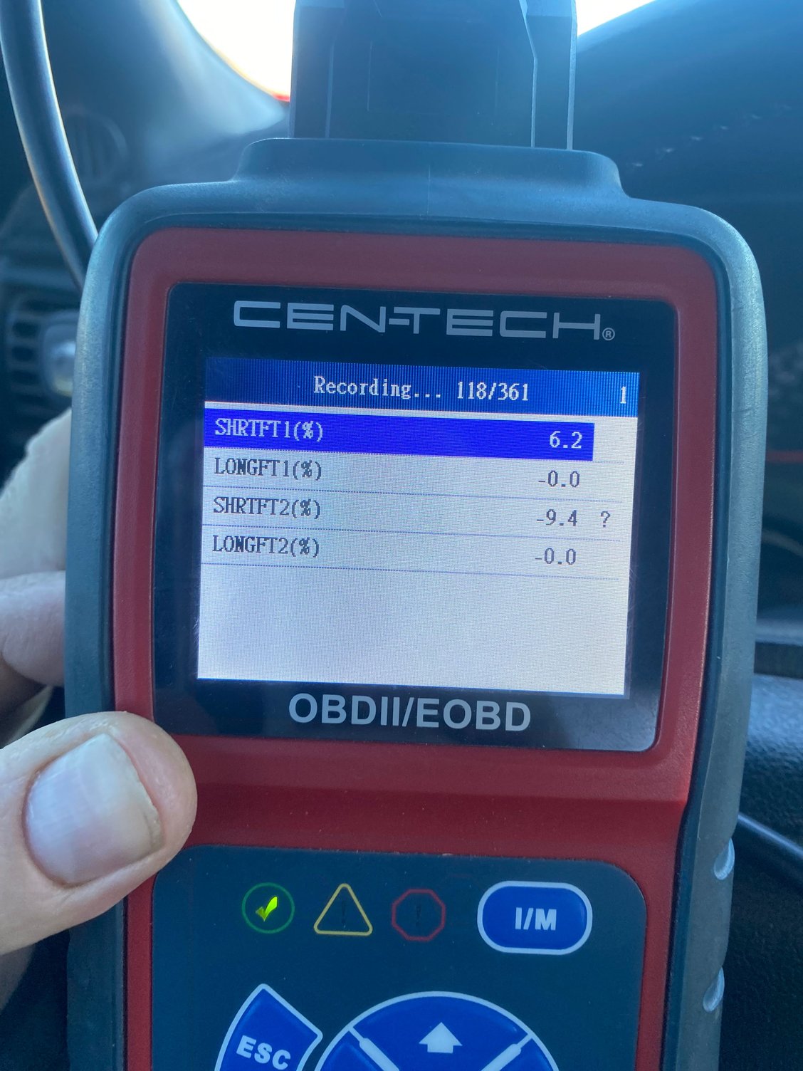

Of course the stupid car runs perfect today. I recorded the data I have no idea how to read it. Let me see if I can post the video.
Go figure the video is too big even on the smallest setting I can only put one

I’m going to take someone with me and record the data in a real quick video so I can post it.

Are the long terms turned off? That's lame

I guess so they didn’t come off zero the whole drive. I’m assuming those are supposed to be off since it’s a hci car and no cats.

16% difference in short term side to side is pretty big.
What did the old plugs look like? Im guessing a leaky injector on the passenger side and one plug will be more black.

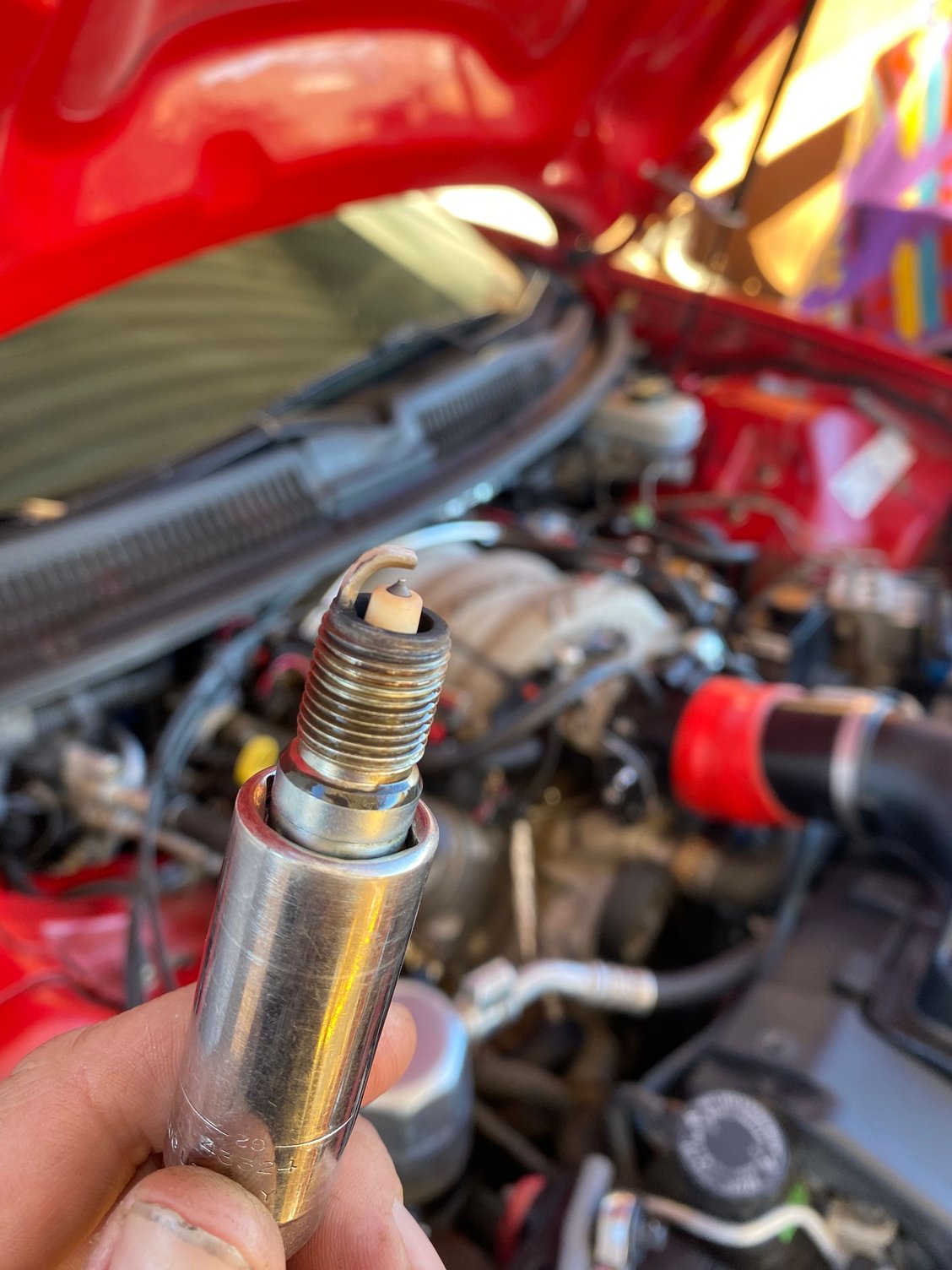

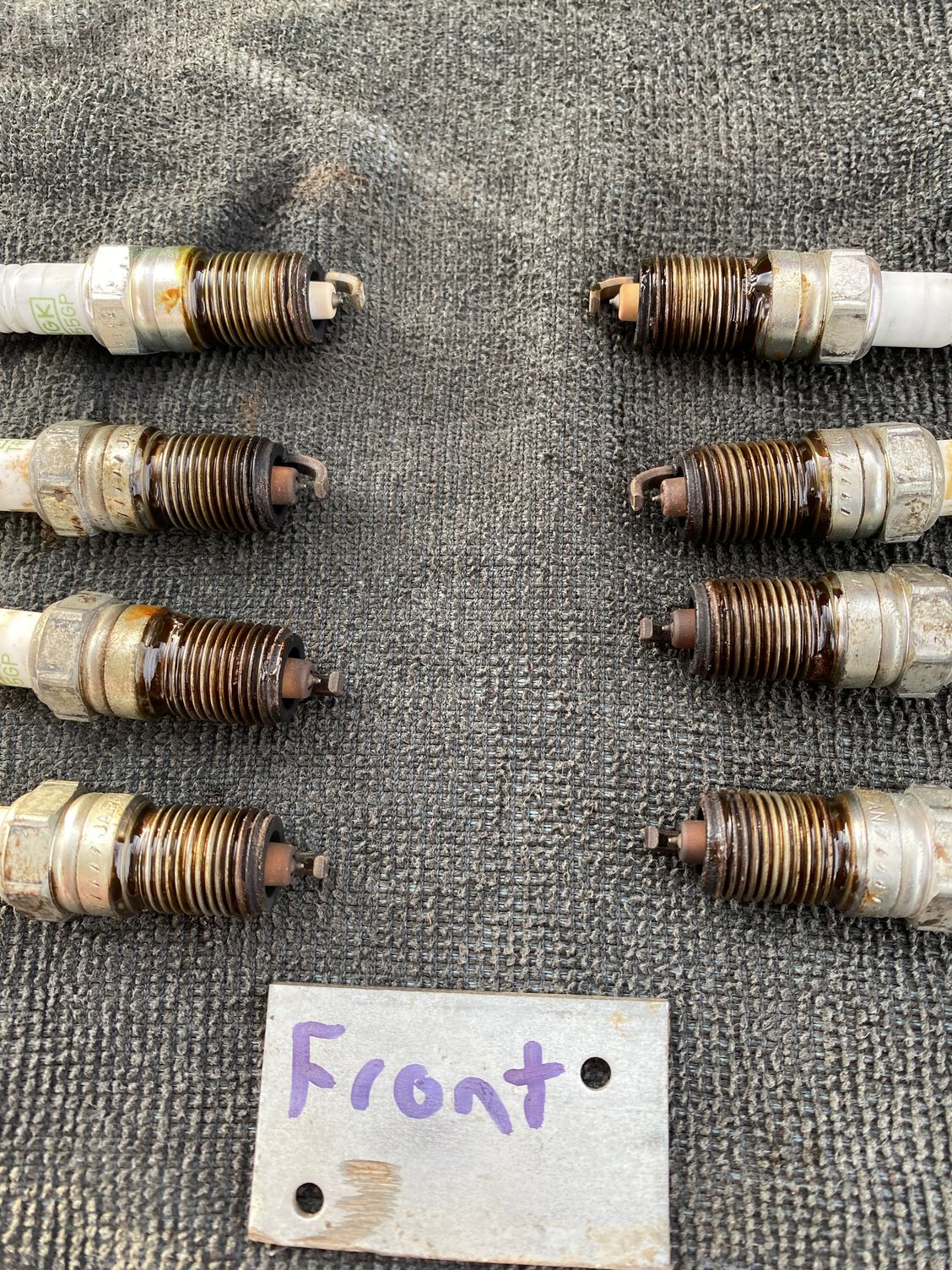

I’ll pull the plugs and get back to you with pictures.
both rear plugs are running lean.

I'd be a bit concerned about that oil on the plugs.
it’s anti seize

Do not put anti seize on NGK plugs. That’s per NGK data. Anti seize will actually hurt performance fwiw. The plugs need as good a ground as possible. Anti-seize hurts the ground path. We did a lot of testing on this 30+ years ago.

good to know I’ll clean it off
I would be so bold as to say the opposite. The back 2 look normal, the rest look like a dirty/weak spark.
I agree here with Kubs. Unless this is a boosted build, your rear plugs look good, and the front 6 are reading very rich.

It does run rich where I’m at. Car is tuned for Phoenix which is about 1000ft elevation. I’m northern Arizona at 5000ft elevation. Should I start with a fresh set of plugs and re check them?

Ok I guess my plugs are just junk I moved the two that looked ok to the front and drove it for a while then pulled them back out they still look good.
