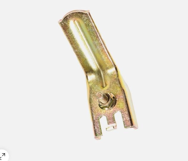

I guess we should have thought to look up what the OEM hangers looked like. Stock system has been replaced a few times with aftermarket components and muffler shop cobble ups. OEM hangar is long gone.
This is what was there last:
Looks like we need one of these now to bolt up to the TSP tab:
Thanks!
