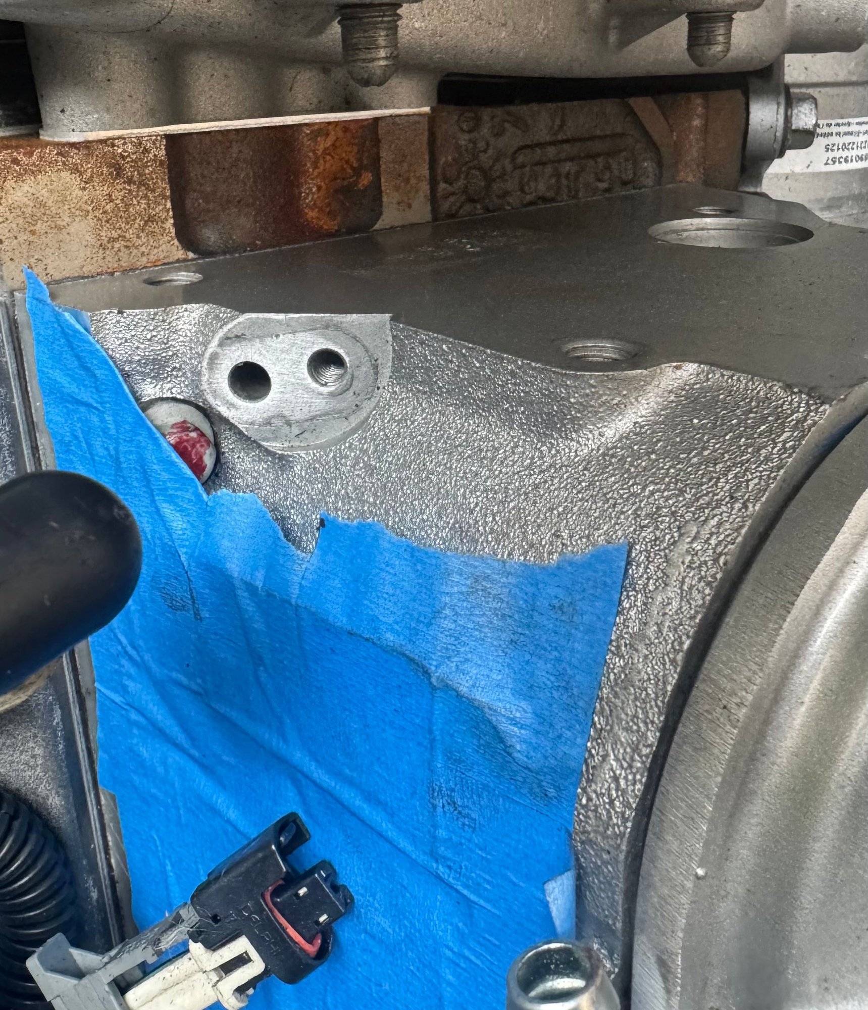

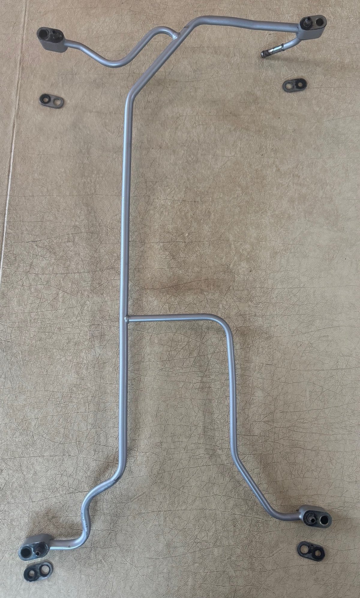

There is a vent pipe that connects vents at the front and back of both heads (pictured). There is a small gasket under each connection.
Does anyone know if these gaskets still available?
Has anyone re-used their old gaskets? Mine have 317,000 miles on them.
Has anyone used a different type of gasket?
Has anyone run without the gaskets?

That's the coolant steam vent tube. Gaskets are widely available at parts stores, Summit/Jeg's, speed shops, etc., and also come in head sets.
You could try https://www.autozone.com/p/dorman-co...t-56390/884421

RB04Av, if you're going to use only 2 vents, I agree on using the front two vents only. In fact, my LS7 heads had the 2 rear vents plugged with that rivet type plug when I bought them, forcing me to use only the front two vents......

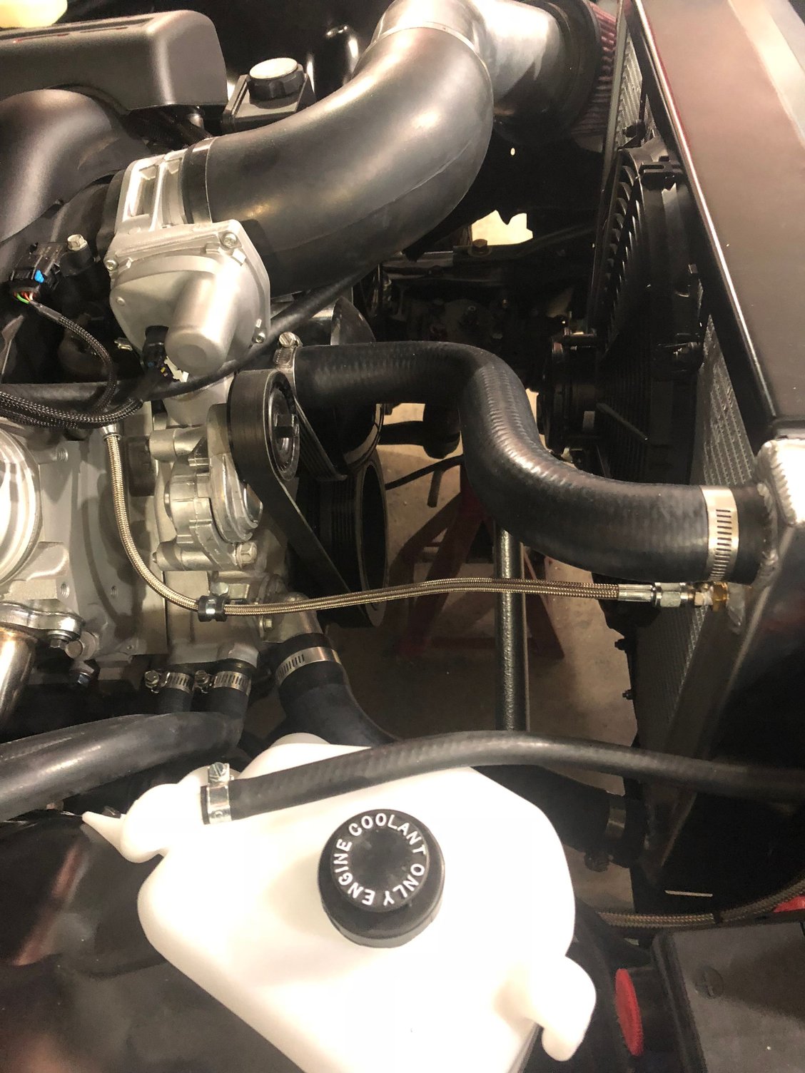

The last two L92's I swapped into to a 73 Camaro and my current 80 Camaro project only have the front two cylinder head vents. Never had an issue with over heating.
One thing I do to connect the crossover tube to the radiator is use -3 brake line. You can buy it pre-made to length. I cut off the nipple and drill and tap it for 1/8" NPT. Using -3 AN fittings I attach it the radiator after welding a bung into the radiator.
Pic.

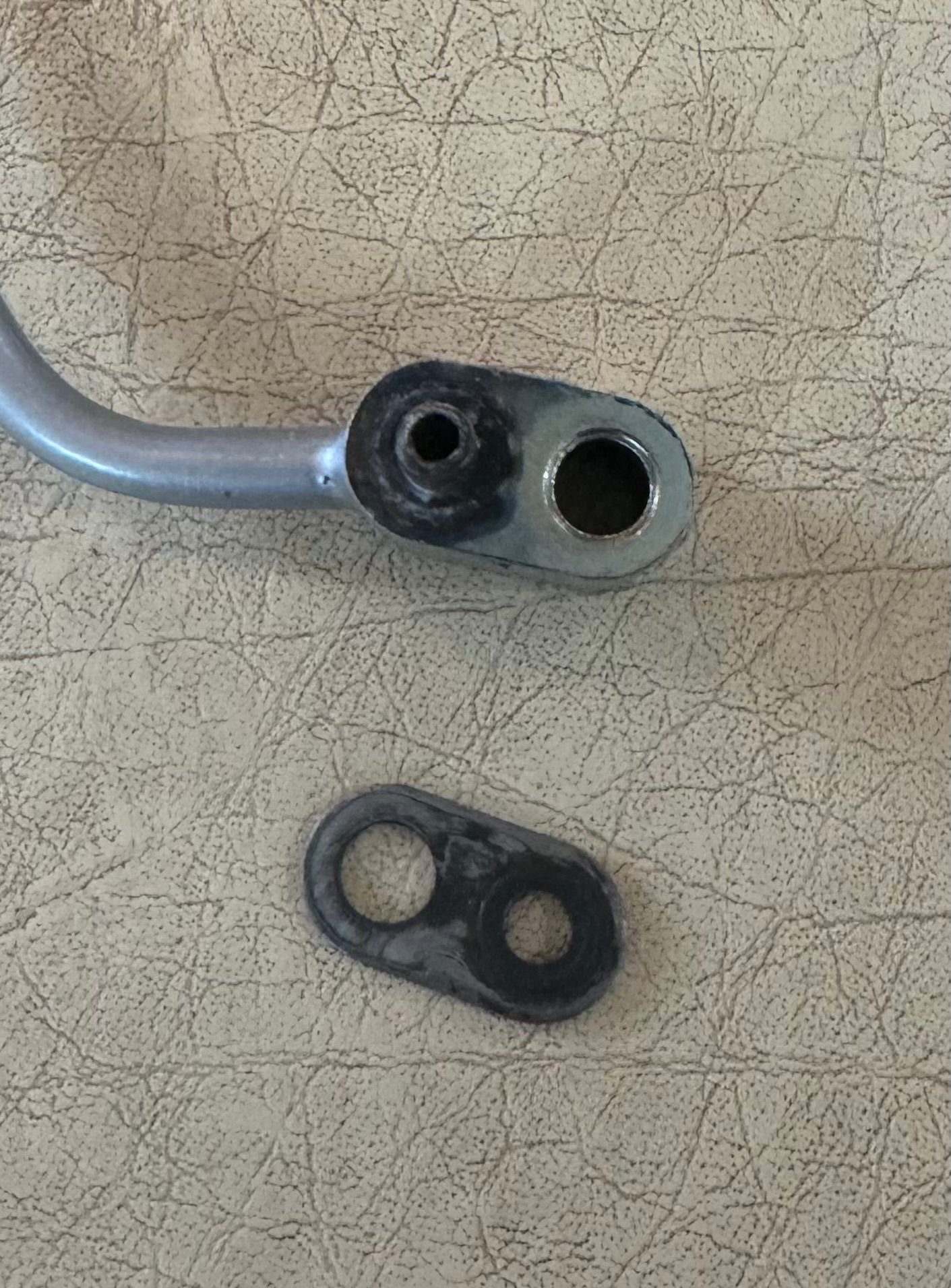

take note....the old style does take the gaskets....the new style takes O rings

‘They all use o-rings, at least all I’ve ever been in, both Gen3 and Gen4. The Dorman aluminum plate gasket seals linked above, work well as replacements for all of them. I keep packs of these in the shop. No need to try and remove the old flattened o-ring, just install the Dorman piece between the head and steam vents and keep going.

Yup I have a bunch of them as well as an extra Steam Tube that goes to all 4 corners of the Heads.
Agreed. I've never seen gasket material gaskets on the steam vents. My 2000 C5 had the aluminum plate with integral O-ring type setup, much like the oil pan gasket, but on a much smaller scale......

Yup, looks like that's what the OP has too. The little plate type gasket with a rubber insert. Just going by the pics of course, butt as always, I could be wrong. (and even mistaken on this particular point, besides just being my usual wRong)
Later 5.3s and whatnot all used only the 2 front ports, and didn't have that big Thing all running around under the intake.

Yup. All the ones I've ever seen were the flat Aluminum Plate there with rubber embossed.

lol.....you mean to say the old style uses a O ring in the gasket....new style uses just a O ring....the new style may take the gasket.....never tried that but may work

The type that only use an o ring also have a groove for the o ring. The older type with the metal embossed o ring will be flat as the gasket takes up the spacing and locates the o ring.
