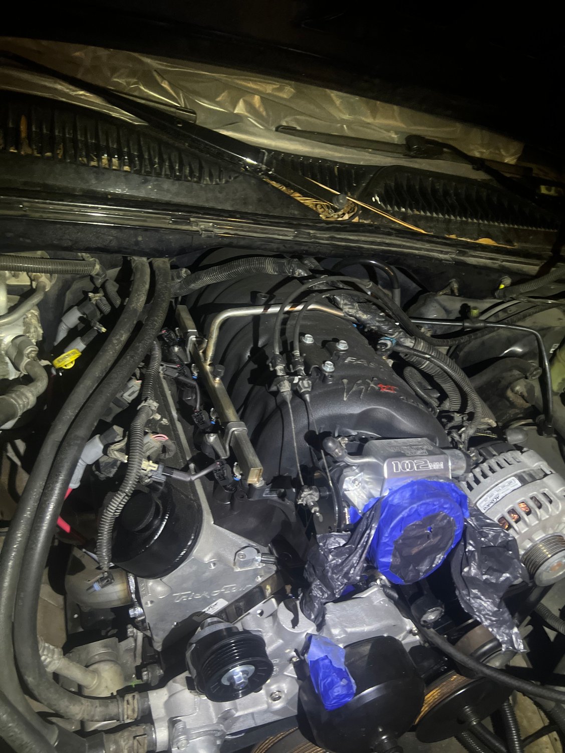

So I had put a LS1 Waterpump on my GMT800 in order to clear my LSXRT intake and 102mm Throttle body I just need help in figuring out the best route to go from 32mm from the water pump to the 35mm upper radiator.

I want to say they make silicone sleeves you could put over the water pump outlet to make up the clearance, but I'm not sure.

gates molded hose catalog. they have detailed dimensions
Every engine swap I do starts there. then I find the hose or two that are the closest. I used to have a contact at Gates to get the actual hose drawings, however that was 2 decades ago.

On my LS swaps I make a wire pattern for the hoses upper and lower hose and then go down to the local Oreilly's back room stock of radiator hoses. I shoot for the closest shape and then ID of the hose needed.
You may have to buy a weird shaped hose to get what you need ID wise and cut it as needed.
In lieu of that they make alum splices so you can join two different ID or shape hoses.
