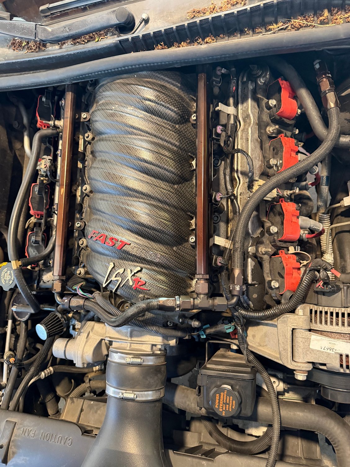

Can anyone tell me by looking at it what Throttle body is likely to be on this?

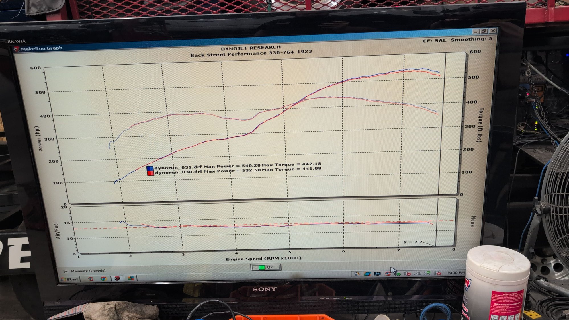

For anyone thats curious, the 102mm I had for my C5 didnt work at first. I tried both a Summit brand and a Trick Flow that had different internals. Same story. The C5 is incredibly picky on TPS voltage, but these werent even communicating with the pedal and going into REP.
I ended up having to switch the +5v reference and ground pins on the adapter harness for the TB to work.
On the dyno, the 102mm was worth +8hp over the stock LS3 90mm.

Nice data! So once it's pulling hard up high you CAN have some benefit. Good to know!

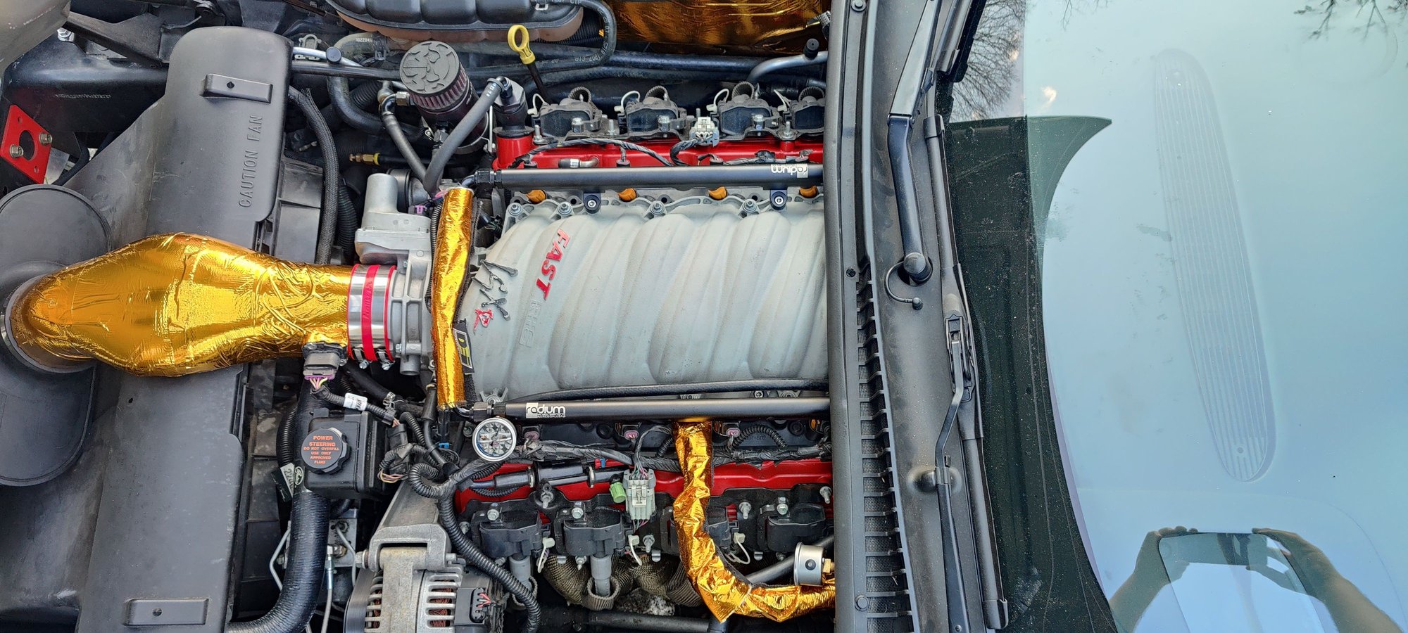

And there's a mechanical aspect to it as well. The GM throttle bodies start flowing air when the blade moves just a tiny bit. I have a Katech 103mm (which I'm told is a rebranded NW) and it doesn't even start to flow any air at all until the blade has moved a LOT further. So at cold starts, the NW throttle body is just barely flowing enough air for my car to idle while it's telling the TAC that throttle blade is 18% open... And 18% is all the TAC will allow at idle. So cold starts are crap, especially in the winter.
