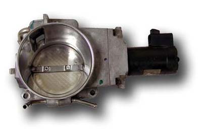

Well i just bought a ls6 zo6 throttle body that was ported and polished now what do i plug into the throttle body? since there no throttle cable?

What kind of a car are we talking about?
Covette throttle body will not work with a F-body.

2000 camaro ss ls1 i bought a ls6 intake manifold and ls6 ported throttle body its a etc throttle body like this one
put it up for sale.....thats a vette TB and like already stated wont work with an F-body

damn i was told it would work with an f-body
