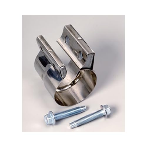

Band clamps are kind of expensive just for a drive to get it welded. I'd get a regular U type strap clamp from autozone or any parts store.
A band clamp is a bit much for a short drive
But thats just my opinion. Hell if you got band clamps you wouldn't need to have anything welded. Thats what I did with mine in the pic below.

Be sure to get the right ones, I almost got the wrong ones.
Got mine from summit. There are two types, one type joins two pipes of the same diameter. The other type goes over a slip joint, you can see the one in the pic above has a step in it.
In other words even though you might have two 3" pipes to join the clamp you get depends on whether one is slipped into the other or not.
Hope that makes sense.
