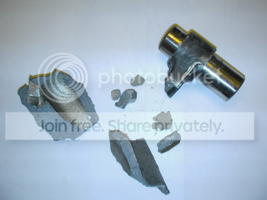

recently I made 2 dyno pulls on nitrous putting 600/591 to the wheels through my stalled auto with the stock bottom end. (made 452 N/A)
I took it to the track this past weekend and made 3 N/A passes then started spraying, it made 3 passes the fourth sent a rod through the side of the block. I would say the 550rwhp limit people are saying is a good idea. My last SS made probably 20+ passes on N2O at about a 560rwhp before i got rid of it. im guessing I was probably looking at close to 620rwhp had it been in a stick car.
