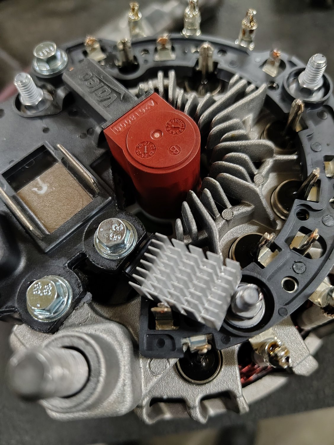

The car ran fine since I had it about 8 months..I've never unplugged the crank sensor,all I did was change the alternator cause the bearing was singing I ordered a new AC Delco an I changed the plugs to AC Delco they were ngk an new wires blue streak 8.5 mil.wires an as soon as I started it I had a prolong start an ck engine light.for knick sensor an cam sensor I changed the cam sensor still have the problem an I put in a brand new battery
This is what the back of the alternator looked like when I took the new one off the car an popped the plastic back cover off.that heat grid is laying on the stud an against the wired post it's not post to be there .I put the old one back on same problem they sent me a new one I haven't had time to change it back out yet.what ever it is the bad altinator caused it just don't no what

Just have to go back through and double check all the connections, I read you have knock sensor codes, did you wash the engine or get water under the intake manifold?
No haven't done any of that it's got to be the wire to computer that the cam sensor sends back or the computer is bad I'm gonna back probe all the wires from sensor to computer an see that's all I know to do at this point
