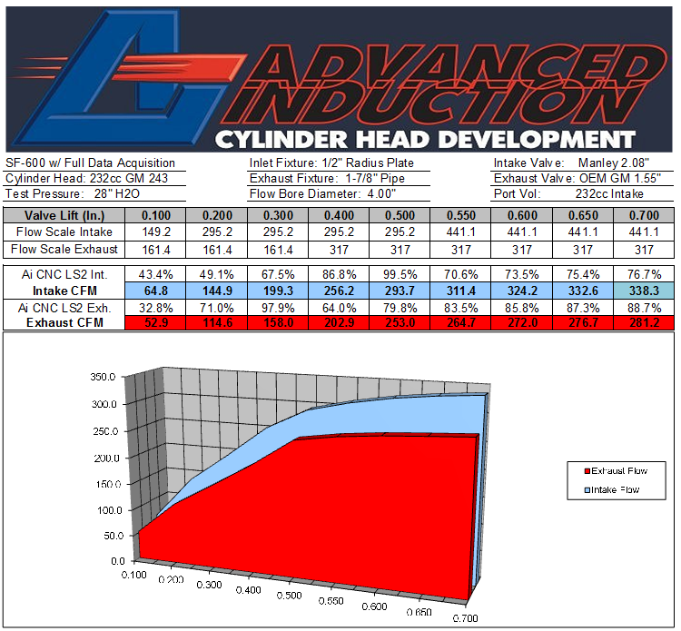

http://www.advancedinduction.com/Ima..._Flowsheet.png
He was unfortunately only able to fit 2.08" intake valves, but look at those mid lift flow numbers! Exhaust is extremely strong as well.
Looks like a winner to me!
If anyone is interested in this port/valve combination for a set of 243/799's they have contact me about them as I am a dealer for Ai and I can have this work done for you as well. Look at it as an "in between" for CNC stock casting heads and aftermarket "As Cast" or CNC cylinder heads.
2.08" Manley intake valves and 232cc port program is $1395.00. If you want to have a larger exhaust valve done as well for maximum gains from a stock casting head that can be worked out also.
awesome! let me know when you send them out to me.

These will actually flow even higher on your motor since you have a 4.030" bore as well. Not enough to really make a difference, but just FYI Phil flowed them on a 4.0" bore as you can see.
I know the wait will be worth it! I think these stock castings will give a set of as cast castings a run for their money.
