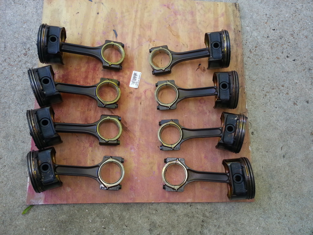

I pulled these pistons and rods out of an LQ4 that came from a wrecked '05 Silverado 2500. Can anyone definitively ID them as either pressed or floating? From the research I have done, they visually appear to be the pressed pin rods but I thought that all '05+ motors had floating pin rods? Thanks!

Definitely press fit as they don't have retaining clips.

Yep. Look like the old press fit style. No retaining clips in the pin boss means they're press fit.

That is what I was thinking. Thanks for the affirmation guys. Unfortunately no one is after these rods so I might as well turn them into some type of furniture.
