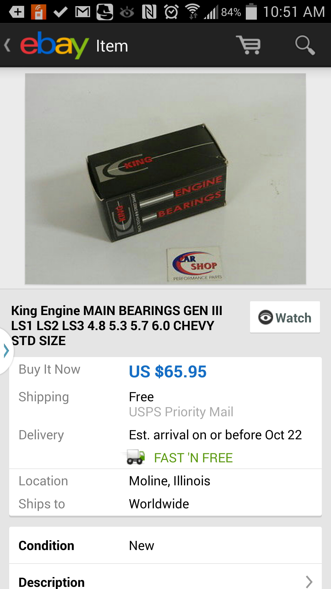

Would these work ?<br/>
Old Oct 17, 2014 | 11:59 AM
MMorgan9812's Avatar
Joined: Jul 2009
Posts: 188
From: Mars Hill, North Carolina
Yes and King makes a good bearing
