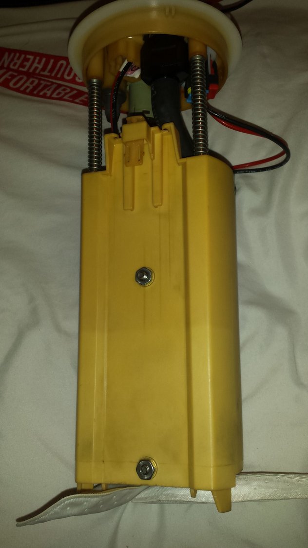

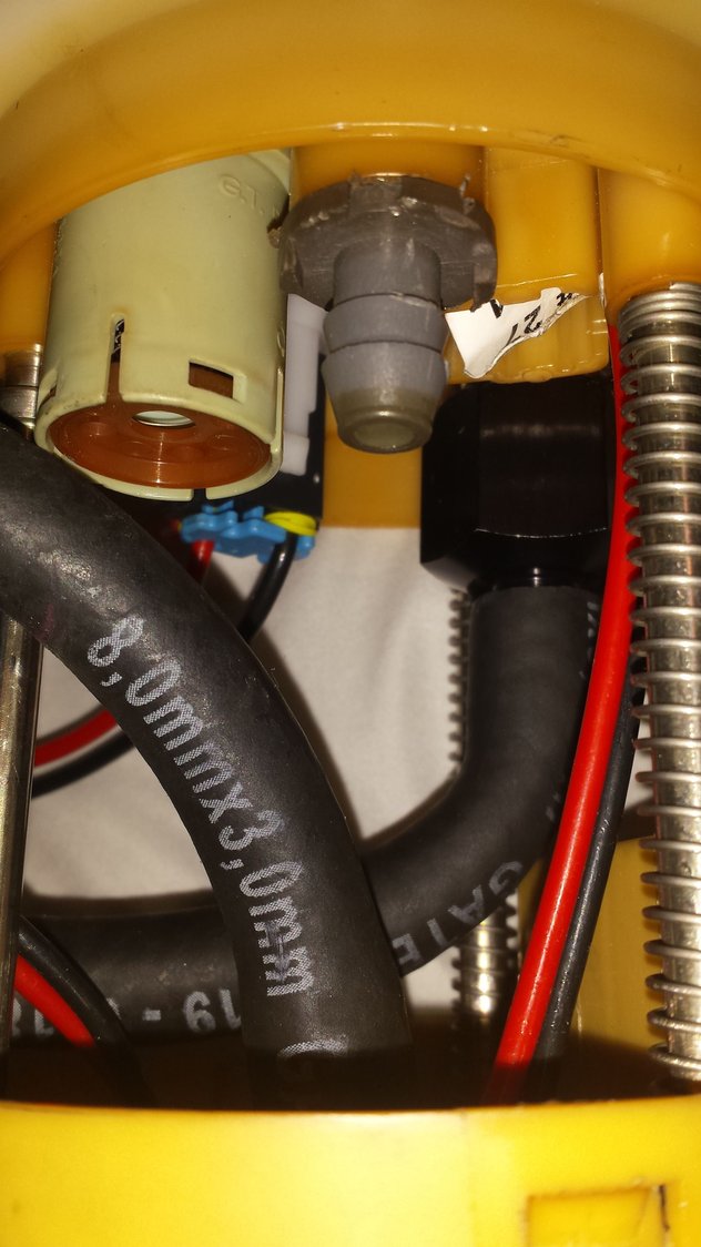

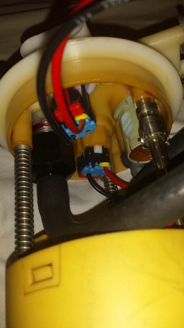

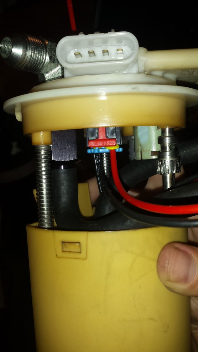

Made my first AN hose, haha.

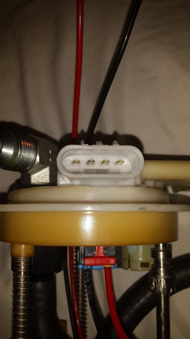

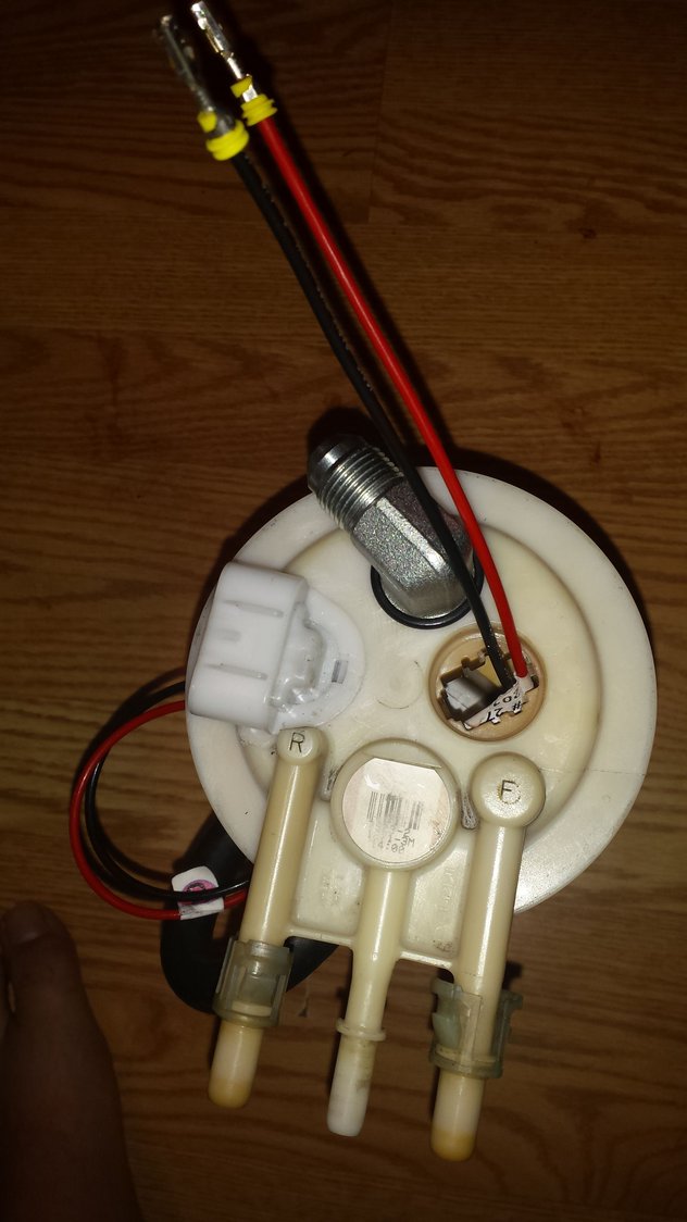

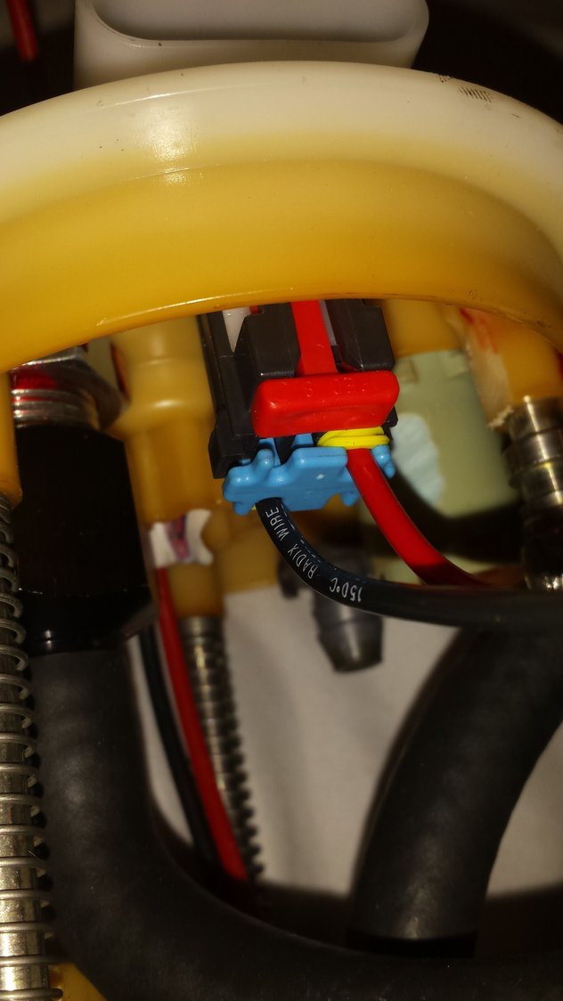

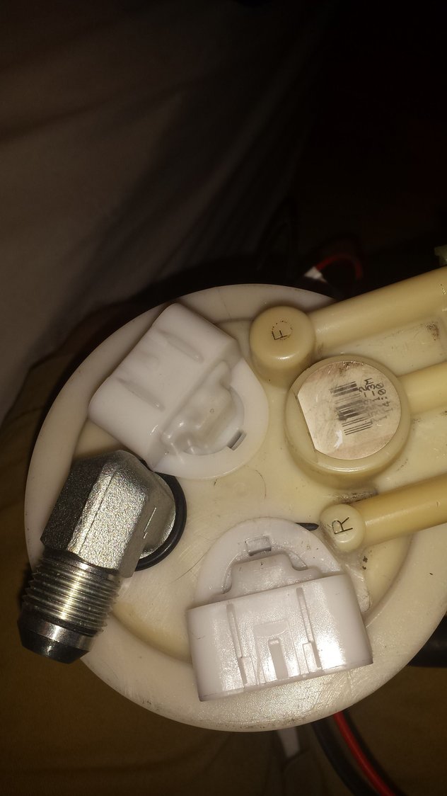

Stock Connector is too small and fragile to handle the pump wires, figured that out as we finished the first pump wiring. -8AN bulkhead fitting, secure with locktite. Will be using return port as an evap sensor port.
Racetronix Bracket came with two holes so we used stainless bolts/nuts and brass washer to secure it
Racetronix RCS-028 bulkhead connector

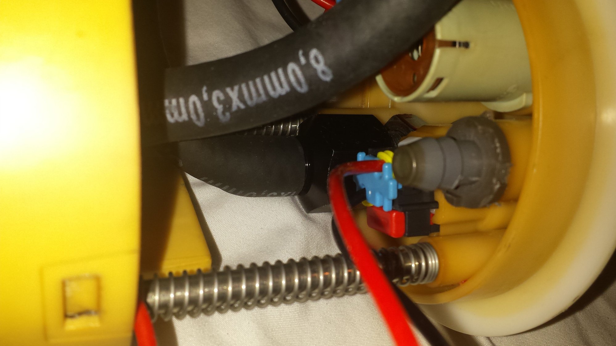

Went from the -8AN Bulkhead fitting to a 3/8s barb, still needing to put a clamp on it. Using the stock feed port as a return line.
No kinking of the hose! ACDelco Submersible Fuel Line Hose, $25 / foot sadly

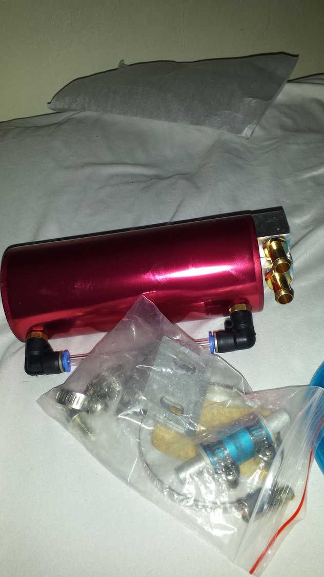

Some goodies for today
Finished up my fuel bucket minus the clamps and indicator, have to crimp those wires again.
Amazon Catch Can, going to see how it runs.

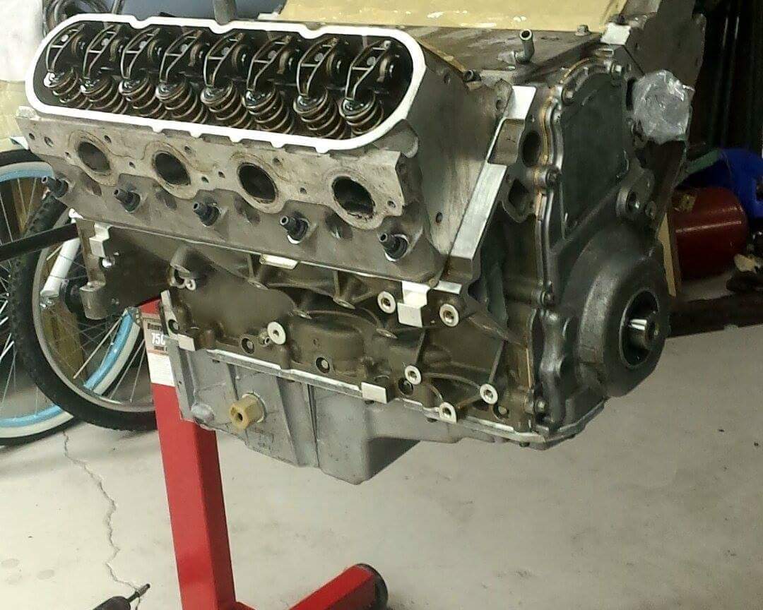

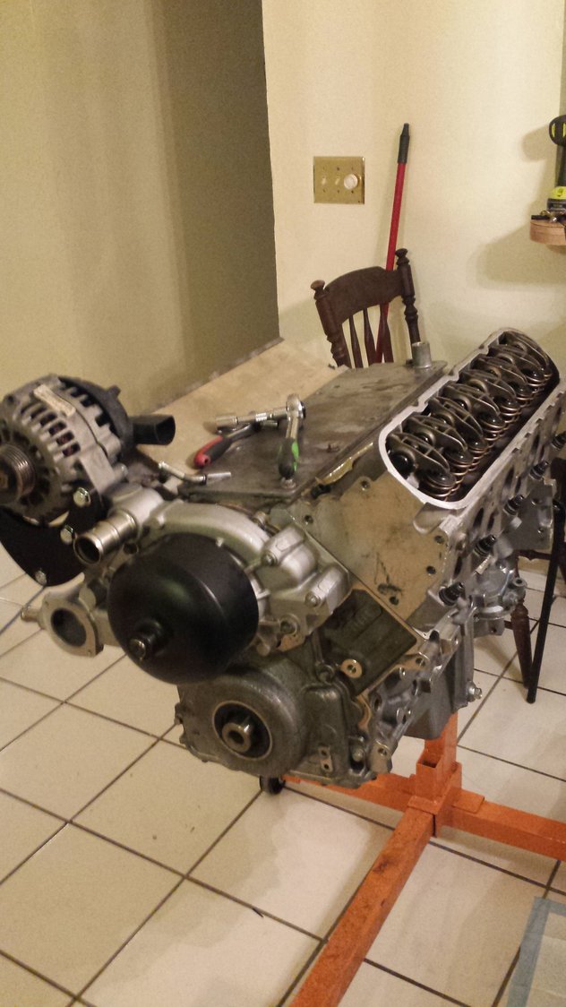

Slowly making some progress. Putting everything on besides intake to drop it in.

Made some further progress today. Was suppose to install the motor/trans yesterday but could not due to a stripped flex plate bolt. Installation will hopefully continue Wednesday.
Wired the gauges today, last one is going to be a fuel pressure one.
Was mocking up the oil drain, still uncomfortable with the way it is but it'll have to work.
