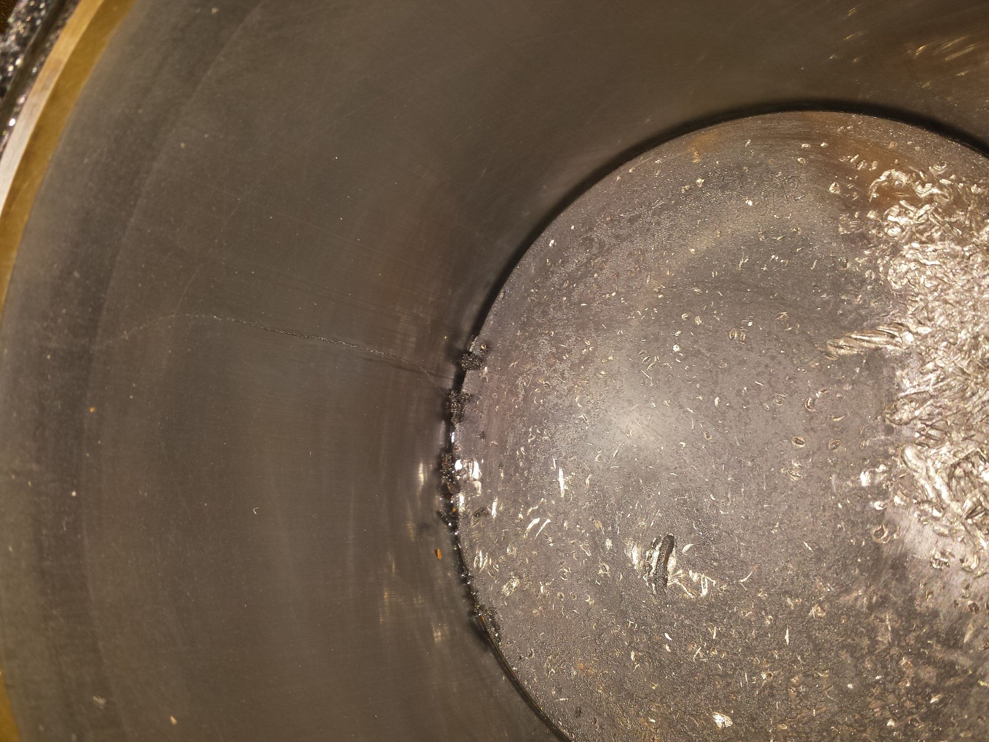

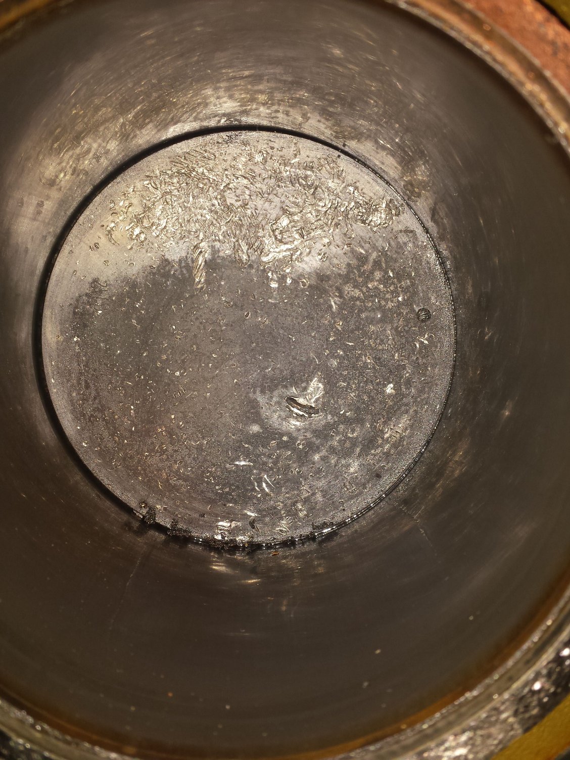

I know it's hard to diagnose over the internet but do you think below is crack or a gouge? Neighbor says a crack, I'm leaning towards that as well...

Defiantly a cracked cylinder. And that piston probably has a pinched ring land besides the obvious damage.

Thanks, that's what I was afraid of.
New sleeve and piston or just junk it? First rodeo tearing into an engine.

crack no doubt

Find a new block...

Tis a sad day, 117,xxx on the clock.

I've got a block that looks just like this, its basically scrap metal now.
