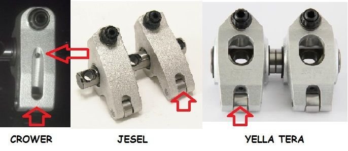

I have a pretty high lift cam (.638) and I wanted something "better". My research led me to Crower rockers. They have material that bridges across above the roller tip, an oil hole that sends oil directly to the pivot point and a slot that gets oil to the roller tip.
Expensive yes but it was slightly less than the Jessel setup. I'm not sure if this is for you but I would consider it the best rocker system for these engines.
