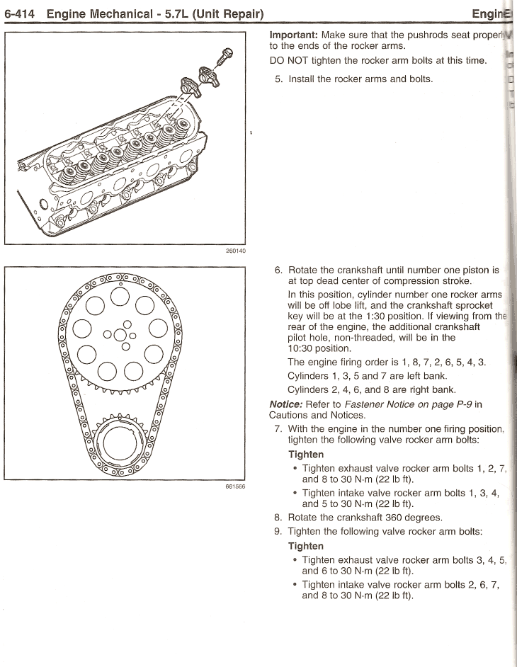

Here is the GM procedure, same for your setup as stated above.

Great, thanks guys!..much appreciated!
