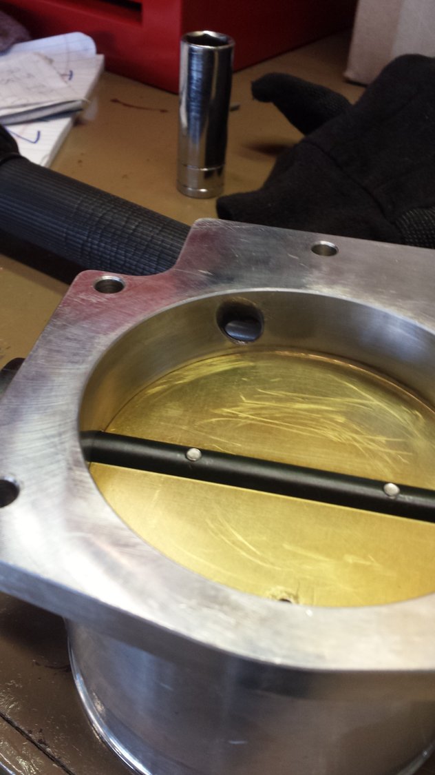

Haven't seen anyone mention this to the OP, but make sure you DO NOT buy a FAST TB. Nick Williams is superior to the FAST.I have a Fast 92 and the tune has never been spot on.
Fast intake causes tune to be off? Which one in particular? I've never came across someone saying that
Fast throttle body, not the intake.

Yep lol any time you make a significant change to the air going in or out of the engine you need a tune. The fast intake will be sucking in so much more air than now it will throw the maf calibration out, also if you get a bigger maf that has to be calibrated to your car as well even if you didnt change the intake. Headers also need a tune due to relocating the o2's and changing the exhaust flow. Long story short do all the mods at once and then get a tune

I wasn't planning on getting tune until everything was ordered. 243 heads, 1 7/8 headers, intake manifold, and ... maybe fast tb? confused on what the problem is with that considering tuning issues?
If you buy a fast tb and have an aftermarket cam you'll find out. Ask the person tuning your car. He should be able to answer that question if he's experienced.

I would recommend this. I'm using a fast 92 TB now and am having nothing but problems. I bored out the iac hols more tonight. Going to start it up no . Wish me luck lol.
