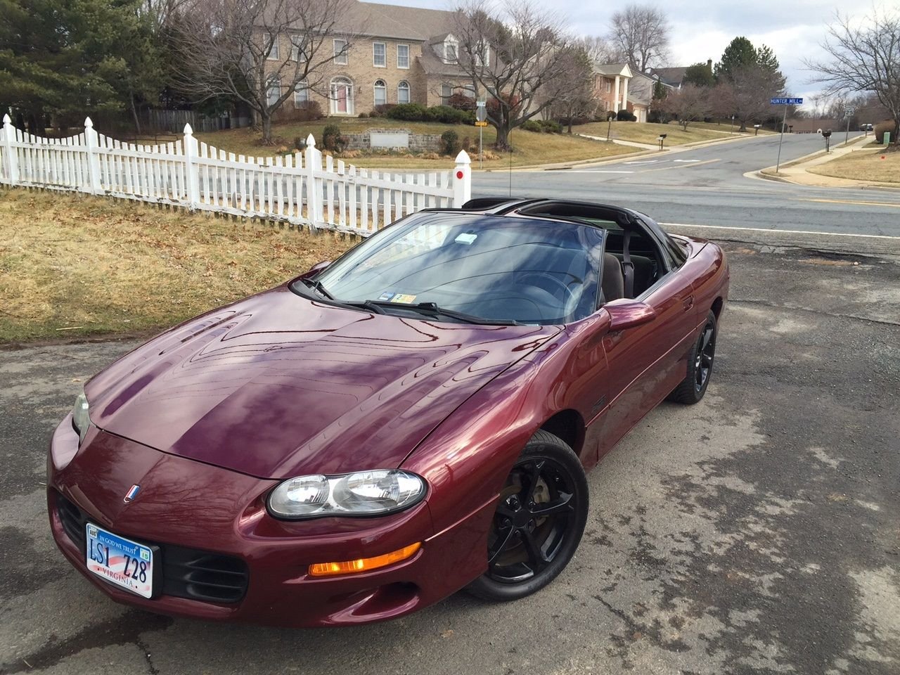

Just found out that as an anniversary gift, work will put $2,500 towards any gift for myself - naturally I want to put it into my car. I'd be willing to an extra $500 or so towards whatever upgrades I do, so let's call it an even $3,000.
So the question is, what are the best modifications for that price range?
Brief overview of the car:
2000 Z28 mostly stock, 80,000 miles, M6. Has SLP airbox, K&N filter and Flowmaster exhaust. It is NOT a drag/track car so maximum power isn't the only important thing. It was my daily driver for 3 years, and now it's mostly a summer car, but I want to keep it usable for the long term and the occasional road trip. Also, located in VA, so long tubes are sadly out of the question (I know some people in VA get away with it, but talking to the local shops, none of them can pass the car with aftermarket/moved cats)
Also, while I'm willing to do a bit of work, to be on the safe side I want to assume the cost includes labor in case I get in over my head.
TL: DR - Have about 3K to put into a mostly stock 2000 Z28. Main goals to make it louder and somewhat faster, but long term drive-ability is important.
