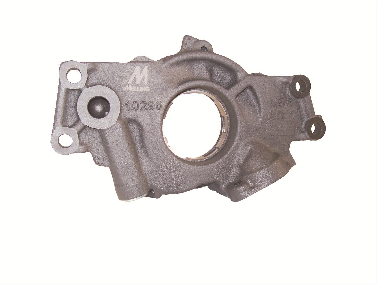

I am currently in the process of top end tear down and i noticed that my melling oil pump has a slight indent from the ls2 chain. I am wondering if anyone else has run into this issue. I do not recall any shims or anything when i installed it last time. I can post some pictures of it later when i get home. Just looking for some advice. Thanks

DO you have the LS2/LS6 chain dampener on?

No, at the time this was done i do not believe the dampener was well known on the forums otherwise i would have done it. But i am pretty sure the dampener is not my problem here. Its almost like the crank sprocket could be sitting out too far, but it is all the way on there.

The newer ones have clearance in that area, so file it:
