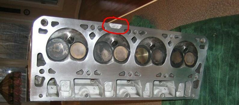

Make sure the heads don't have the notch in them, or you will have to use a graphite gasket.

Can someone post photo of this notch?
