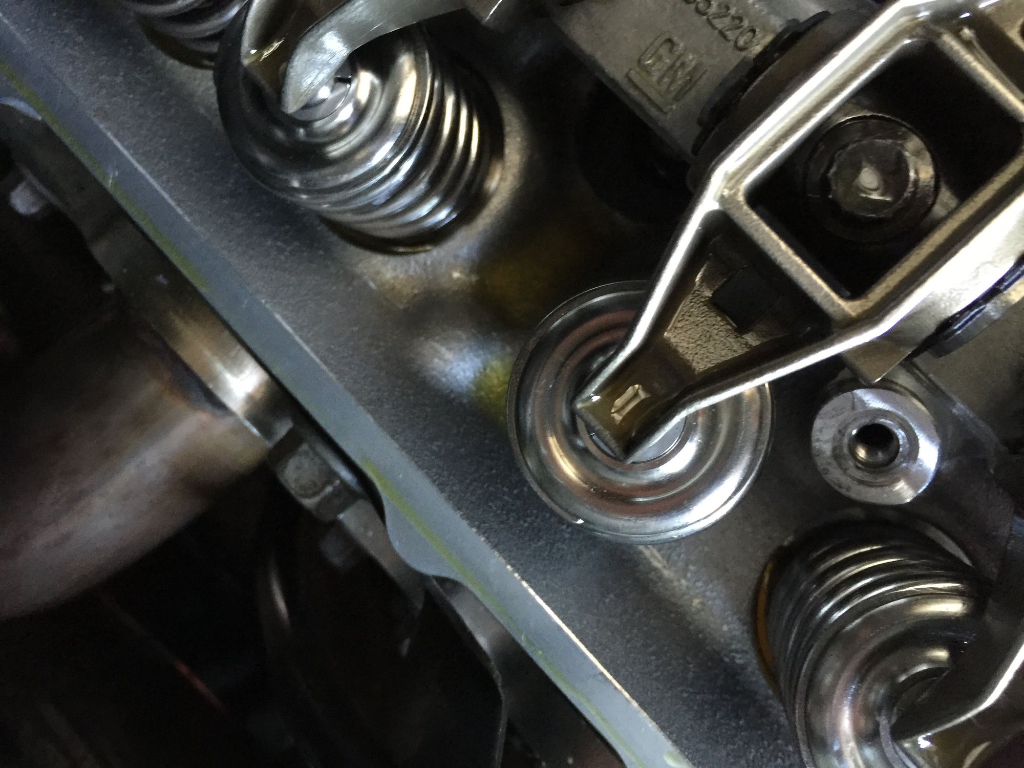

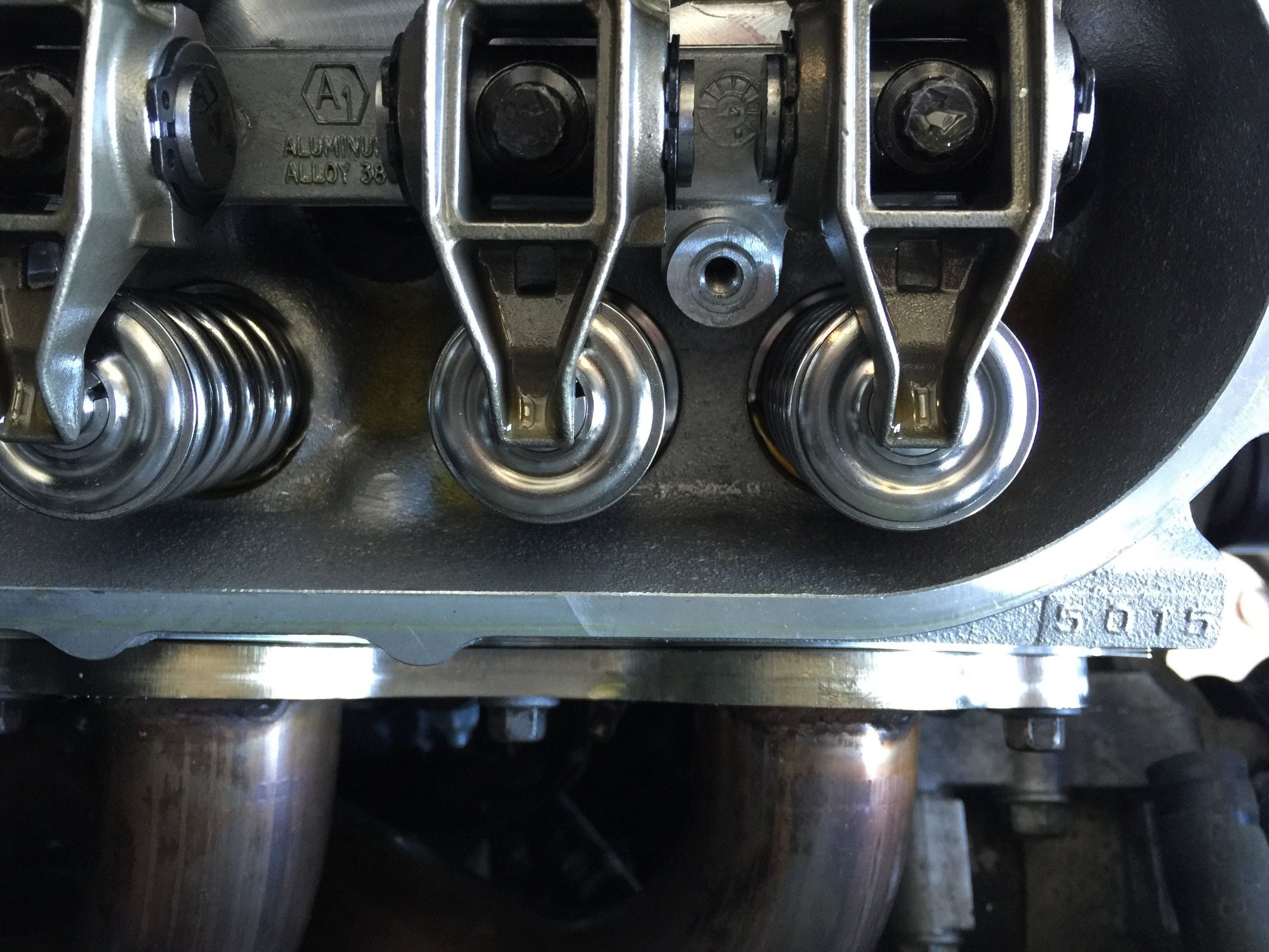

Here's what I have, from the passenger side. Some sit directly square, while others seem to be a bit left of the stem. I feel like the rocker should be square over the stem, no?
I tried holding the rocker tip with my fingers while torquing them, but when you get to 22ft lbs they just go whatever way they want.

In all honesty, on pretty much every set of used rockers Ive seen, the wear pattern has never been perfectly center. I dont really see anything out of ordinary in those pics.
That's reassuring. I guess I'll just run them.
